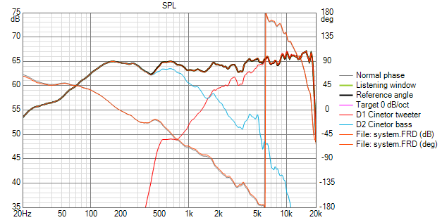

Equal result with equal slopes.

My answer was probably useless as too shady.
Few tips:
* Minimum phase extraction concept sucks so primary do not use it. It is needed if phase response is not included in frd/zma file, but better to just minimize excess phase or excess group delay by adjusting delay offset when phase response is included. No need to guess slope extensions manually or automatically when measured phase is used -> phase slopes do not corrupt due to bad subjective guess.
* Measure full audio band (5Hz-40kHz for VCAD) to avoid response extrapolation.
P.S. VituixCAD detects slopes within 1/3 octs at LF and 1 oct at HF. Detection stays stable and logical by using quite wide detection range. MP extraction is never accurate fact and very aggressive detection with narrow band does not necessarily help.
Few tips:

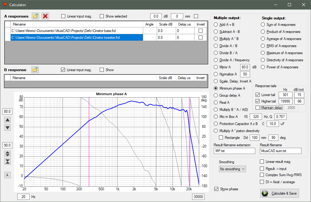

I get them to match if I have woofer delay set to zero in VCAD, while in XSim it's set to 1.4 inches. Really weird? :scratch2:
My simplistic but good enough for me measurement approach is:
- Gated measurements of tweeter and woofer at listening height
- Measuring both drivers wired in parallel
- Wire drivers in parallel in XSim, import parallel overlay and adjust woofer delay until the responses match up
I can't use measured phase since I'm using REW with a USB mic, so minimum phase it is.
Really weird?
As explained before, slope detection in VCAD uses 1 oct. band at HF. Result is about -9.5 dB/oct. with your tweeter and measurement range. I guess that you entered manually about -100 dB/oct to XSim. Difference is significant at XO range but one thing is sure: both are inaccurate because facts are not known.
Why you ask anything if you really know what is good enough? Then you should be able to evaluate accuracy of different options.
Of course you can. USB mics are able to measure phase. Problem is that (usually) they are not able to measure timing differences between different drivers and off-axis angles without acoustical reference. Measurement programs adjust (=normalize) timing by shifting impulse peak to or close to 0 ms point with some logic.
MP function with manual slopes is also available in Calculator if automatic slope detection is not good enough or user wants to compare results.
But the issue here isn't slopes. I can play around with different slopes/tails, and it has minimal effect on the large 3-4 KHz dip.
VCAD and XSim matches up if Z=0 in VCAD and Z=1.4 inches in XSim. And that is what makes no sense to me.
No. It's already visualized few messages earlier that programs give very close to equal result if you convert responses to minimum phase with the same tail settings. There's just tiny (~10 us) difference in group delay of tweeter causing ~1 dB difference in total SPL at 4-6 kHz.
Note that you have to use Calculator tool in order to imitate mp conversion of XSim.
