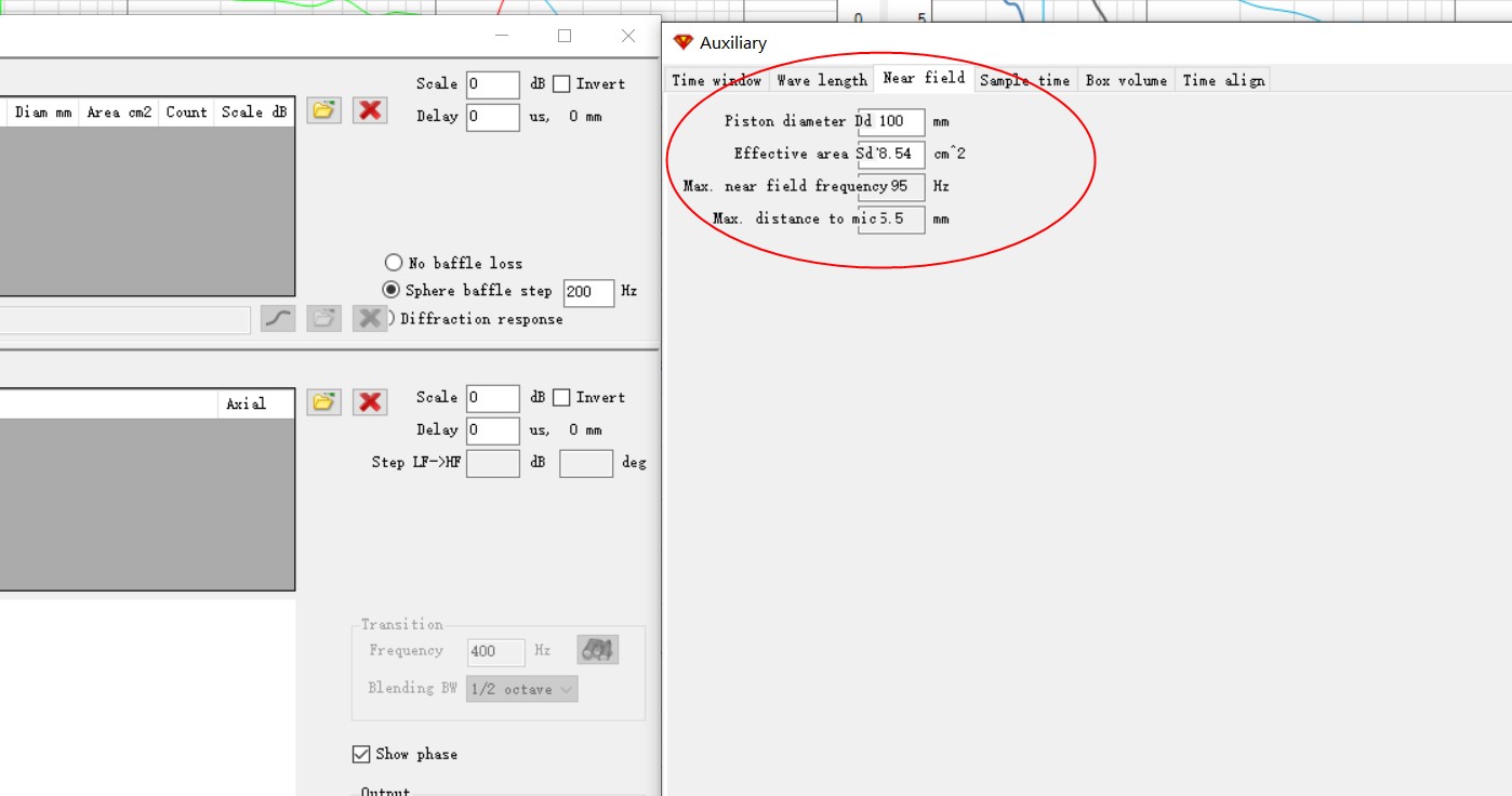

In my use, many pages have this kind of overlap problem, they have been updated to the latest version, the problem is the same, please help me to check whether the setting is wrong, thank you
Thanks again for providing such a powerful software
