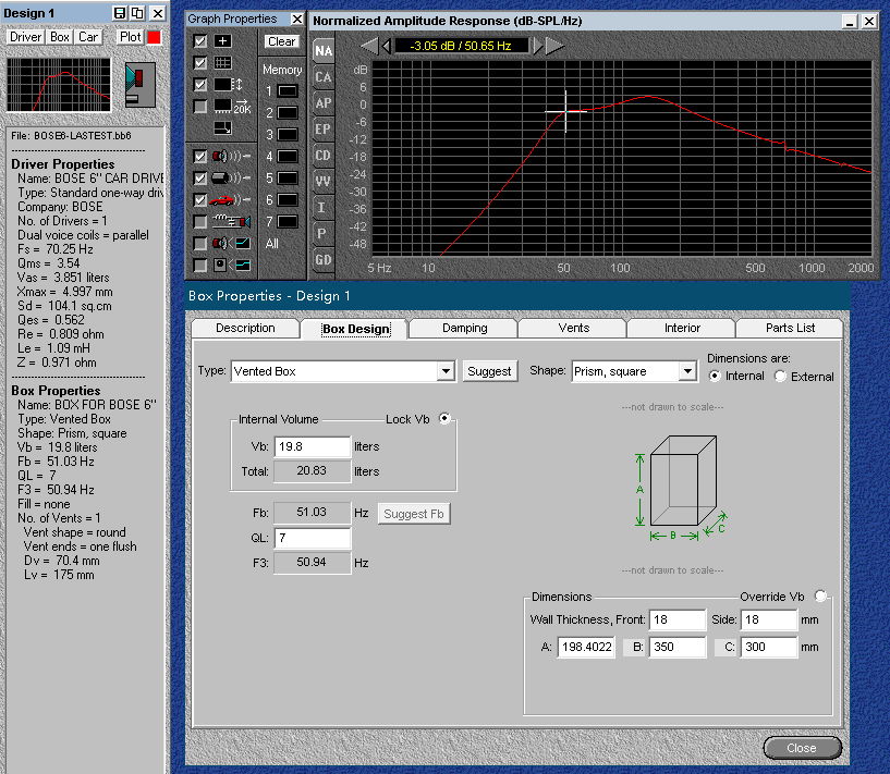

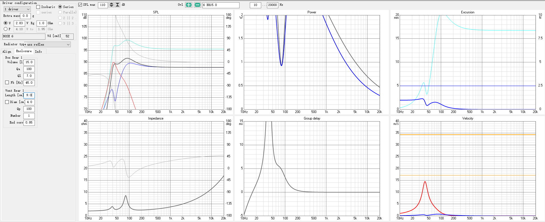

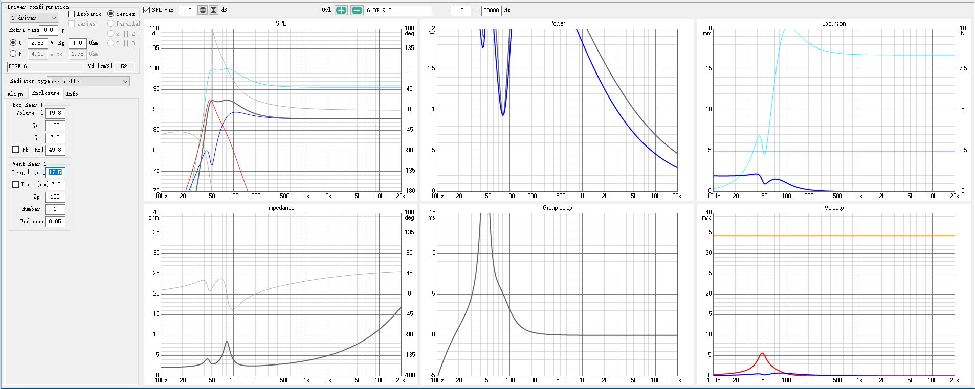

Also, Rg is too high at 1 ohm, it should be the resistance of inductor in the crossover, if used - so Rg should be about 0.5 ohm, or 0.1 ohm if there is no passive crossover.
Thank you for your suggestions.
What do you mean when you say Rg value, I can't find it in the parameters.

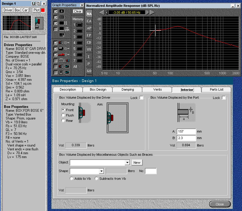

So, you must put two woofers (serially connected) in your 28 litres box, with 7 cm tube 10.5 cm long.
My friend have only this one second speaker, no more, so I have no choice.
I just modified the parameters of the enclosure and new simulation is attached.
Does it looks better?

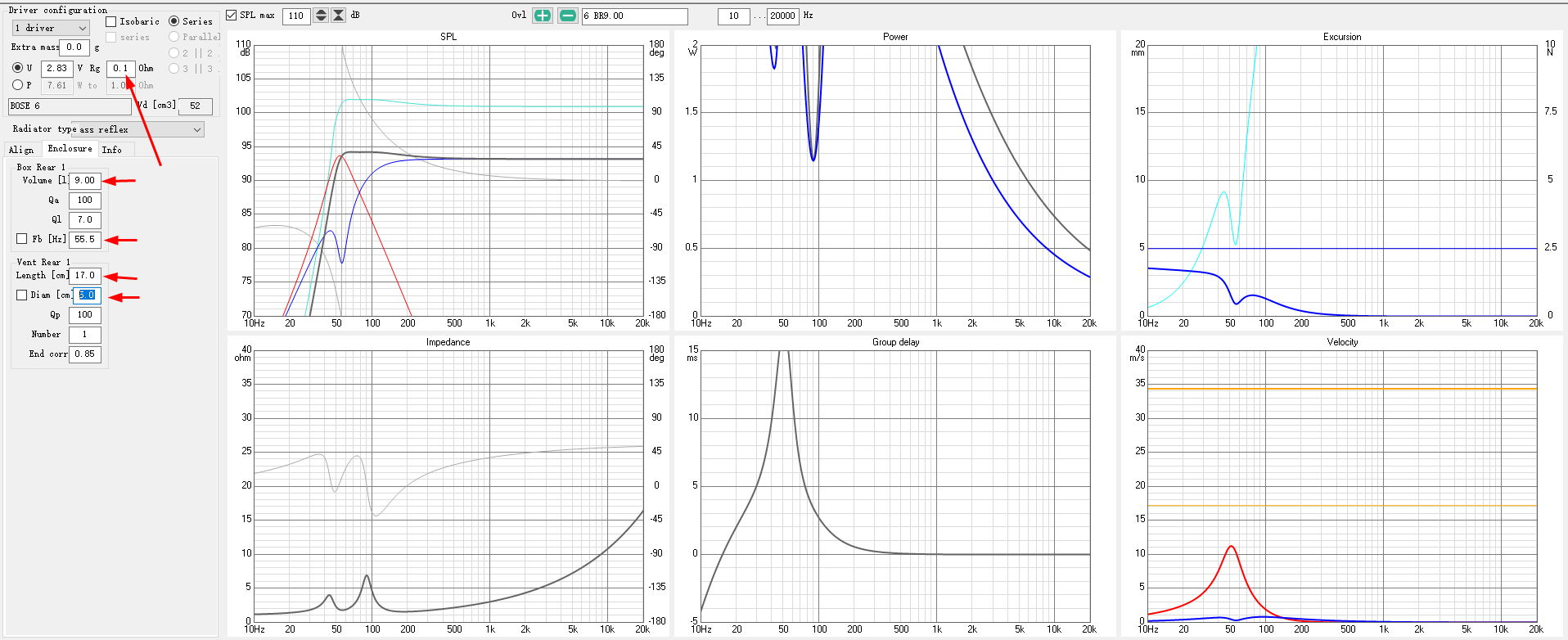

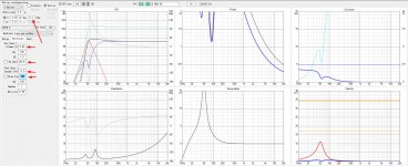

Rg is not a Thiele-Small parameter, it is internal resistance of the amplifier (or inductor resistance, if there is a passive crossover). It is located on the top left side, below "extra mass 0.0 g" and just right of "U" button 2.83V. It should be 0.1 ohm, not 1 ohm.
With Vb=19.8 litres volume it does look better, but Vb is still too big. For good low bass extension and acceptable sound quality box volume Vb should be 13 or 14 litres (and Fb=50Hz), but for maximum sound quality you have to choose Vb=9 litres (and Fb=55Hz) - just as @Sergey76 pointed out.
For 9 litres box and Fb=55Hz, use tube with inner diameter D=5cm and length L=17.4 cm. Those 9 litres is net volume, you must add volume of the tube and woofer back volume. Let say box gross internal volume should be 10 litres.
Thank you Sonce, I found it.
I almost ignore this value when I'm tuning the simulation, maybe its value (1.0) was input by me wrongly, and after I saved this project, the value was kept every time I modified the project.
I modified the Rg back to the right value (0.1 Ohm), I simulated the box again follow the ecommended values for the box and the vent.
The new result looks wonderful.:yes: I also know how to upload and show the picture in this thread.😎

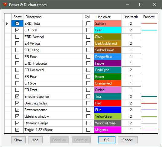

I'd like to ask for a small feature (I assume it is small work but don't know of course). Namely it would be nice to have an "Apply" button in the SPL traces window in addition to OK/Cancel. I'm finding myself sometimes going through the opening of that window many times if I'm hunting for better colors or trace width etc. That would allow seeing the effect without closing the dialog.

I assume it is small work but don't know of course.
In this case I tried tree different versions how to refresh chart from traces window. Main program and enclosure tool have automatic/dynamic traces which require network parsing and calculation - not just drawing of chart.
Programming puzzles are not necessarily difficult to do, but finding the best solution and studying how program is done require extra work.
Sometimes I have planned to set price for new features. It would be kinda expected total of donations triggered by new feature. "Cost" of some features would be quite significant. For example svg export 700...1000 € with net salary. Here the gratitude was single thanks with exclamation mark, and probably no one uses the feature. Interesting programming challenge though.
