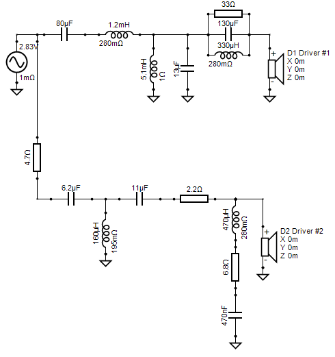

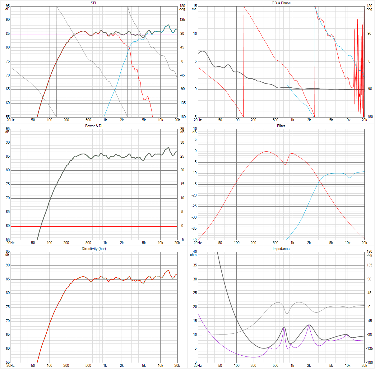

An the last iteration above I notice a bit of a knee in both the hi-pass and filter-tweeter combi at around 1.5kHz. Just around the same frequency the Power Response seems to peak a tiny bit.
Would It help to aim for a small dip on axis @1.5 kHz in the combined response by applying a somewhat more gentle roll off in the hi pass filter? It would be interesting to see how that impacts the smoothness of the DI and Power Response.
Is this the sort of response you were describing to get a smooth power response, where one of the drivers is out of phase at the XO?
No. Phase match above XO frequency to drop power where tweeter has too wide radiation. Phase mismatch below XO frequency to increase power where cone has too narrow radiation.
But as mentioned and visualized earlier, when enclosure shape and c-c are okay, there could be phase match below and above XO frequency.
So far I dont have turn table, this is simulation with measured on axis response
and measured impedance.
I have C-C 146mm, XO 2720Hz, bafle angled back 14 degrees.
1.1" ring radiator and 7" midbas.
I think that phase belove and above XO is what Kimmo talking about.
Hope that I will be able to get off-axis in future, to check whats happen with power and DI.

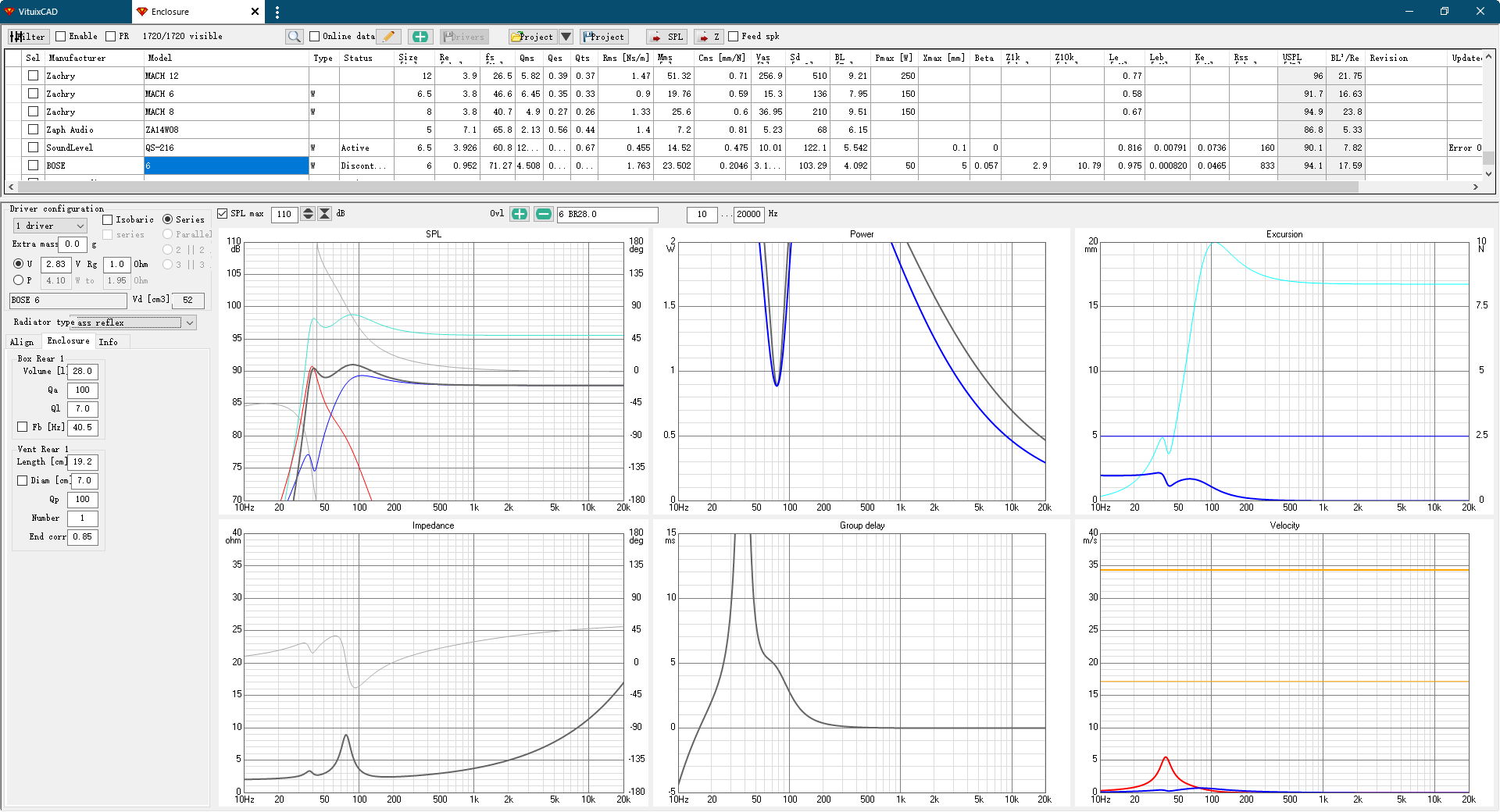

I'm making a vented box for a BOSE speaker. I use VituixCAD to simulate the box like the pic below, the thick value of front board is 1.8cm, the length of the vent is 21cm in VituixCAD2, how long should I cut the tube {(21cm+ 1.8cm)=22.8cm} vent?
Cause in VituiCAD2 help file ,no difinition about vent length, is it the inter length of the vent inside the box?
and the Diameter of the vent is 7.5CM in VituixCAD simulation, is it also the inner diameter of the tube? because I bought a tube which outer diameter is 7.5CM, and the inner diameter is 7.04CM, does this difference matter?
Valid is only the inner diameter of the tube! So you must enter 7.04 cm diameter in the VituixCAD, and than the tube length surely will be shorter than computed for 7.5 cm diameter - say 20 cm (for example) instead of 21 cm.
Length of the tube in VituixCAD is total length (say 20 cm), including board thicknes (18.2 tube + 1.8 board = 20 cm total), if you are gluing tube from inside of the box - that requires hole of 7 cm in the board.
If you drill 7.5 cm hole in the board, than you can tightly fit tube inside hole, and than the tube length should be 20 cm.

Actually, I've made the box according to your explanation, but it sounds not good, something wrong.
Could you help me to check the picture of BOX simulation in VituixCAD2, I cannot find out what 's wrong.

You hurried it, first comes simulation and validation, than box building.
Of course it sounds bad! Box volume Vb is too big, it should be only 13 or 14 litres (for one woofer), and tuning frequency Fb should be 50 Hz. Also, Rg is too high at 1 ohm, it should be the resistance of inductor in the crossover, if used - so Rg should be about 0.5 ohm, or 0.1 ohm if there is no passive crossover.
So, you must put two woofers (serially connected) in your 28 litres box, with 7 cm tube 10.5 cm long.
