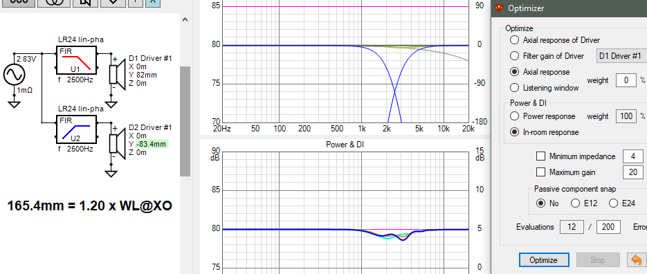

* Added optimizing of predicted in-room response
Predicted in-room includes early reflections (44%) in addition to listening window (12%) and sound power (44%). Partial ER could be useful if some bad features of ER are not clearly visible in power response.
For example simulation which might explain my sleeve constant c-c = 1.2 x wave length @XO. Rule of thumb would be c-c = 1.08 x wave length @XO when optimized by power response only. Radiators are omni-polar in both cases so sleeve constant is quit much simplified.
