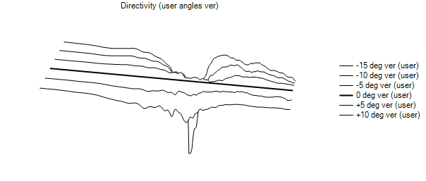

Something else: I want to be able to compare the directivity graph style "Surface chart" to the ones that JA from stereophile does with MLSSA in his reviews. Just to compare projected performance in this style of representation.
Would you know how this can be done? JA uses 25 dB SPL of vertical and +-90 degree of lateral information and nomalizes for on-axis. In VCD I can set the scale to 25 dB and normalize, but it looks very different to MLSSAs charts because the vertical scale is much more extended. any solution or workaround?

Hello Kimmo,^The latest build (2.0.72.2) can do this though I don't see much sense to use Stereophile's directivity measurements as a reference.

1) Stereophile's graphs provide a huge set of comparable directivity performance for many different speakers, making it easier to compare one's own design, given the representations are comparable. I find it easier if I see the same representation and shortcut the mental translation step.
2) I find these MLSSA charts quite intuitive, regardless of the fact if I would agree on the usability of the chosen limits. They are easier to follow than line charts or sonograms and to identify weaknesses, because the deviation is shown in third dimension. It would even be better if further scaling/a scale/a grid was visualy available, but that is too much to ask for.

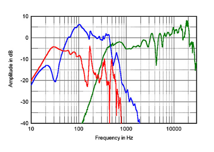

tip: measure port response at some point of the design process! Mids leaking through the port can be bad enough to ruin the speaker.
See attached measurement, found on Volti Audio Rival loudspeaker Measurements | Stereophile.com . The red response is from the port. Standing wave in the enclosure at ~160Hz comes through as loud as the Helmholtz resonance, couldn't be worse. I wonder if this was someones first speaker and didn't see the resonance, or forgot to do measurements.. 😀

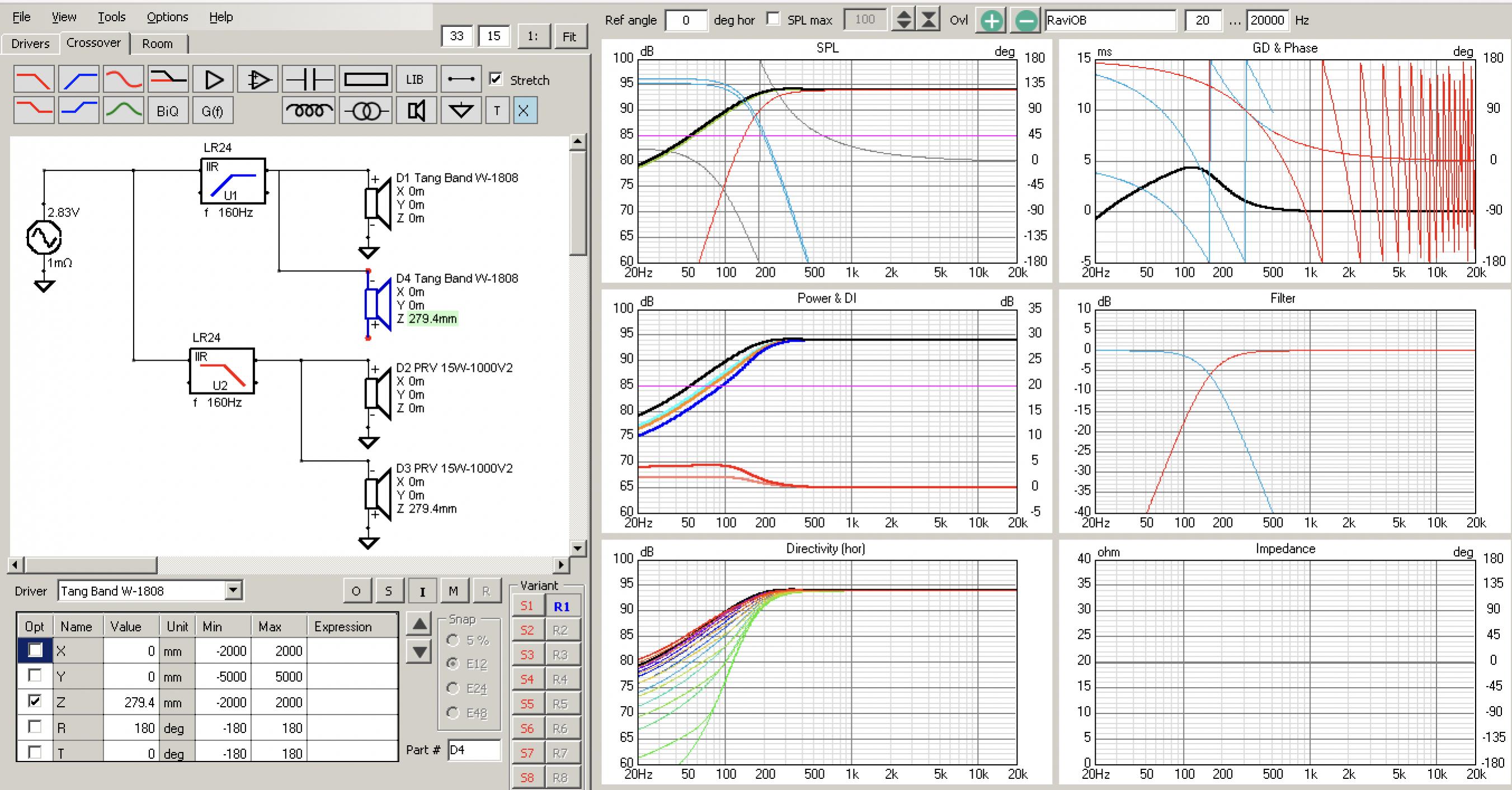

I've been using Basta so far and a friend suggested to try VituixCAD. I assume its possible but I couldn't find a way to model an Open Baffle enclosure. I can see an Open Baffle option under Diffraction but not under Enclosure. I'd appreciate if someone can provide the exact steps. As a simple example what would be the steps to model a FAST with a full range and a woofer on a flat baffle of say 60"x24"?

I thought since the Enclosure doesn't have Open Baffle option I have to skip it. Also, seemed like Crossover was the only place to specify a dipole. So here is what I have so far.
I haven't put in the X and Y as yet. If I understand it correctly, 0,0 would be on-axis with the listening position. Looking at the driver -ve X would mean to the left, +ve to right, -ve Y would be down and +ve is up?
Also how do I now enter stuff into the Enclosure? I'm finding the manual a bit difficult to follow.

you are missing a ground return on the back side driver model

Cabinet models don't include baffle effects, they are nearfield simulations. With that in mind, there is not a difference as far as driver excursion is concerned, both situations there is nothing "pushing back" against the driver, it operates in free air. The enclosure response will reflect what you would measure as a near field response. You can export the enclosure response and bring it into the diffraction simulator to include the baffle effects. This sort of simulation is not good enough for filter design however, only good for insight into the low frequency operation of the driver on the baffle. You can also go the other way around, simulate the diffraction response and bring it into the enclosure model, you will see the option under the "align" tab in the enclosure model.
Recommended process is to design with real measurements. Process for measuring open baffle speaker is not different than any other. Follow the guide for measurement process with ARTA or REW.
