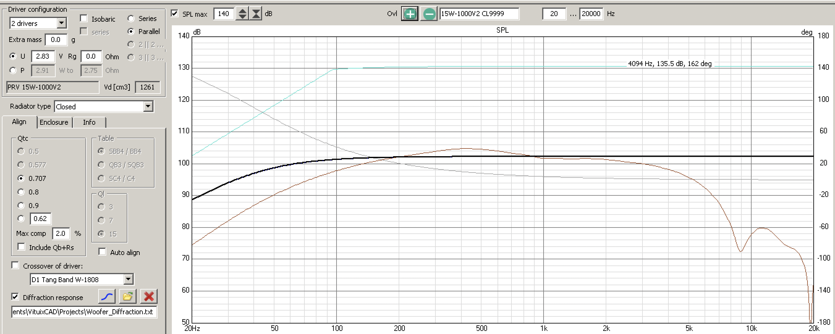

Values for Qa and Ql seem to be immaterial once a large volume (9999) litres is chosen.

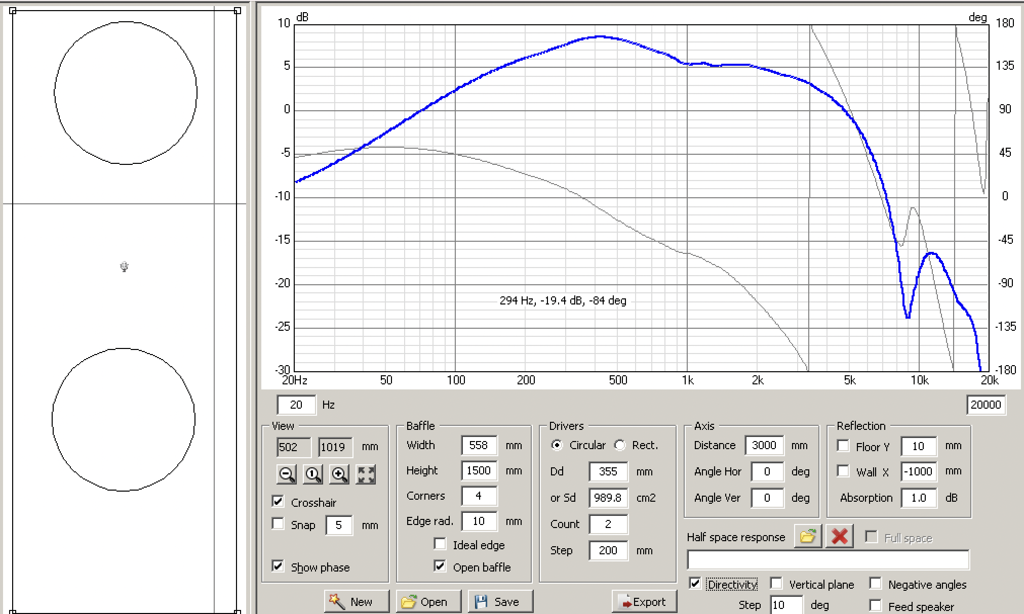

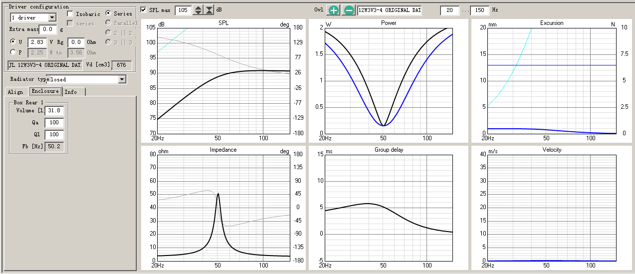

I've attached the diffraction and the enclosure screens. Do they look ok? I guess Qtc of 0.707 is ok?
The crossover dropdown lists each driver twice (one for front and rear of each dipole). Which crossover would one pick on the enclosure screen?
Still a lot of learn - what does half space export? should I include directivity? etc. will go through the manual.

That's right, Qa and Ql are irrelevant when there is no box to load the driver. Are you going to stuff your entire room with insulation? ;)
Qtc "alignment" parameters also irrelevant when you manually enter the enclosure size. Clicking on Qtc of 0.707 will adjust your closed box size accordingly which you won't want.
Half space response on the diffraction tab doesn't export anything, the button is for loading your driver 2pi response such as near field measurement to have diffraction applied to it.
Crossover function for enclosure selection is geared towards active filtering of subwoofers, to include the filter response in the result. There is not much to be gained here for your open baffle full range driver project.

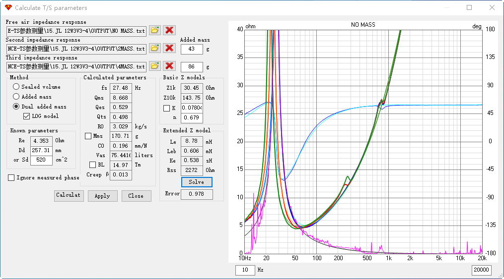

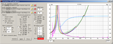

Hello Kimmosto,

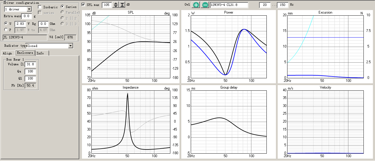

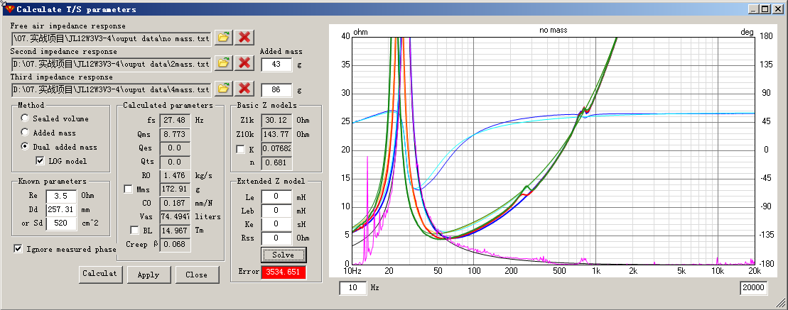

I measured JL 12W3V3-4 using REW, the result looks good in REW, but when I exported data from REW and import to VituixCAD to calculate the T/S parameters, there was big error like this.
In REW the result is good, BL is very flat, and John also thinks it looks good.
I'm using the lastest version of VituixCAD which was update today.
^Screenshots don't help. You must attach or send all three impedance response files to play with.
I can see from magenta curve that quality of measurements is not good enough and error in solving is not big surprise. Usually clicking 'LOG model' or 'Ignore measured phase' or swapping 'Added mass' and 'Dual added mass' helps solver to find some decent result.

Sorry,I forgot to upload the files. View attachment NO MASS.txt View attachment 2MASS.txt View attachment 4MASS.txt
I tried , but I could not solve the error.
But if I input the T/S parameters generated by REW, it can be used in VituixCAD.
I know I still can optimize the measurement by using new mass values.

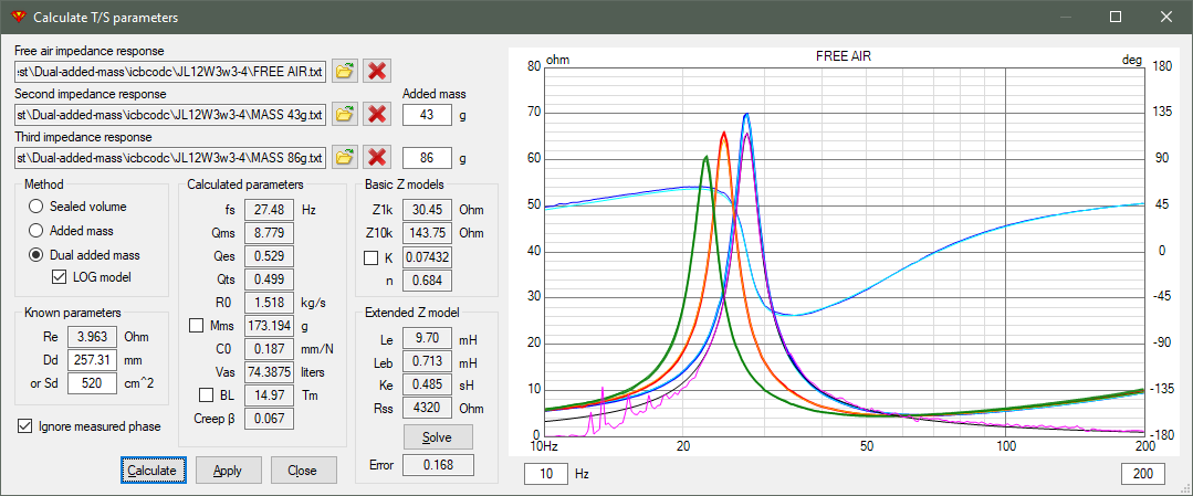

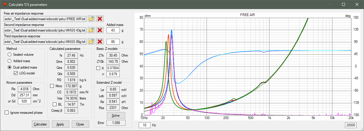

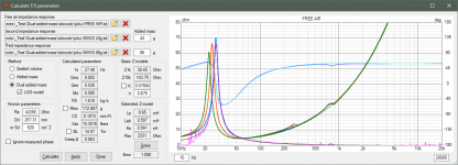

^Download and install the latest build manually. It should be able to calculate extended Z model parameters without entering initial values manually.
Set frequency maximum of chart to 200-400 Hz, and impedance maximum to 80 ohm that you could see peaks of all three Z response groups. That helps comparing simulated and measured responses, and shows when creep beta of LOG model is really okay.
The smallest error without phase response iteration is about 0.168. See attached image. Click Calculate to repeat solving if error is not okay.
Normally measuring of T/S parameters is not needed if manufacturer has published datasheet. Parameters of your driver are also available.
Purpose of whole Enclosure tool is not to make accurate science with dual added mass method and fancy creep modes. Just help product selection and calculate few simple enclosure parameters such as volume and ports or type, added mass and count of passive radiators.

What are the benefits of the dual added mass?
* BL is a bit more accurate.
* No need to measure Re.
Difference to single added mass is usually insignificant so dual mass is not so important for diyers and box designing IMO. Knowing accurate BL and Mms would be more important for driver manufacturers assuming that individual test samples represent whole production. Unfortunately that is not common.
Knudsen LOG model and others including suspension creep is not the same as simulation with standard T/S parameters having constant Cms and Rms. Simulation with suspension creep needs simulator supporting creep parameters - R0, C0 and Creep Beta in this case. In practice it's not easy to use parameters calculated with 'LOG model' checked outside VituixCAD Enclosure.
