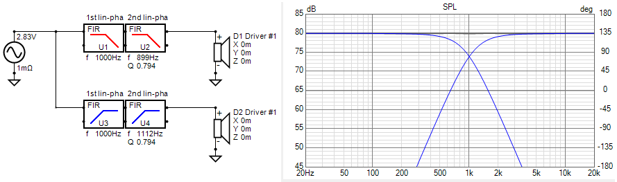

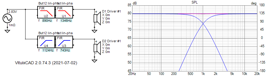

Quasi-linkwitz 3rd order
Peter Comeau said "The acoustic crossover slope that I’ve found successful, time and time again, is what I like to call a 3rd order Linkwitz characteristic. In theory there is no such thing, the Linkwitz-Riley topology pertaining to even order filters only, but the characteristics of a Linkwitz filter, namely a -6dB crossover point and ‘perfect’ phase integration between the low and high pass sections."
Is there a way to use that as a target function in Vituixcad?
Thanks, Paul
2.0.74.3 (2021-06-27)
Optimizer
* Added quasi 3rd order Linkwitz-Riley HP/LP target slopes.
LP slope is product of 1st order @fc and 2nd order with fc x 0.899, Q=0.874. This produces very flat magnitude sum with perfect phase match e.g. as linear phase.
Phase response of target slope is 3rd order IIR so there will not be ideal phase match between ways if driver responses are ideal with the same acoustical timing.

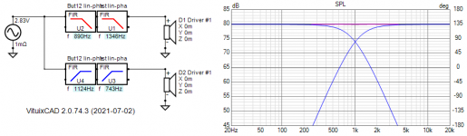

Quasi/odd order Linkwitz-Riley targets finalized.
2.0.74.4 (2021-07-04)
Optimizer
* Added quasi 5th and 7th order Linkwitz-Riley HP/LP target slopes.
This has generated questions also to my e-mail so few comments:
Basic idea is of quasi/odd order Linkwitz-Riley target slopes is to offer useful targets for phase matched odd order filters. In practice those three could be more valuable than any Butterworth or Bessel targets because phase matching at XO range is much more common than phase mismatch of 90 degrees or so. Phase match with odd order is not that difficult in practice also with IIR filters because acoustical centers of different drivers are usually not at the same distance from listening point. For example when acoustical center of woofer is further than tweeter's, delay of woofer could match phase at XO range so that acoustical LR3, LR5 or LR7 could produce close to flat magnitude sum towards listening point.
