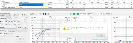

why is your sofware need Qts run 0.2 - 0.7
See Loudspeaker Design Cookbook by Vance Dickason, 7th edition, pages 64-67. Alignment tables end to Qts=0.70. Nothing above that.

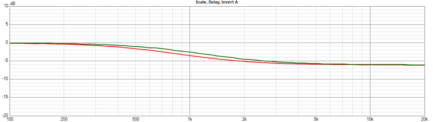

I have a question about the 1st order shelving parameters.
When only a single frequency is used, this is usually take from the -3dB point.
So with a simple -6dB shelving filter, with frequency of 1200Hz, this should be at -3dB.
However, I think there is a little mistake, it's now at -4dB (or 2dB less relative to the -6dB line).
The -3dB point seems to be at 850Hz.
I have checked some other software, and I had no issues with this.
Attached is a graph as a comparison between the two.
Red is VituixCAD
(I had to trace them to put them in the same graph, so there are some tiny little tracing artifacts, but that is not important)
I think this is a visual thing or something?
I also simulated a shelving analog filter, with the opamp block.
Which should give a -3dB of 1200Hz, but in the graph it doesn't?

I dove a little deeper, that is a little awkward.
Simulated the circuit in LTSPice as well, same thing, so the other program does something weird.
However, what does the 1200Hz in VituixCAD represent actually?
Because it is not the mid-way frequency nor the -3dB frequency?

Joined 2003
The only insight I can provide is that the manual says..."Frequency parameter of Shelving LP/HP filter is dBgain/2."

I know, but other programs don't or have such a weird output file, that tracing is quicker 🙂
But anyway. It is working now.
It is equal to Linkwitz' formula for f2
The other programs still uses a wrong definition (which is awkward)
DSP manufacturer decides transfer functions so this has nothing to do with VCAD vs. "the others". For example Behringer, FourAudio and Nova use "analog equivalent" transfer functions for shelving filters i.e. -3 dB at nominal frequency when gain is very high. Hypex, miniDSP, RAM Audio and Xilica use "digital/RBJ equavalent" transfer functions where nominal frequency is always at dBgain / 2.
Also transfer function of Bessel HL/LP and Peak/notch filter depend on DSP selection. Difference between analog and digital equivalents is radical so DSP selection must be correct to get correct response.
