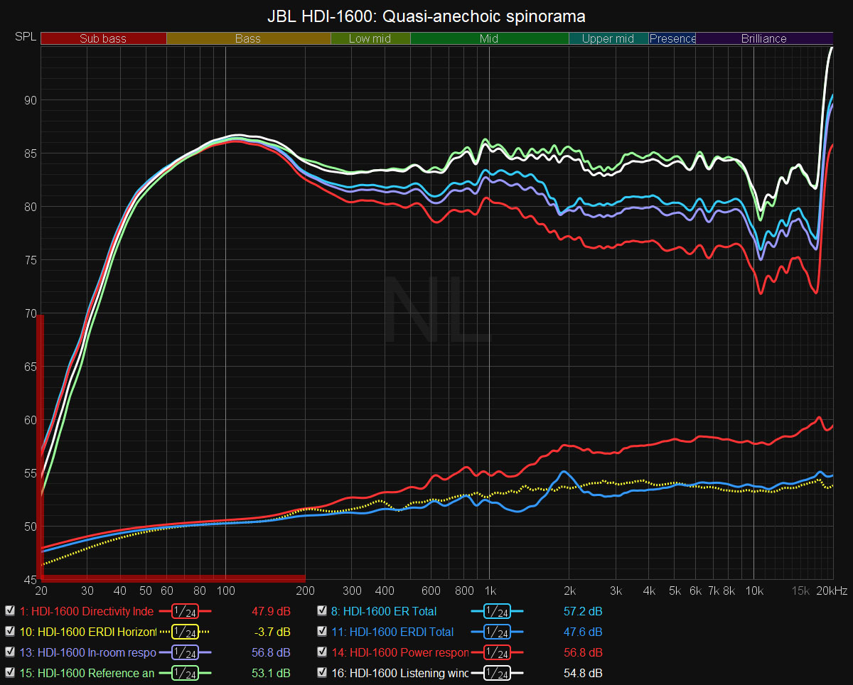

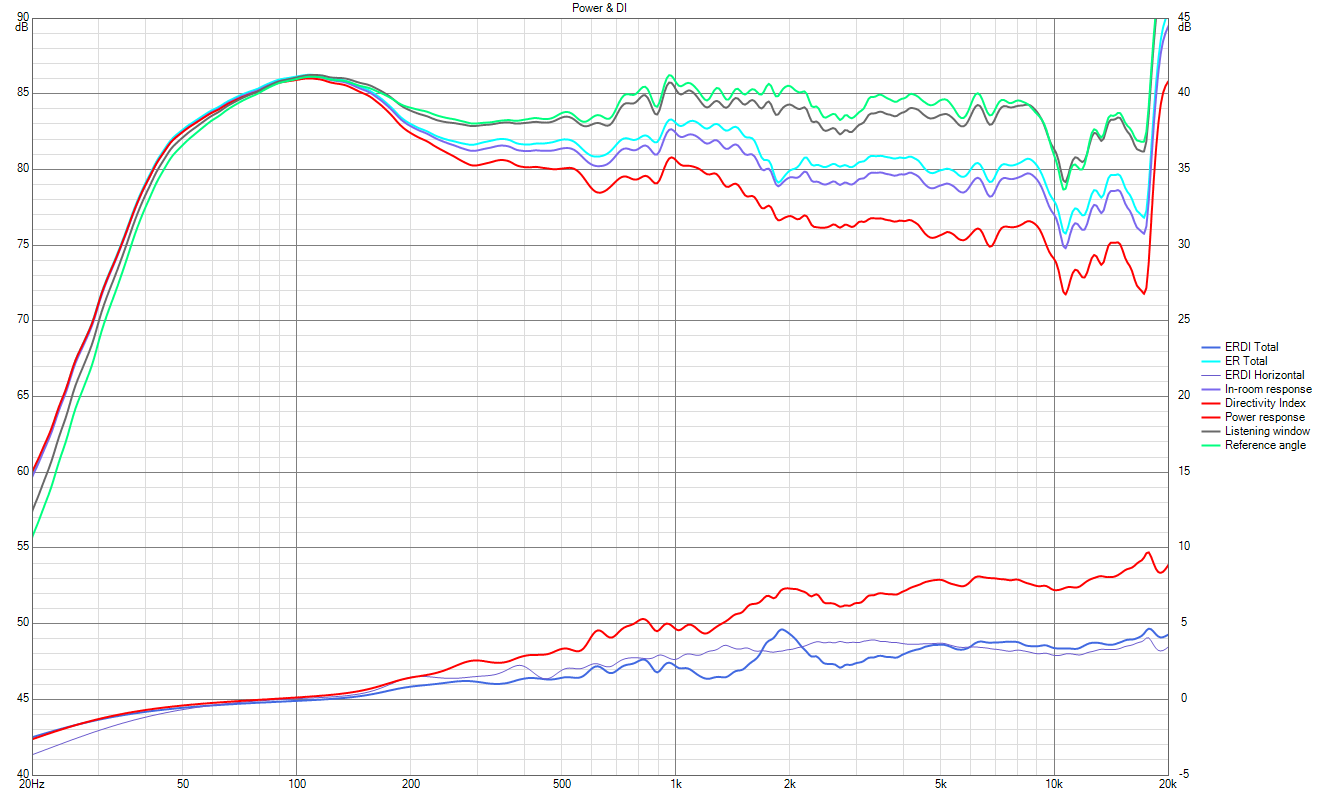

One issue I've noticed is with scaling of frequency response graphs. The CTA-2034A standard is 25 dB/decade (the actual document says 50dB/decade lol but it's a typo because the images are clearly 25/dB lol).
But with 25 dB/decade set in VCAD, the aspect ratio does not look correct. I've attached an image comparing the 25dB/decade setting in VCAD vs REW to show what I mean.
The red line represents the length of one decade. In VCAD it ends up being more like 29 dB/decade, and therefore much 'shorter' than in REW. The latter matches other sources with 25/dB decade measurements.
Changing the decade setting in 'Options' seems to change the whitespace around the image, but not the aspect ratio of the graph itself.
Thanks!

dB/decade setting is just temporary helper function for calculation of image size by frequency limits and SPL span. It is not continuous function so setting gives correct aspect ratio as long as you copy or export chart image with the same frequency limits and SPL span settings accepted in Options window.
For example 25 dB/dec
Thank you, I made sure all the settings were the same, but then I actually noticed what the issue was.
If I right-click on the image in the default 6-pack view, and export from there, the aspect ratio is correct. However if I double click on the image for the 'enlarged' preview, and then right-click to export, the aspect ratio is incorrect 🙂 Problem solved for me.
Sorry but I cannot repeat here on Windows 10. Aspect ratio stays correct in copied and exported image (via context menu) no matter is chart zoomed or not, or main window size adjusted or not - before or after zooming. Win 7 may have some differences also in this.
Strange! I just tried it again with a different project file and was able to replicate the issue once more. I am also on windows 10, on a Surface Book 3. I'll see if it happens on my other laptop tomorrow.
