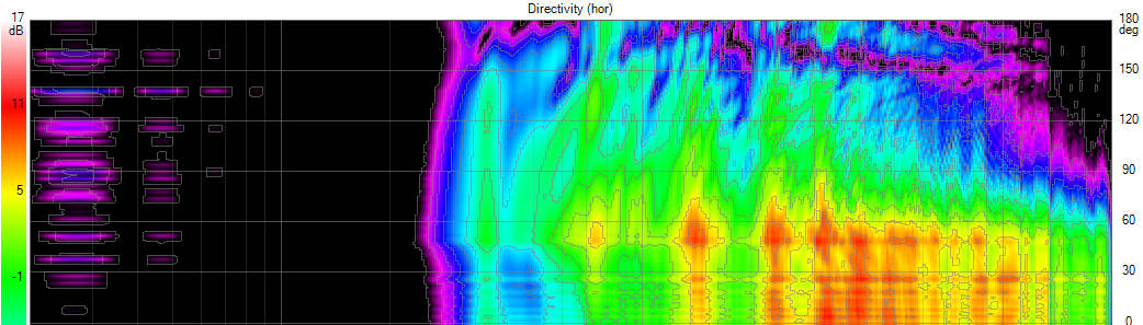

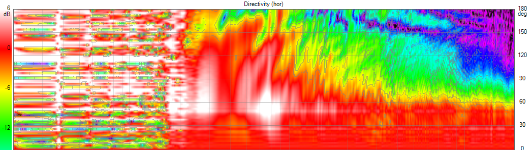

This is done to rev 2.0.52.0. I tried to make parsing according EASE's documentation found in www: V[mmm]H[ppp] where V[mmm]=meridians and H[ppp]=parallels.
My interpretation is that V[mmm] is orbit (phi in CLIO) and H[ppp] is off-axis (theta in CLIO). Few examples:
- V000H060 => Hor 60 in VCAD
- V000H300 or V180H060 => Hor -60 in VCAD
- V090H060 => Ver 60 in VCAD
- V270H060 or V090H300 => Ver -60 in VCAD
I'm not entirely sure that it's correct. Could you verify is this okay?
Hi Kimmo,
I just returned from holiday, thanks for making this option!
However, while checking it seems not to work as expected (getting the error: 91 rotated or illegal derctions not loaded), I have a link with some measurements in it, so maybe you could see on your system what goes wrong.
Ease Speakerlab format measurements.rar - Google Drive
Many thanks for the effort again!

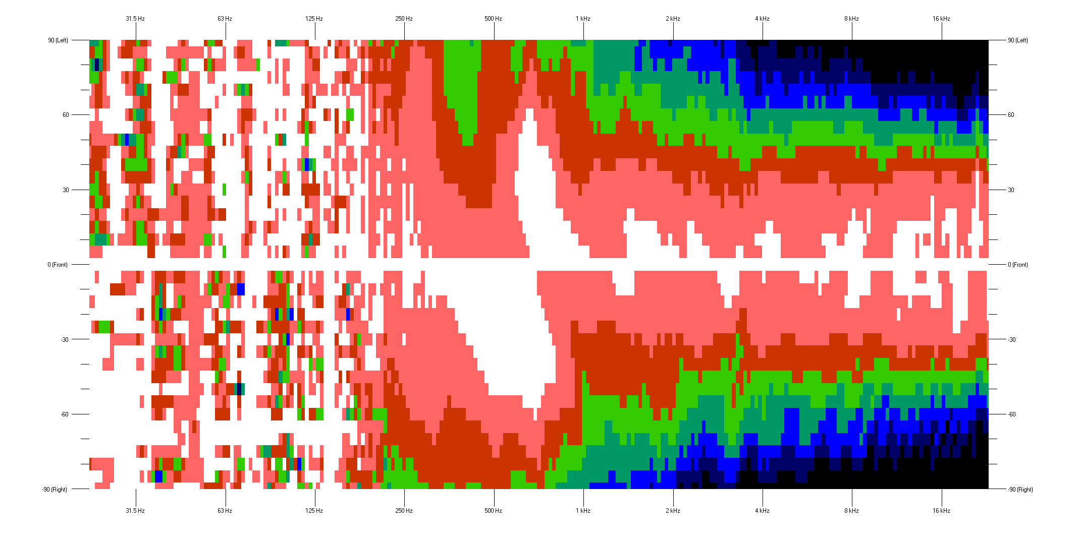

ps attached is a polar picture of speakerlab; the measurements should give these reults (hf horn, 80degrees opening angle)
^Very sorry but the files and graph don't match imo. Filenames are V000H000 ...V000H180 which looks one side from main axis 0 deg to rear +180 deg in horizontal plane, but not the other i.e. negative angles. Graph shows half space from -90 deg thru axial 0 deg to +90 deg, but not rear sector at all. In addition, response in horizontal plane changes sharply in graph when angle sign changes from positive to negative. Typically that does not happen with any horn. All this assuming that V000H000 is main axis (0 deg hor & ver) and angle value after "H" is not divided by >1 or mirrored to other plane. Response file V000H046 or V000H048 has the highest magnitude.
So far I've just removed "-ref" and ".spk" from filename before angle parsing. Angle reading works okay, but something else might be needed. Official documentation with images could help.

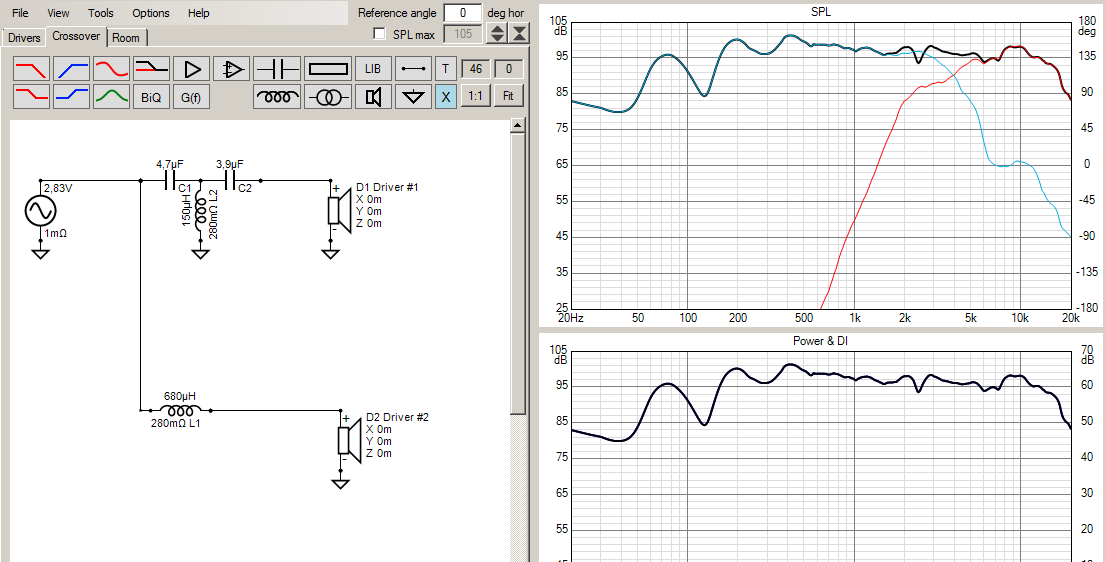

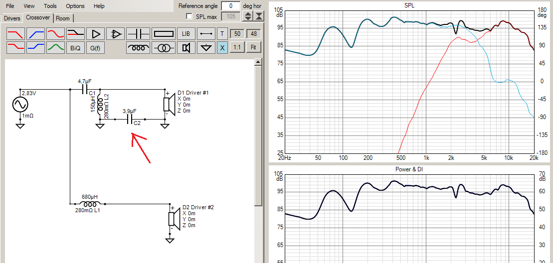

A big thanks to Kimmo Saunisto for this fantastic software! Extremely satisfied with it. Just one stupid question: if I move the 3.9uF can to the negative node, the effect is not shown? Both cases should give the same effect on the highpass.
Many thanks and best regards!
https://i.postimg.cc/QdNnXtsJ/XO-1.png
https://i.postimg.cc/Vk7Z58kQ/XO-2.png
I Think you are correct and something is strange wrong with the naming of the files, I will investigate further.

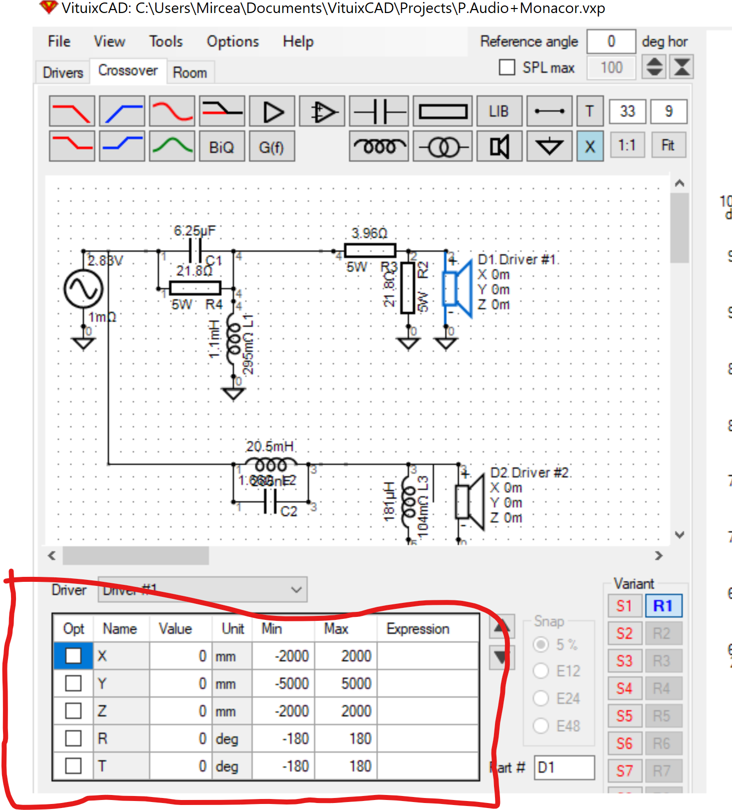

Drivers location
hello!
first: thank you for your effort in developping such a great software.
second: I am trying to learn and, trust me, for the past week I've been reading the manual, but it still has a lot of enigmas. one of them is the location of drivers. relative to what? (please, see the attached picture) position on the front baffle? and then I can not find Driver Layout tab. could you be so kind and point me in the right direction?
thank you in advance for any answers and\or suggestions.
I use 2.0.53.2
hello!
I use 2.0.53.2
"relative to what?"
Relative the listening axis. It usually runs from the listener's ears through the center of the tweeter. Page 3 in https://kimmosaunisto.net/Software/VituixCAD/VituixCAD_Measurement_Preparations_REW.pdf
Usually we specify speaker's main axis more or less formally as invisible Z-axis line from speaker to ear/mic when speaker's main axis (hor=0 ver=0 deg) points towards ear/mic. Starting point of that line is speaker's origin X,Y,Z=0,0,0 mm, and axial location of ear/mic is X,Y,Z=0,0,-listening distance.
Origin does not have to be final because program allows moving of all drivers so that origin moves e.g. from center point of tweeter to center point of mid-range. Whatever meets your design targets.
Driver instances in crossover are located relative to speaker's origin, and possibly rotated and/or tilted relative to direction of main axis.
