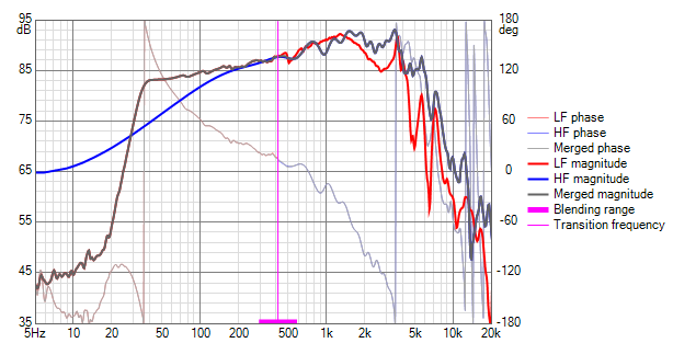

One example measured with CLIO fw-02 & 12 QC. Noise is limiting to about 40 dB below merged SPL when cone is measured near with 0.283V (-20 dB) and passive radiators with 0.9V (-10 dB).

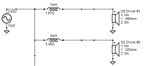

Kimmosto, i found that the crossover does not correctly calculate the inductor resistance. Smaller inductance should have less resistance. The wire diameter is the same.
DCR cannot be calculated by L and gauge alone so it's obvious that whole purpose of the feature is not to give exact result. It just tries to guess change to previous value when you change either L or gauge with up/down key or mouse wheel. Guessing is based on simple statistics from typical/available air core inductors between 0.5 and 2.0 mm.
Personally I think that feature sucks, but negative feedback is not much received. I guess most of the users realize that final DCR should be verified from datasheets of coil manufacturer.
