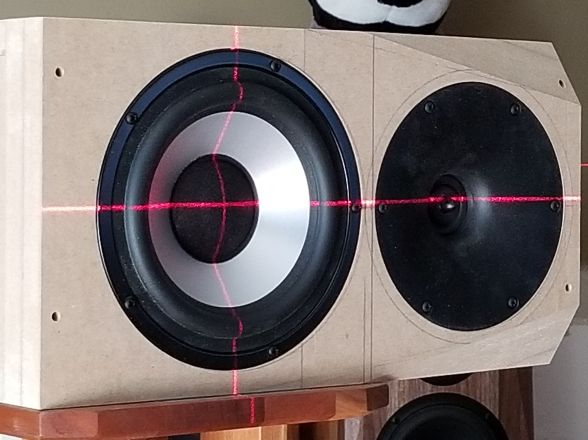

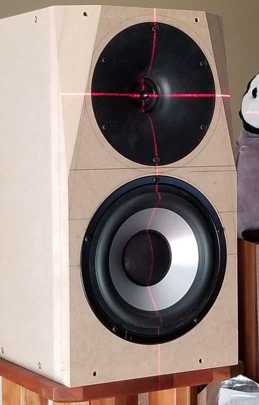

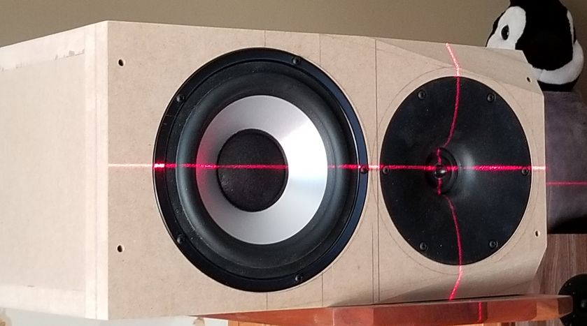

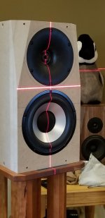

I just finished up my Arta Turntable and I am trying to understand the instructions in,
https://kimmosaunisto.net/Software/VituixCAD/VituixCAD Measurement Preparations.pdf
I have included a few pictures to see if I am understanding the instructions correctly
Starting positions for measurements, not necessarily in this order,
Measure woofer 0º -180º in X axis, microphone centred on woofer and on axis, using real world X rotation,
Measure tweeter 0º -180º in X axis, microphone centered on tweeter and on axis, using real world X rotation,
Measure woofer -180º 0º -180º in Y axis, microphone centered on woofer and on axis, using real world X rotation by placing speaker on its side,
Measure tweeter -180º 0º -180º in Y axis, microphone centered on tweeter and on axis, using real world X rotation by placing speaker on its side,
(pay no attention the stand poking out from under the speaker, I know that would be a diffraction problem if measurements were done this way, pretend the speaker overhangs the stand... 🙂 )
Is this how the measurements are to be done?

The measurement process as presented is correct.
The front baffle is assumed to be perpendicular to the mic, which in this case looking at the speaker, it is.
Attention must be paid that the mic distance to the baffle surface when measuring each DUT is maintained as constant as possible, reasonable within few mm.
Using ARTA semi-dual (or full dual) measurement process will assure all signals are locked to the same impulse start.
Measured this way each driver has initial values for X,Y,Z zero.
Then, if designing for a tweeter-axis, the tweeter will remain at X,Y.Z zero (even if the tweeter is set back in a WG like in your case), and the midbass will be at X,Z zero and Y= -160/165 mm aprx, assuming the WG148 diameter of 148 mm and cca 170 mm for the midbass, plus some 15 mm inbetween.
Hope this is what you were asking. It is well documented in V2 Measurement preparation document.

^^Basically yes, but I don't measure vertical plane with circular drivers - especially in small speaker where distance from center point of woofer to bottom and side walls is quite equal. Error in power response will be less than 0.5 dB at baffle step hump (@mid-range) without separately measured vertical data. Effect of vertical lobing is several times bigger with multi-way. Simulator handles that with response mirroring (from hor to ver) and virtual XYZ-locations of measurement data i.e. center point of drivers.
Situation will be totally different with ribbons/planars and other hor/ver asymmeyrical radiators such as elliptical and bi-radial horns. These should be measured in both planes if possible. Heavy tower speakers are difficult without modular construction.
Your box is so small that you could also consider measuring both drivers in horizontal plane only at middle elevation between woofer and tweeter (without moving mic vertically). Angle error at 1 m will be about 4 degrees which is quite acceptable for a ring radiator in wave guide. You miss exact axial response which is not valuable design axis for that type of radiator.
Maintaining rotation center in the center point of each DUT is sometimes quite difficult due to swinging of stand etc. Significance of error depends on XO frequency. Variation within 2 mm is usually possible and okay with XO frequencies below 4 kHz. I usually check distance from mic to center of DUT to three directions: -90, 0 and +90 deg. Phase interpolation in the simulation collapses anyway to angles >>90 deg, but front sector should be in control.
So, for a small two way like this, separately measuring the the woofer and tweeter in X rotation 0º-180º at one meter out with the microphone in a single position is adequate?
How would "Y" be entered in VituixCAD for driver position in a measurement taken this way? Use real numbers +- from mic/baffle position, or zero?

Both Y's zero....
Probably yes. But now you have motorized table for making also diy science and compare results of full and simplified measurement sequences with small 2-way speaker. I have done comparison with diffraction simulations loaded to main program as measurement data. Power, DI and many other CTA-2034 reports contain so many off-axis responses that some approximation happens anyway.
Here we are just cheating the simulator (and ourselves) that measurement data was captured by official recommendation; with individual rotation center for both drivers at axial Y. So you can locate center point of each driver instance as you like: tweeter=0, woofer=-160 or tweeter=60, woofer=-100, ....
You specifically mentioned ring radiators in a waveguide as not necessarily requiring a "face on" measurement, would that apply to domes in a WG as well?
Same story with any driver giving quite close to same response to 0 deg and 4 deg. Long ribbons, ATMs and other planars need actual 0 deg ver measurement due to "excessive" vertical directivity. Vertical -4 deg off-axis would be radically something else than on-axis.
Effects of small measurement cheating reduce if you can measure at 1.5 m or 2 m. My instructions are written for poor diy audio labs such as our 25m2 living room (ceiling at 247 cm) requiring short time windows.
With full dual measurements preserving phase, does tweeter Z offset still need to be determined and entered in driver settings?
Maybe I confuse more but we are not locating actual or simulated drivers or acoustic centers to crossover simulator. X,Y,Z location of driver instance in crossover simulation is rotation center of measurement data loaded to driver model (in Drivers tab). Measurement data is also possible to tilt (vertically) and rotate (horizontally) around it's center point which simulates locating driver e.g. to side, top or back panel of the speaker.
So Z=0 mm for all drivers instances if rotation center has been at the same distance from microphone while off-axis measurement sequences. All timing differences between rotation center and assumed acoustical center of drivers are stored in measurement data assuming that all frequency responses are measured and exported by instructions: dual channel connection & mode and common Reference time.
Both Y's zero....
This is correct if also vertical plane is measured at common Y and loaded to simulation.
But if both drivers are measured at common Y in horizontal plane only, driver instances in XO must have different Y mm. Otherwise result is wrong due to ignored vertical lobing.
Quick but important reminder that measuring also vertical plane at common mic Y (in the middle of drivers) is NOT recommended. 1/48 points per octave frequency scale cannot handle phase responses if distance between DUT and microphone i.e. timing varies too much. Excessive variation causes phase wrapping errors at HF in addition to IR shifting within time window at fixed position (=dual channel).
Common mic Y position for both drivers of a small 2-way is valid method if only horizontal plane is measured, and vertical plane is mirrored from horizontal data by the simulator.
So all good simply by following instructions.
