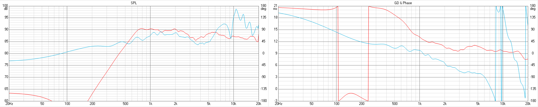

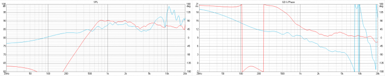

Referring to my post 2256 VituixCAD I'm attaching picture with drivers characteristics.
Maybe phase wrap (cone breakup?) is source of simulation mismatch above 7kHz? But still -12us (-4mm) is mysterious for me. If mic distance from baffle is 100cm then I can read from impulse responses:
Tweeter - 99.93cm
Woofer - 102.08cm
Woofer measured on tweeter axis - 102.44cm
Tweeter - 99.93cm
Woofer - 102.08cm
Is my setup ok? Am I doing everything correctly?
Your text looks okay.
As you can see the simulation result isn't ideal.
I don't see any simulations with XO yet. Just plots of measurements. Let's evaluate ideality once you have simulated complete speaker.
I wonder about Delay option for woofer. Should I modify it if I've made dual channel measurements?
No, or Delay[us] value in Drivers tab should be exactly the same for woofer, mid and tweeter.
Whole idea of dual channel measurement is to include also delay difference (on axis) between drivers (by rotation center on baffle surface). Purpose of crossover/filter is to shape measured magnitude and phase responses of drivers to get targets in project cabinet.
During exporting every frequency response in Arta I've set start point on 300th sample, predelay based on tweeter measurement and end marker I've set the same on every measurement but not to take any reflections.
The latest instructions recommend using Convert IR to FR of VituixCAD for this but polar export of ARTA works too of course though it's not so visual.
