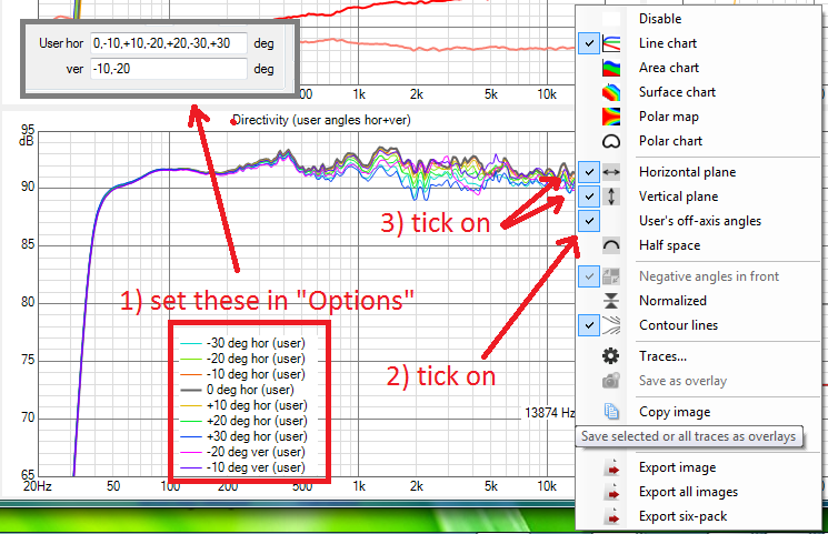

Thanks to kimmosto doable as a user set mix in directivity plot, guide below, example use listening window directivities set in options..Oh, on that notion it would be nice to have an active only version, where you could replace the impedance diagram with a copy of the directivity diagram. Than you can setup one for horizontal and one for vertical angles and keep an eye on both while equalizing without switching between them!

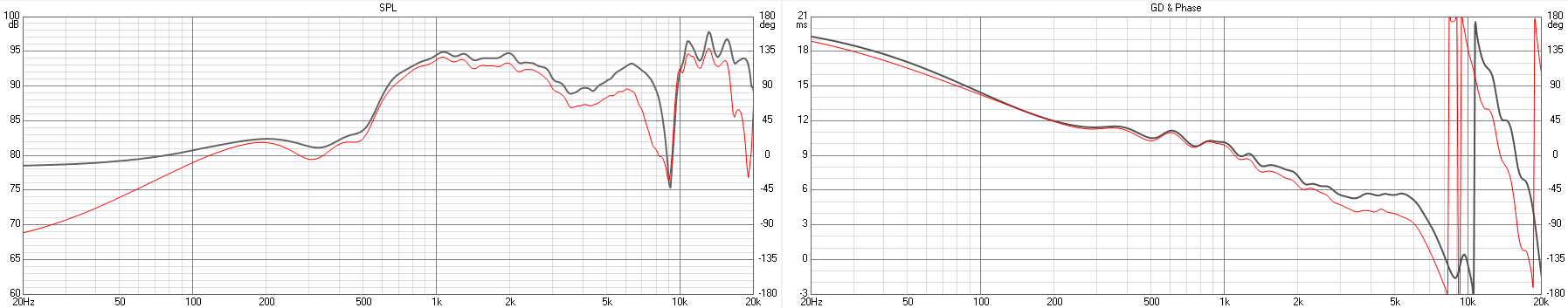

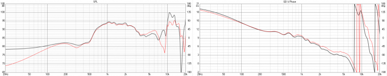

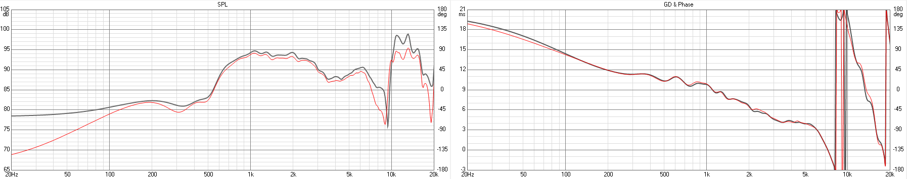

I'm going to make spatial measurements of my drivers. At the beginning I want to check my setup and if I make everything in correct way. My measurements are made in Arta in dual channel mode with mic 100cm from baffle.
I've measured:
1) Tweeter centrally on his axis (for impulse Arta says 99.93cm)
2) Woofer centrally on his axis (for impulse Arta says 102.08cm)
3) Parallel woofer + tweeter, centrally on tweeter axis.
During exporting every frequency response in Arta I've set start point on 300th sample, predelay based on tweeter measurement and end marker I've set the same on every measurement but not to take any reflections.
I've imported my measurements (and measured impedance) to VituixCAD and made simulation for parallel connection. Measure distance in options I've set to 1000mm.
I've attached some pictures where:
Black on SPL is simulation result and red is overlay from woofer + tweeter measurement.
Black on phase chart is woofer simulation phase and red is phase overlay from woofer measured on tweeter axis because I assume that simulated woofer phase should be identical to phase from this measurement.
On the first picture there is a result after importing measurements.
On the second picture I've set Y coordinate for woofer to -132mm as is in reality.
On the third picture I've tried to fine tune result by setting Y coordinate for woofer to -134mm and delay for woofer to -12us. And it's the best result I could obtain.
Is my setup ok? Am I doing everything correctly? As you can see the simulation result isn't ideal. But is it reliable enough for further measurements and simulations?
I wonder about Delay option for woofer. Should I modify it if I've made dual channel measurements? I think Delay for woofer should be positive in my case, not negative, but I don't know why negative value make better result.

"delay for woofer to -12us"
The delay should be positive for the tweeter. For the woofer, accordingly, it will be negative. In terms of setup doubts, does the woofer operate from 600 Hz to 3.5 kHz? 3.5 kHz to 10 kHz there is pit. Does the tweeter work from 10 kHz? If so, why such a setup? Wrong measurements?
