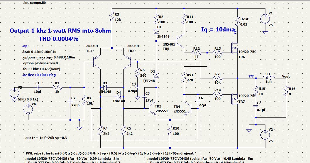

Ok, see that you mean this cascade currents source now. But do you really think that two transistor current source is such a bad choice for this amp? It's used in a lot of input stages, of much more higher performance amplifier than this one.
Two-transistor CCS from secong image in your post are good too.
But shown Hawksford's CCS are the best in terms of output resistance because it compensates output transistor base current while two-transistor CCS have the lowest voltage headroom to operate.

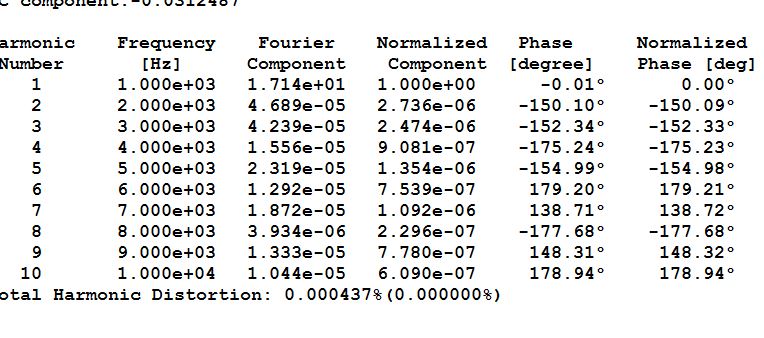

No need CCS. For 18W 1khz you still get 0.0004%THD with 12k resistor with 155ma output bias.

The diodes limit the vas current on saturation. The purpose of R9 is to equal the collector voltages of the differential, the zener alone does the same.
The crossover distortion exhibit at H5, it must be lower than H4 and still not the case. May be with 175ma bias?

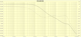

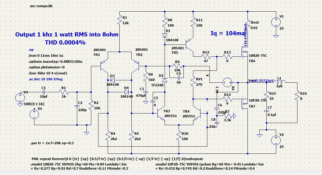

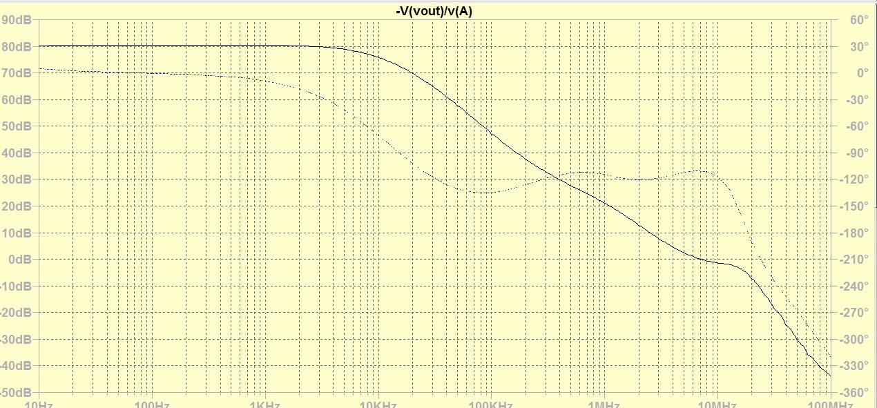

You need to work on the loop gain to have higher NFB @20khz. The two 27pf must be replaced with other type of pole, maybe CRC between the bases to get 2pole compensation.
The distortion @20khz 21W is 0.005%.

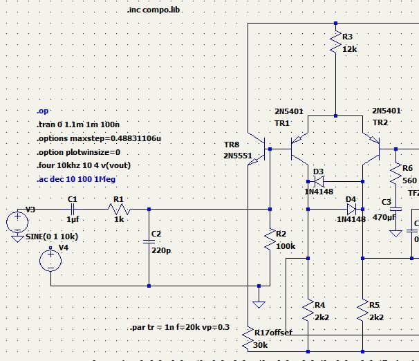

The input impedance can be increased to use 1uF capacitor by adding a transistor in Pionner way. I would prefer to replace the input transistors with MOSFET BS250, see post 17.

Well that is very impressive! Only 0.005 % at 20kHz... I'll have to try the two pole compensation network then I get time again. Assuming this is what lowered the distortion at high frequencies.
Regarding the input impedance. It was never my intention to keep that high anyway. Was thinking that about 10k would be enough.
Never simulated the circuit with higher bias current than 100ma actually. Keeped it at the level for comparsion. Then I build the actual amp I will probably connect it to distortion meter and then adjust the bias to lowest distortion.
Yes, loop depth is the main way to reduce distortion when OPS are well enough.
No.
Since your scheme will work with volume regulation pot in needs very high (at least 10 times, better 100) input resistance and neglible dynamic capacitance at common and differential modes.
