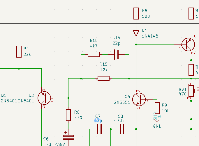

Ok, I see. That formula tells me that the capacitance of the smallest capacitor in the two pole network greatly affects the loop gain (due to the series capacitance). I agree that 27p seems very small in general, but it seems like that was this circuit needs (tried a lot different values now). Higher values kills the slew rate, so that's a trade off.
Degeneration could also work, tried with 100 ohm. Bigger values also kills the slew rate, but of cause its a very useful trick if an amp becomes unstable.

Not really sure how much the two pole compensating network actually affect the circuit. Removing it only slightly increases distortion from 0,015 to 0,03 % or so at 20kHz. The biggest difference is the VAS current I think. Will probably have to build it this weekend and find out...

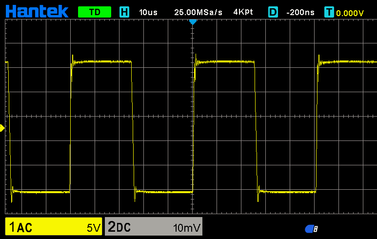

The square wave response shows some ringing, so stability may be a problem. But I guess slowing down the amp by degeneration and/or bigger compensating cap will take care of this. 45V slew rate is much more than needed for 20W amp anyway.

Observing square waves has two purposes.
One is observation at large amplitudes, with the purpose of measuring slew rate and investigating whether recovery from saturation is appropriate.
Another objective is to check the stability of the feedback within linear operation using small signals. Many op-amps datasheets also list both.
The latter should not use a large signal that would conflict with the slew rate. Slew rate is a nonlinear operation that occurs when the current in a part of the circuit saturates.
Also, since the input filter is outside the feedback loop, it interferes with observation. However, it is a hassle to remove.
In that case, we recommend the current injection method.

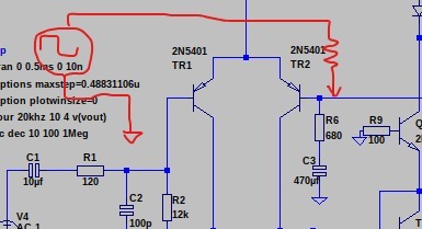

Add a square wave to the inverting input (base of Tr2) via a resistor.
Use a value for this resistor that is sufficiently larger than R6 (20 times or more) so as not to change the feedback factor.
Place this resistor on the amplifier side. Do not place it on the oscillator side and extend the cable because the capacitance of the inverting input increases.
I think the output should be around 1Vpp. If you check at a higher frequency, you can better see the overshoot and ringing at the rise and fall. At this level, it should be safe even above 100kHz.
The output L is also outside the feedback loop, so the observation point will be in front of L.1
Although it is outside the feedback loop, it does affect the loop characteristics.
Input filters also affect loop characteristics. my previous post
In addition, in the case of 2-pole phase compensation, even if the compensation is appropriate, a peak will occur in the high frequency range (near the unity loop gain), and overshoot will usually occur in the square wave response. This can be corrected by adding an R+C circuit in parallel to the feedback resistor (R7).

And the purpose of this method is to eliminate the influence of the input filter, am I correct? I'll have to try this...

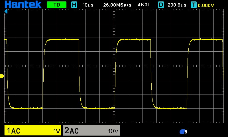

Anyway, think I got rid of the ringing. It appears that the most effective way was not too increase the compensating caps (but increased it to 47p anyway) nor adding degeneration. Instead putting a RC link across the feedback resistor (as previously suggested) did the trick. Values were very picky though, settled at 22p + 4k7 ohm, first by simulation and then by testing. Slew rate dropped to about 15 V/µS, but then I think this is acceptable for a 25W amp into 8ohm. Distortion wasn't affected at all for 1khz (actually improved a bit, but my measurements ain't that really accurate). So wish to be able to measure the higher frequency distortion now...
Yes, inputting a square wave through the input LFP slows down the rise and fall, so it is possible to overlook instability at high frequencies.And the purpose of this method is to eliminate the influence of the input filter, am I correct?
It was good.Anyway, think I got rid of the ringing.

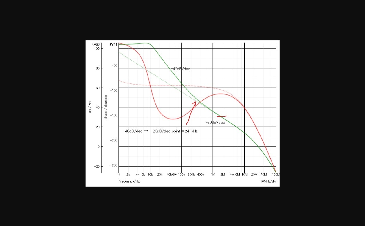

The figure below is an example of the open loop characteristics of another circuit.The dotted line is 1-pole compensation, and the solid line is 2-pole compensation and green is gain, red is phase shift.
It can be seen that the gain of the 2-pole compensation increases in the audio band.
For an amplifier with a gain of about 30dB, the unity loop gain will be about 2MHz. The phase margin is approximately 65°.
By the way, I forgot to mention,
The pier R of the compensation circuit is determined by the frequency at which the gain changes from -40dB/dec to -20dB/dec and is calculated using the following formula.
f (change point) = 1/(2π(Cc1+Cc2)*Rpier)
In the example above, it is 241kHz.
The pier R is not visible in your circuit diagram, but for example, if it is 2.2kΩ,
1/(2π*(517p*2.2k))=140kHz
It becomes.
Increasing this frequency increases loop gain and lowers distortion, but reduces phase margin.
A value of about 1/5 to 1/10 of the unity loop gain frequency is recommended.
However, changing this value also changes the optimal value of the correction R+C in parallel with the feedback resistor.
Interesting. I did just as you suggested, used a 22k resistor to feed a square wave signal directly to base of Q2. looking at the signal with a scope before the output inductor showed no signs of ringing at all. Actually I thought what I had slowed down the amp a bit to much. Slew rate was quite low, (about 15V/µS rising and 12 V/µS falling). But then this wasn't the purpose of this test, right? Measuring the output at full power into a 8 ohm load, show a slew rate of about 30V/µS instead, which is good I think.
Here's how the "internal" square wave of 20kHz looks like;
It's 1k, in the attached pdf is the whole schematic, sorry wasn't really clear in previous post.
Picked 1k just because it's a textbook example standard value. And I wasn't aware of that formula actually, but I noted that it had some affect to the simulations but did not know how for sure. So thanks for that information.
Inserting 1k into the formula gives; f=307 khz, and unity unity loop gain frequency that i got from LTspice simulation was about 8Mhz (don't know why I couldn't get it right using your formula). That means about 1/26, so what does that tells us?
Anyway I think the amp seems to preform well now, stability or speed does not seem to be a problem. So to test the distortion at higher frequencies, I very quickly build a 10khz sine wave generator which tested <0,001% second harmonic distortion. Used it to measure the distortion, and it tested about 0,0033 % into 8 ohm and 0,009 % into 4 ohm at 1 W. Using a soundcard and REW to te measure the distropn I'm not abale to measeure the thigher harmonics (or maybe but I haven't figuered it out yet). But then measureing distrotion a 1 kHz I've seen that the second order harmonics is about 99% of the THD, so I'm guessing this is the case now too. If so this is looking quite promissing.
Yes, this test does not measure the correct slew rate. Measured in large signal operation.But then this wasn't the purpose of this test, right?

I tried calculating the ULGF based on your attached PDF schematic.
The current flowing through Tr1 (or Tr2) of IPS is 0.55mA, so gm=21.45mS.
Series value of compensation capacitance Cc=42.73pF.
β=330/(330+12000)=0.02676.
As f(ulg)=2.14MHz is calculated.
I think this frequency is a reasonable and appropriate value for a power amplifier.
The frequency of 307kHz that returns to -20dB/dec for 2-pole compensation is within the range of 1/5 to 1/10 of f(ulg), which I think is appropriate.
I don't know why f(ulg)=8MHz in your LTspice simulation. The square wave response waveform inside the loop looks very clean and stable.
By the way
Looking at the evolution of circuit diagrams so far, you have changed the gain (1/β) many times.
I believe that the gain is a specification that should be determined first, and is not a specification that is determined based on circuit design considerations. If you are doing DIY for your own use, you should decide on a value that is easy for you to use. If the amplifier you've been using so far is easy to use, you can choose the same value, or if you're not satisfied, you can change it.
As formula #86 shows, if the gain changes, the appropriate phase compensation value will also change.
We recommend fixing the gain first and then determining the phase compensation value.
The current gain of your circuit is 31.57=30dB (1/β is 37.36, but it is attenuated to 0.845 by R1 and R2)
Is this okay?
