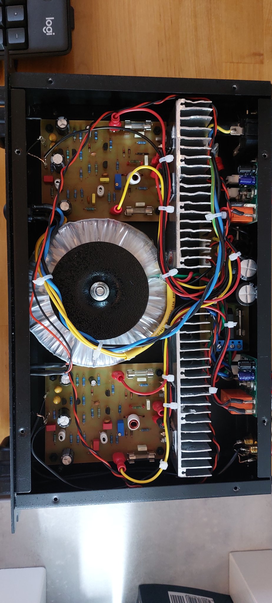

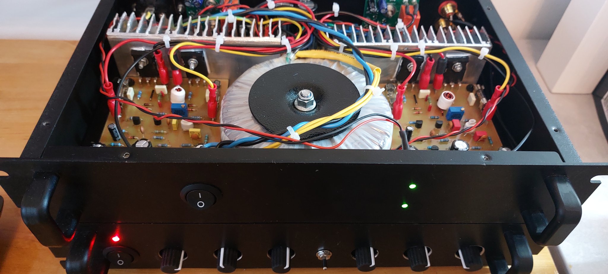

Yes, it's finished now, @mlloyd1 . Right now it's sitting at my desktop and drives two bookshelf speaker for my work room. The amplifier handles this task great, with it's 25W of power or so. The sound is great, much clearer and detailed than the earlier TDA2040 amp. Tried it with bigger speaker in the living room, but that was of course asking to much of it. However for this task that it was design for its doing great. The 160 VA transformer that drives probably helps. With 4 or 5 inch book self speakers, the amp doesn't sound "weak" at all.

That looks fantastic, really nice build!Right now it's sitting at my desktop

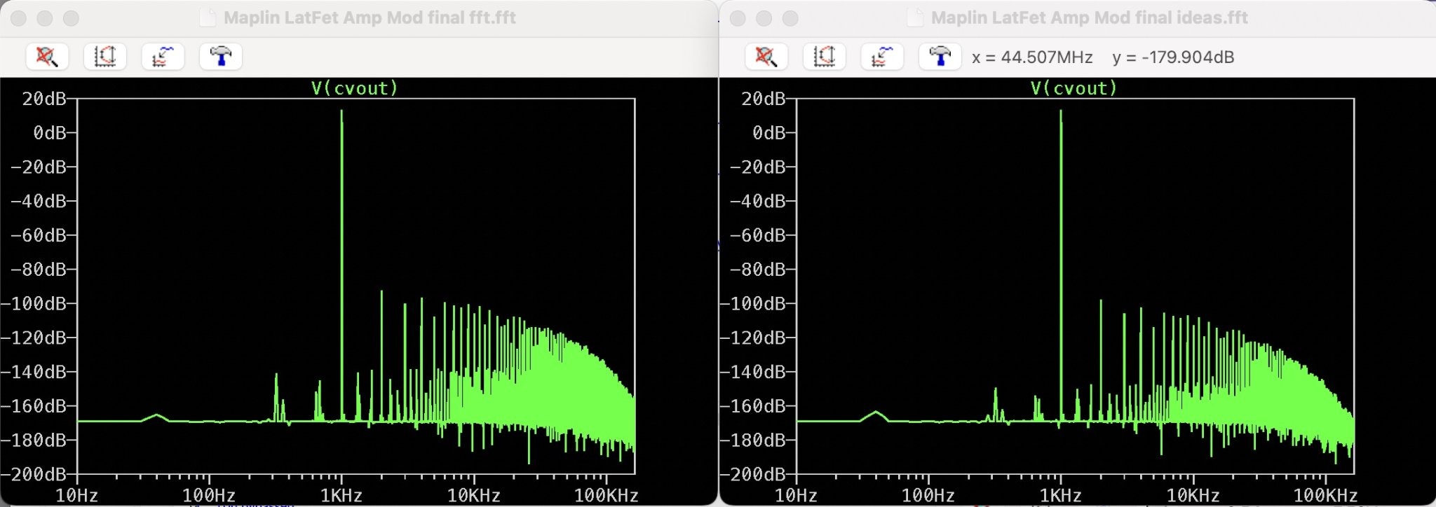

I did a long FFT on the design at various levels, and it seems Class A is almost distortion free:
https://www.diyaudio.com/community/...ga28f-construction-thread.257488/post-7635217
So I suspect you 'cured' it by moving into class A with the increased bias.
IMO it's a combination of crossover distortion, and the speed of the circuit to be able to correct it.
The crossover is a very small slice of time, and even at 1kHz is still requiring a very very fast correction - so I'd also look to see if the capacitors are correct in the RH channel, i.e. anything that may slow the loop down or reduce the open loop gain.

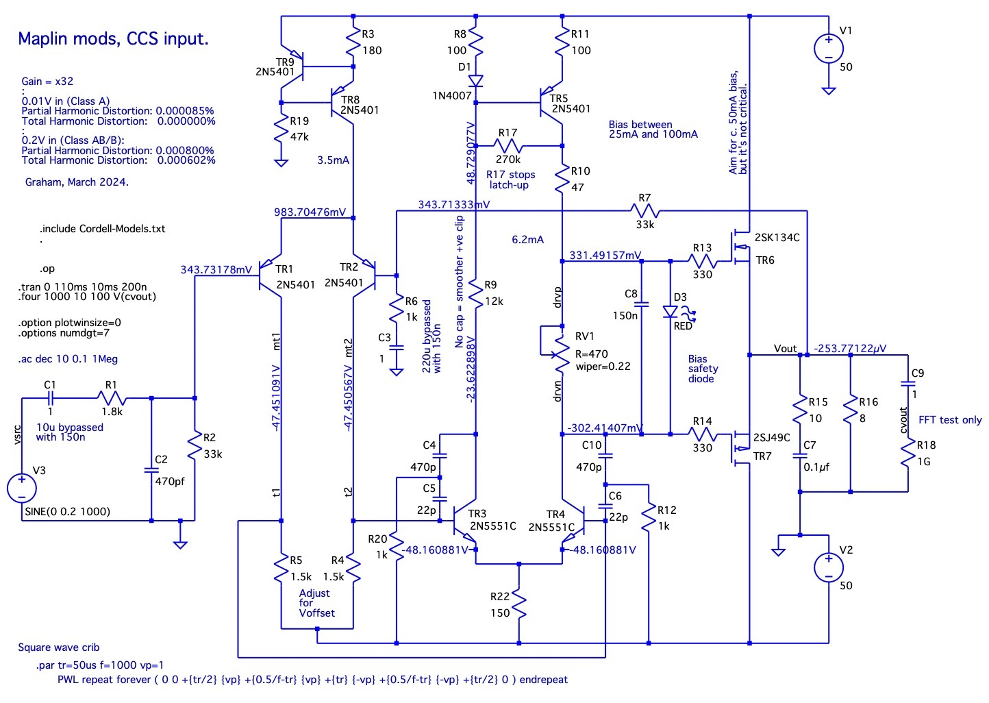

I added the 2 pole filtering to my schematic but LTspice didn't like that, so I'll have to see why!
I tried a number of values in the 6n8, but each time it caused it's own problems, also it's absence created a useful space on the PCB to add the 270K bleed resistor, the 'emergency lift' for the gates if TR5 switches off completely.
I used the 2N5401 for the CCS, and for simulation with the 2N5551, but the other transistors are the original 1980s ones in my board - so I left them! Even at 6.2mA they get warm, 41C I measured in a garage of 17C, but they have stood the test of time and I think the original current was around 6-6.5mA.

Main benefit from two pole is stability I think, that's why it used it anyway. What didn't LT spice like about it?I added the 2 pole filtering to my schematic but LTspice didn't like that, so I'll have to see why!
My 2N5551 transistor gets a little warm to touch, but not a problem. With 6 mA VAS current they'll dissipate about 300mW, well within their specs.
I thought it got stuck, after a few microseconds, sometimes simulators do this - but now I see that when I dragged some of the circuit to create space, I disconnected some vital wires tooWhat didn't LT spice like about it?
Ok, so having reconnected those, on my circuit, just changing to 2pole I get (0.2V in, 6.5Vpk out)
LTSpice distortion single pole 33p
Partial Harmonic Distortion: 0.000773%
Total Harmonic Distortion: 0.000530%
LTSpice distortion two pole 47p 1k 470p:
Partial Harmonic Distortion: 0.000398%
Total Harmonic Distortion: 0.000000%
So that's good!
The spectrum is better, so this is definitely affecting the overall circuit well.
I'll try Q4 later, when I get a chance!, and maybe some square waves..

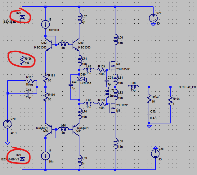

BesPav:Try this mirror-biased two-stage follower OPS.
It will greatly expand bandwidth, soften shoulder transition, allow for huge VAS loading resistor nominals and overall improvement in amplifier's open loop depth with corresponding lowering of THD figures.
I meant to ask this months ago - what is the purpose of D28, D29 and R156 in your output stage?

Aargh... This is a voltage source parts for different design with common base VAS.I meant to ask this months ago - what is the purpose of D28, D29 and R156 in your output stage?
Forget to remove.
- VAS requirements for MOSFET OPS
