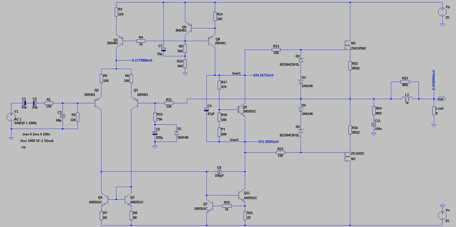

Yesterday I finished a board based on the latest design. It tested OK, pretty exactly as the prototype, which was good. However, since it has shown that changing the input current just slightly greatly affects the VAS current, which is a key factor for distortion, this kept me awake at night.
So I just had to try increasing the current using a trimmer in series with a resistors instead of R4, and the results were promising. Distortion dropped by just increasing the current so very slightly. Settled at a fixed resistor of 620 ohms for R4 instead of 680 ohms as before. This increased the input stage current from about 0,98 mA to 1,08mA. And then the VAS current was increased from 4.95mA to 5,56mA.
The distortion figures are now even more impressive. Especially at higher frequencies and for 4 ohms load (which it is a very big chance that this amp will be driving);
0.0016 % THD 1khz 1W 8 ohm 0.0015 % 1khz THD 1W 4 ohm
0.0025 % THD 1khz 18W 8 ohm 0.0023 % 1khz THD 25W 4 ohm
0.0008 % (2nd order) 10khz 1W 8 ohm 0.0008 % 10khz (2nd order) 1W 4 ohm
0.0025 % (2nd order) 10khz 18W 8 ohm 0.0020 % 10khz (2nd order) 25W 4 ohm
The maximum power output (without too much distortion) may have dropped a few watts from 20 to 18W for some reason. I have no idea why, but everything else seems ok and slew rate is still 20-25V/µS. So far this is looking like a pretty good project I think.
The reason for the decrease in maximum output is that by increasing the current in the first stage, the voltage across R3 and R5 increases, and accordingly, the voltage across R10, R8, and R11 of the VAS also increases, the possible swing range of VAS becomes narrower.
You can increase the output a little by lowering those resistors, but it's only a small difference, so if you don't care, you can leave it as is.

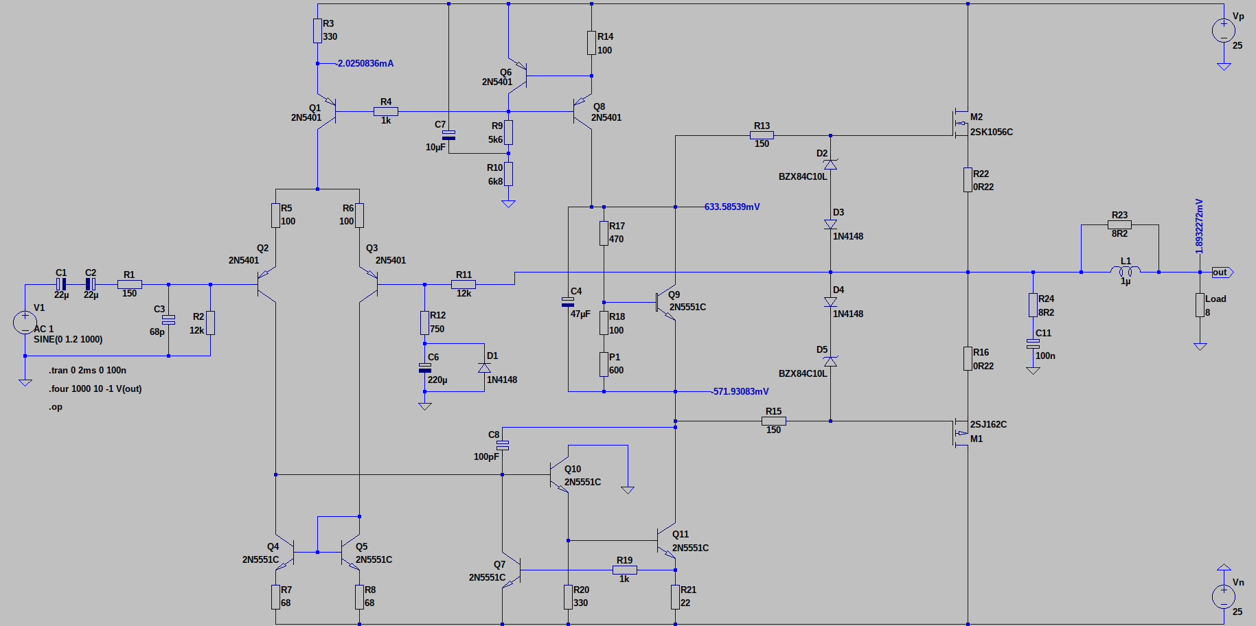

Yes, it's finished now, @mlloyd1 . Right now it's sitting at my desktop and drives two bookshelf speaker for my work room. The amplifier handles this task great, with it's 25W of power or so. The sound is great, much clearer and detailed than the earlier TDA2040 amp. Tried it with bigger speaker in the living room, but that was of course asking to much of it. However for this task that it was design for its doing great. The 160 VA transformer that drives probably helps. With 4 or 5 inch book self speakers, the amp doesn't sound "weak" at all.
The final version schematic is attached. I can upload a Kicad/gerber file for the layout as well if you're interested. As you can see from the pics it's quite simple design; one layer hand made PCB.
After the success with the first board, the second board tested slightly worse though. Maybe I got lucky with the first one, very good transistors or caps? Tried replacing the caps in the VAS from MLCC to single layer NP0's, but didn't affect the results a lot I think. The numbers from testing of the second board was as;
0.0041 % THD 1khz 1W 8 ohm 0.010 % 1khz THD 1W 4 ohm
0.0067 % THD 1khz 18W 8 ohm 0.013 % 1khz THD 25W 4 ohm
0.0040 % (2nd order) 10khz 1W 8 ohm 0.010 % 10khz (2nd order) 1W 4 ohm
0.0070 % (2nd order) 10khz 18W 8 ohm 0.013 % 10khz (2nd order) 25W 4 ohm
Input sensitivity approx 1,2V rms
Slew rate about the same; 25 v/µS
Of couse I wish that I could make those numbers better, specially for 4 ohms. Maybe I should mesarue the amp again and see if somehting changed... It was I really interseting project this one, and I learned a lot.

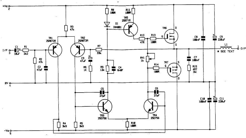

This thread was unknown to me, I was looking and learning a similar route on the Maplin MOSFET amplifier, and it's very interesting to see where we coincide and vary!
See: (This is also sounding superb, still listening, got some first real listening in yesterday!)
https://www.diyaudio.com/community/...ga28f-construction-thread.257488/post-7644501
We concur on the CCS on the Input LTP, I run mine a bit harder, as recommended by Douglas Self's webpage, 3.52mA, the VAS runs at 6.1mA, a little low (but not so hot!), perhaps I'll substitute a 2SA1145 / 2SC2705 pair in another build to get it up to about 12mA.
Good to see you get rid of the 6n8, as it messes up the +ve clip, creating a nasty hollow/invert there. I also found I needed a 'bootstrap' 270k resistor, as I found the VAS can be lazy to 'pick up' the gates when TR5 is fully on, with certain component value combinations, so that stops any of that nonsense!

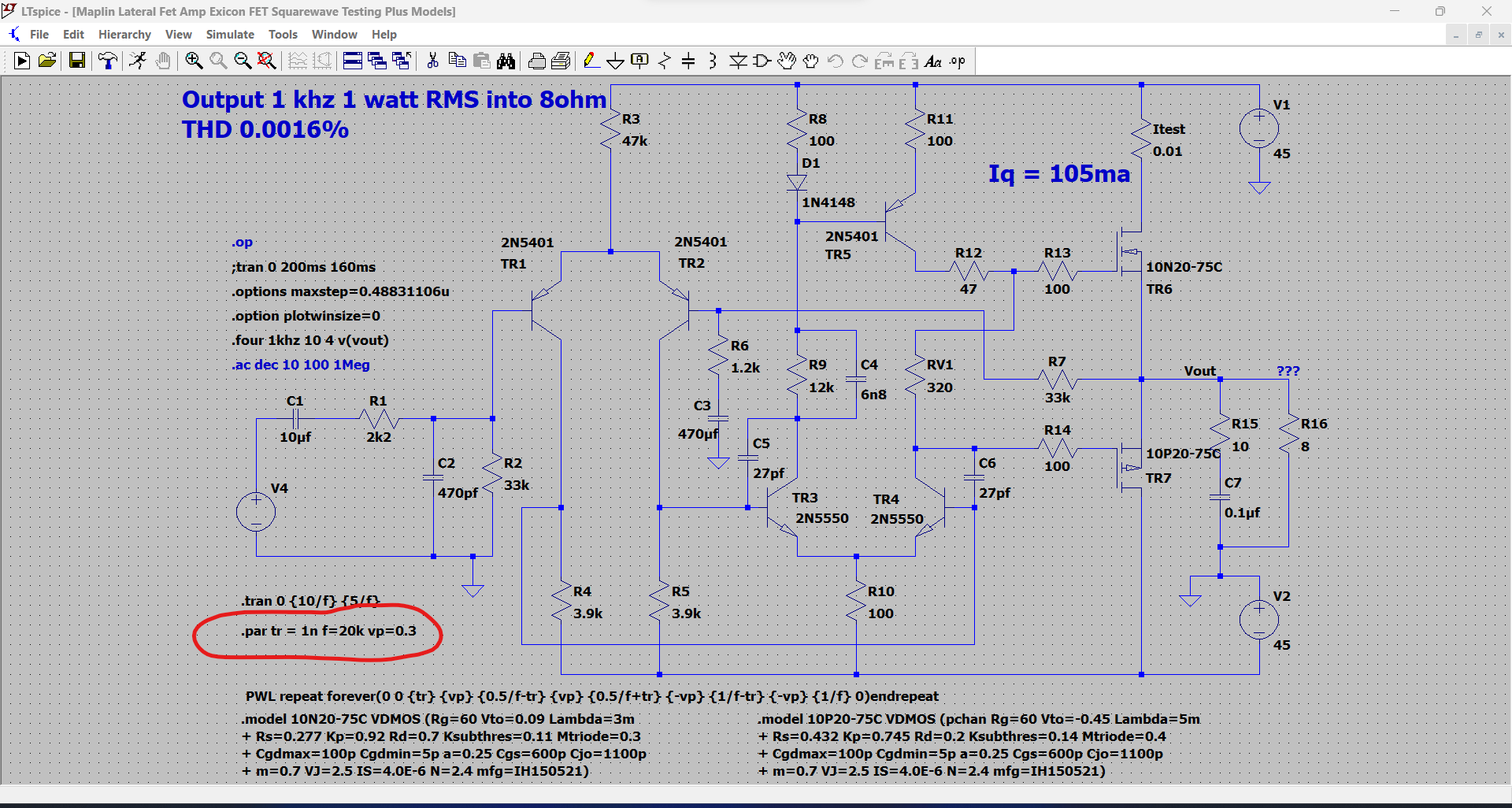

I'll be trying the Q4 trick!
I added the 2 pole filtering to my schematic but LTspice didn't like that, so I'll have to see why!
I tried a number of values in the 6n8, but each time it caused it's own problems, also it's absence created a useful space on the PCB to add the 270K bleed resistor, the 'emergency lift' for the gates if TR5 switches off completely. 😀

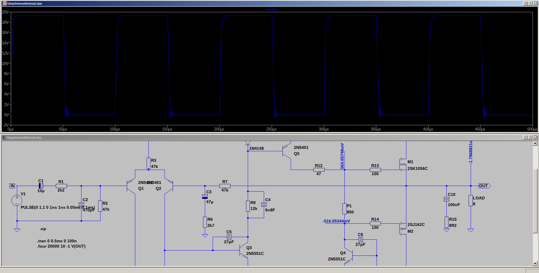

Main benefit from two pole is stability I think, that's why it used it anyway. What didn't LT spice like about it?
I thought it got stuck, after a few microseconds, sometimes simulators do this - but now I see that when I dragged some of the circuit to create space, I disconnected some vital wires too 😀

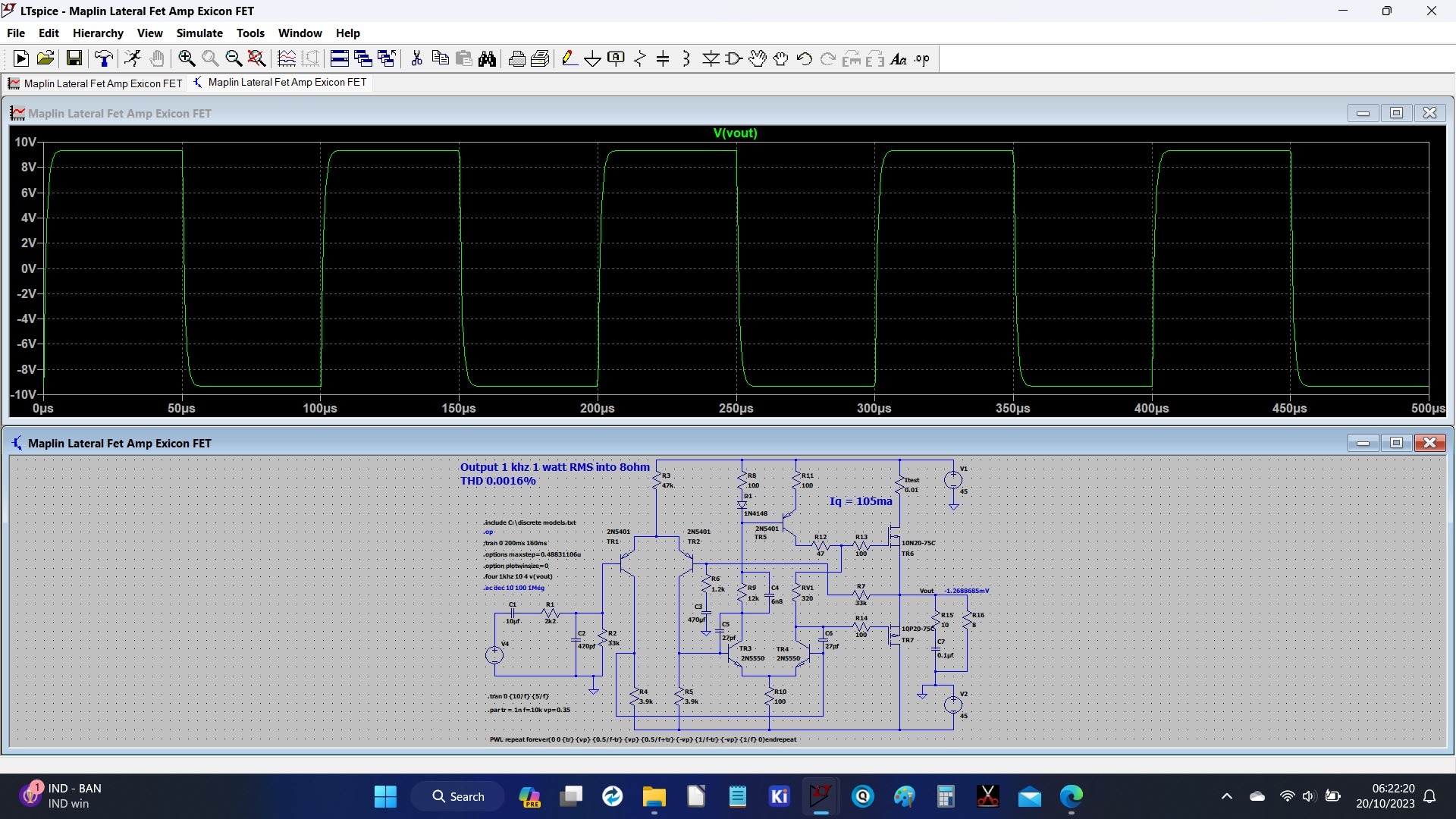

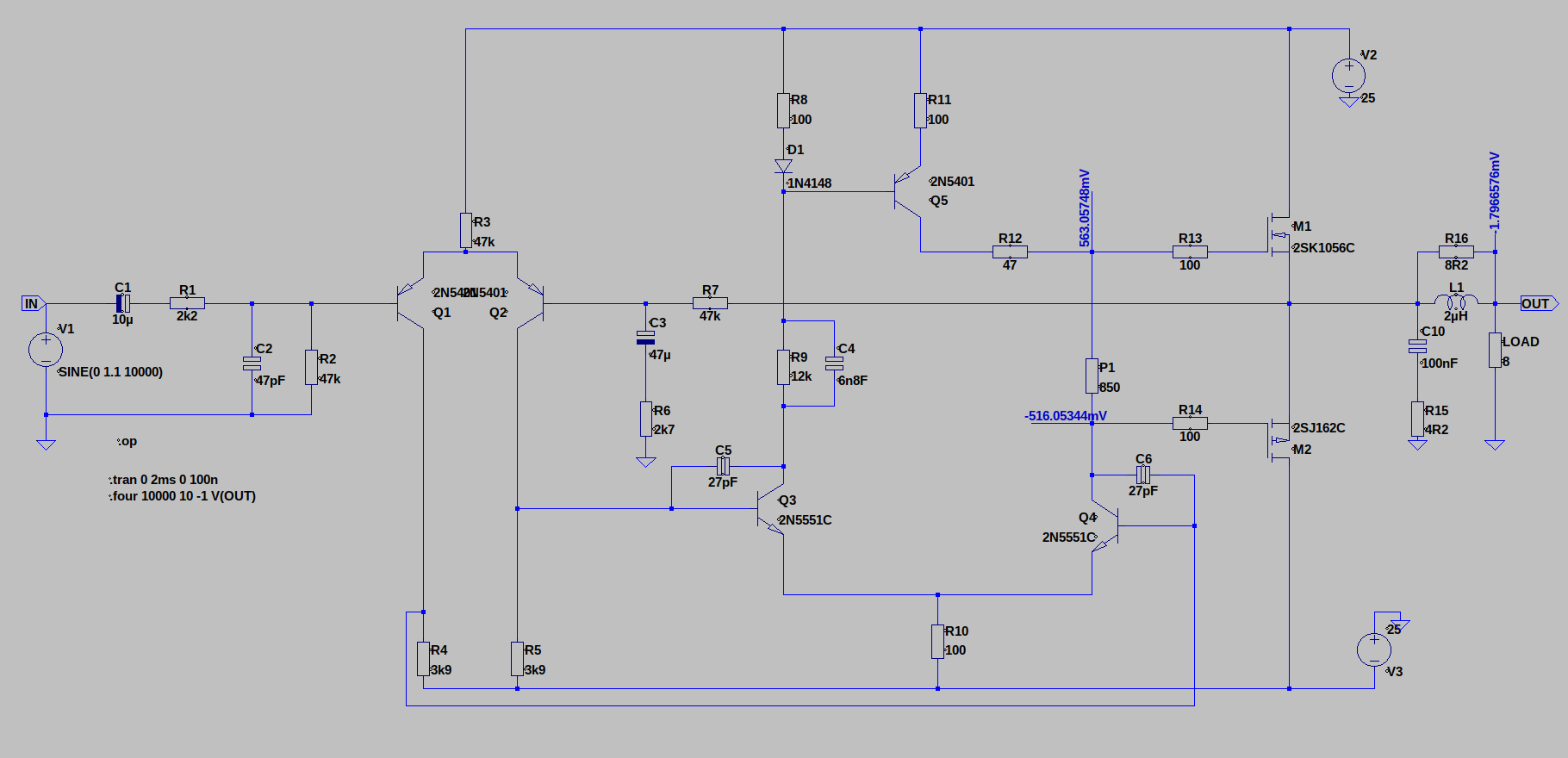

Ok, so having reconnected those, on my circuit, just changing to 2pole I get (0.2V in, 6.5Vpk out)
LTSpice distortion single pole 33p
Partial Harmonic Distortion: 0.000773%
Total Harmonic Distortion: 0.000530%
LTSpice distortion two pole 47p 1k 470p:
Partial Harmonic Distortion: 0.000398%
Total Harmonic Distortion: 0.000000%
So that's good!
The spectrum is better, so this is definitely affecting the overall circuit well.
I'll try Q4 later, when I get a chance!, and maybe some square waves..

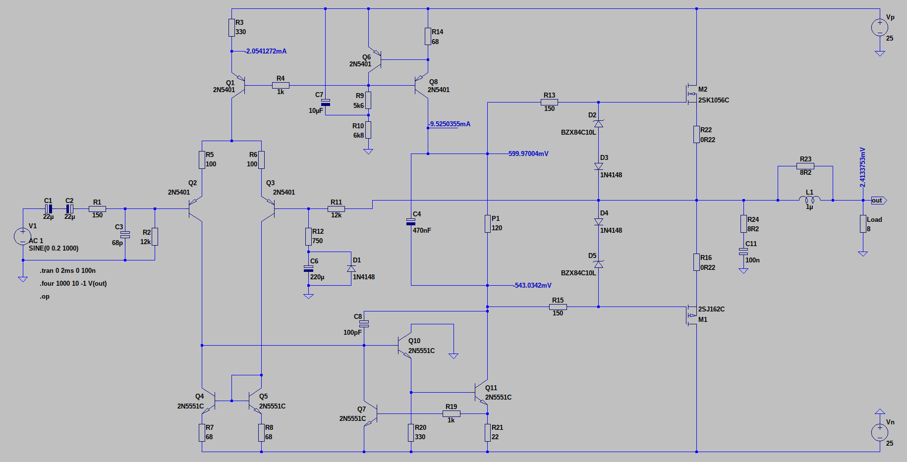

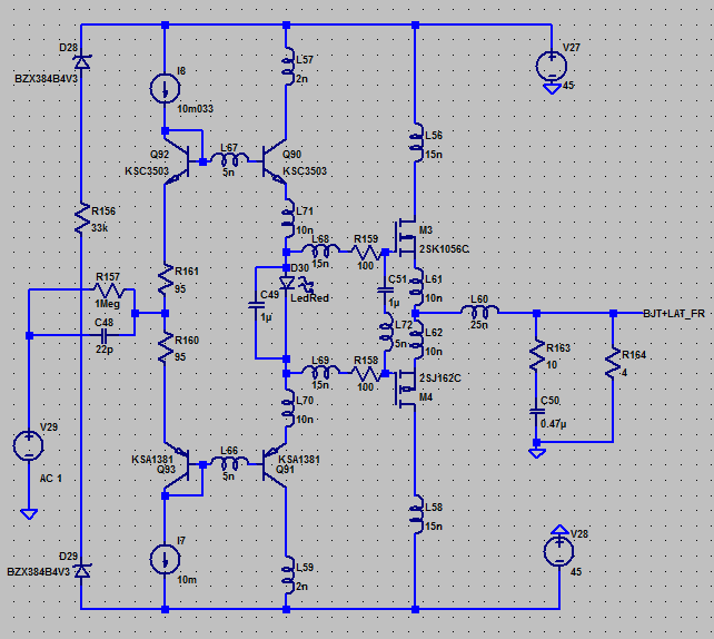

Try this mirror-biased two-stage follower OPS.
It will greatly expand bandwidth, soften shoulder transition, allow for huge VAS loading resistor nominals and overall improvement in amplifier's open loop depth with corresponding lowering of THD figures.
BesPav:
I meant to ask this months ago - what is the purpose of D28, D29 and R156 in your output stage?

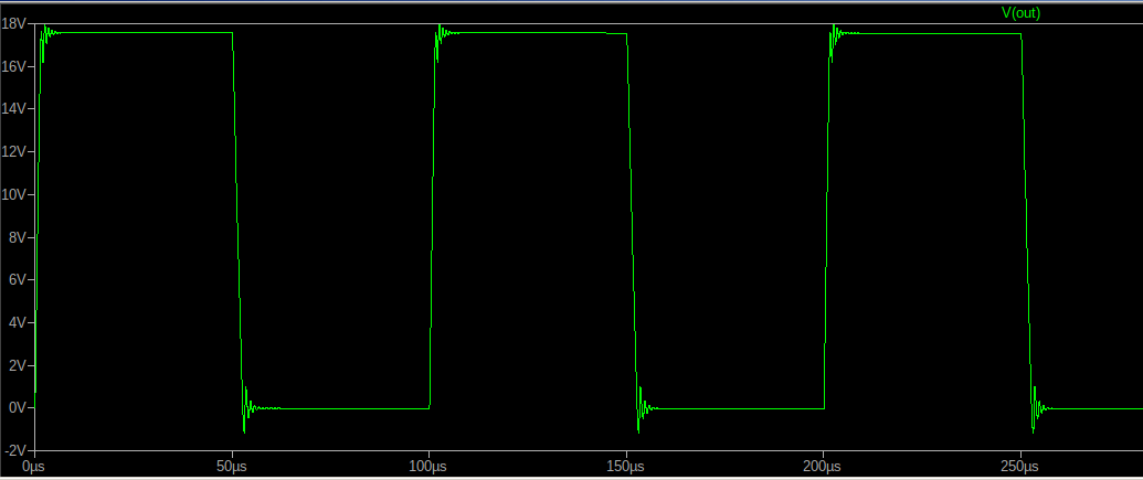

Nice. Even if your real nummers will never be close too that, it's an improvment at least.
You should definitely try that. And check the squarewave response...
Also try some different values of the two pole caps and resistor. As a rule of thumb the second cap should be about ten times bigger as the first one. Which is equal two the single pole capacitor. The resistor value of 1k is common. But try some different combinations, keeping the ratio between the caps about 10. Had some interesting effect of the squrewave response I think.
