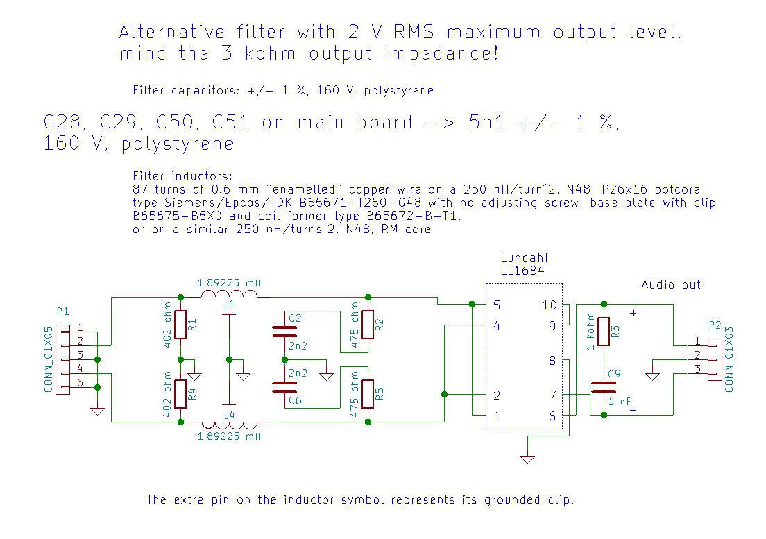

I think 1Vrms from the Lundahl Filter PCB is too low to be optimal without a pre-amp in my system. My current DAC has 2Vrms and it's OK.

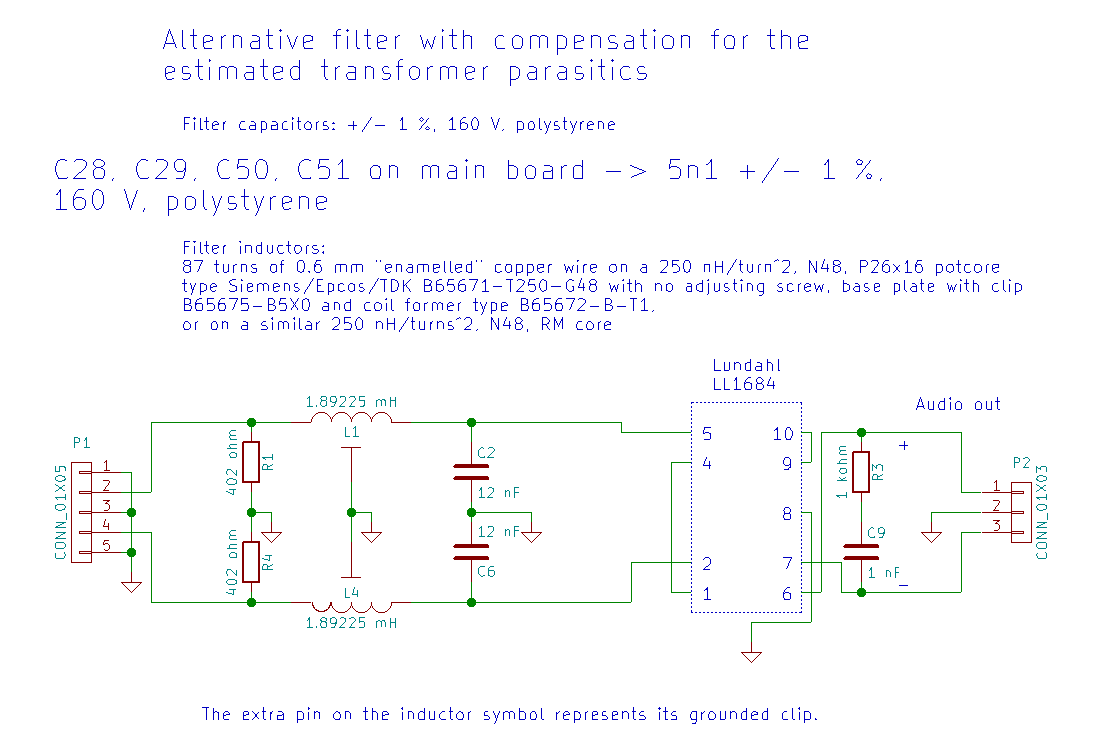

I promised to look into using the Lundahl transformer as a 1:2 step-up to get a 2 V RMS output level. This has some disadvantages:
1. The transformer distortion at very low audio frequencies increases. I estimate that it becomes 0.2 % at 20 Hz at the maximum scarlet book compliant signal level, it drops quickly at higher frequencies. Then again, when the alternative is to insert an extra valve stage, that will distort at all audio frequencies.
2. The output impedance increases from 750 ohm to 3 kohm, so you can only drive short cables and fairly high-ohmic inputs with it.
3. The impact of the transformer parasitics on the filter gets larger. I found I could minimize this effect by making use of the reciprocity of the filter and swapping it. The capacitors on the main board then become 5.1 nF instead of 15 nF. Even with the swapped topology, transformer winding capacitances make up most of the second filter capacitor when you use the transformer as a 1:2 step-up.
In fact swapping the filter to reduce the sensitivity to transformer parasitics is also useful when you use the Lundahl as a 1:1 transformer and accept a 1 V RMS level. See the attached schematics, and note the deliberately reduced value of C9.
Please ignore the statement: "Even with the swapped topology, transformer winding capacitances make up most of the second filter capacitor when you use the transformer as a 1:2 step-up", as it is a mistake. About a third of the capacitance comes from the transformer, based on my estimates of the transformer parasitics.
Just to point out that Marcel's additional filter schematics are not the same as the one used for the GB filter PCBs. If anyone want's to use these new filters designs I'll happily make new versions of the filter PCB and provide a set of gerber files so a small batch of PCBs can be ordered.
