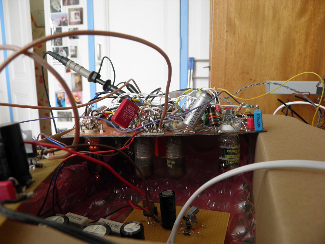

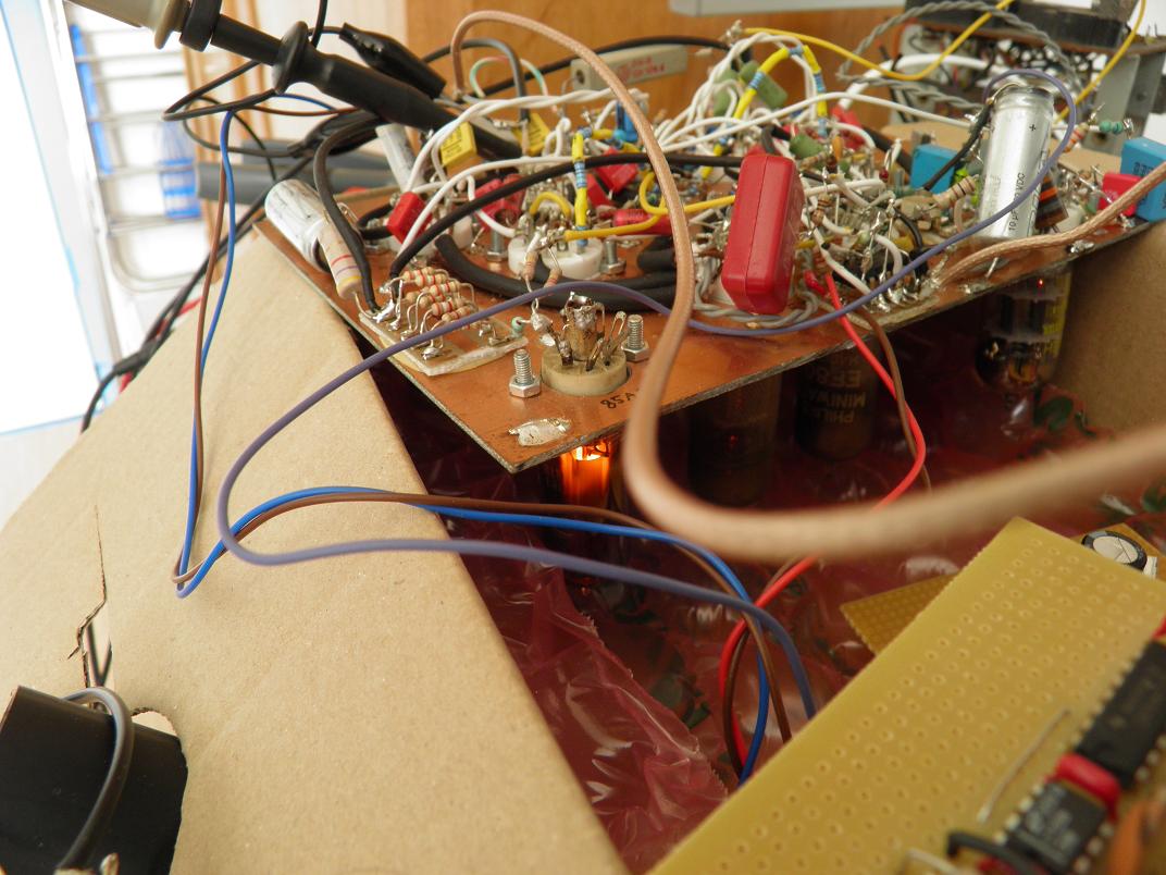

Actually if you want to make a cheap variant with as few SMDs as possible and are willing to accept a higher noise floor, you could do what I did on the first prototype:
-Take a single-sided copper-clad board, drill holes in it for the valve holders and mount the valve circuits and the 74AHCT74 flip-flops on it. Use the copper as a -300 V plane. Make sure the 74AHCT74s are close to the -300 V plane, but well isolated from it. Also make sure you don't accidentally short the -300 V to ground, especially not through your body.
See the attached photos. For mounting the 74AHCT74 ICs (among other things), I had some very small single-sided PCBs that I could glue to the -300 V plane and then solder ICs in DIL package on.
-Use perfboard without copper islands for the power supply (as seen in the foreground of the second photo)
-Use a Trenz carrier board for the FPGA module, see https://shop.trenz-electronic.de/en...ard-with-unsoldered-headers-for-TE0300/TE0630. This will require some changes in the user constraint file of the FPGA code because some of the outputs I use are not on the headers of the carrier board, but I can help you with that.
-Use adapter boards and perfboard for the SRC4392 and DIX4192, such as QFP48-56 / LQFP48-56 / TQFP48-56 SMD Adapter Board (0.5mm and 0.65mm pitch), embedded-channel.de
For the reconstruction filter you could use the single-ended variant and maybe use potcores that are one size smaller than the ones I used. I chose rather large ones to be absolutely sure they wouldn't dominate the distortion, but with one size smaller they still shouldn't dominate.

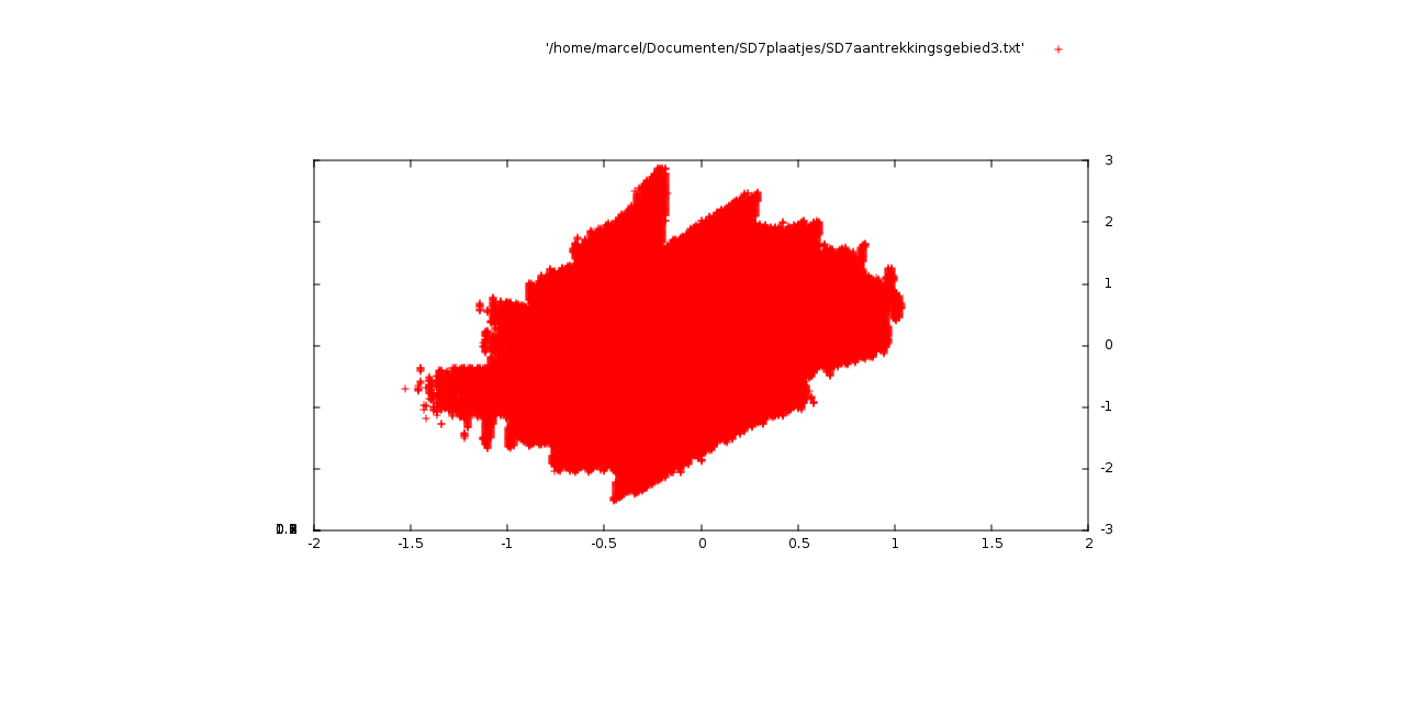

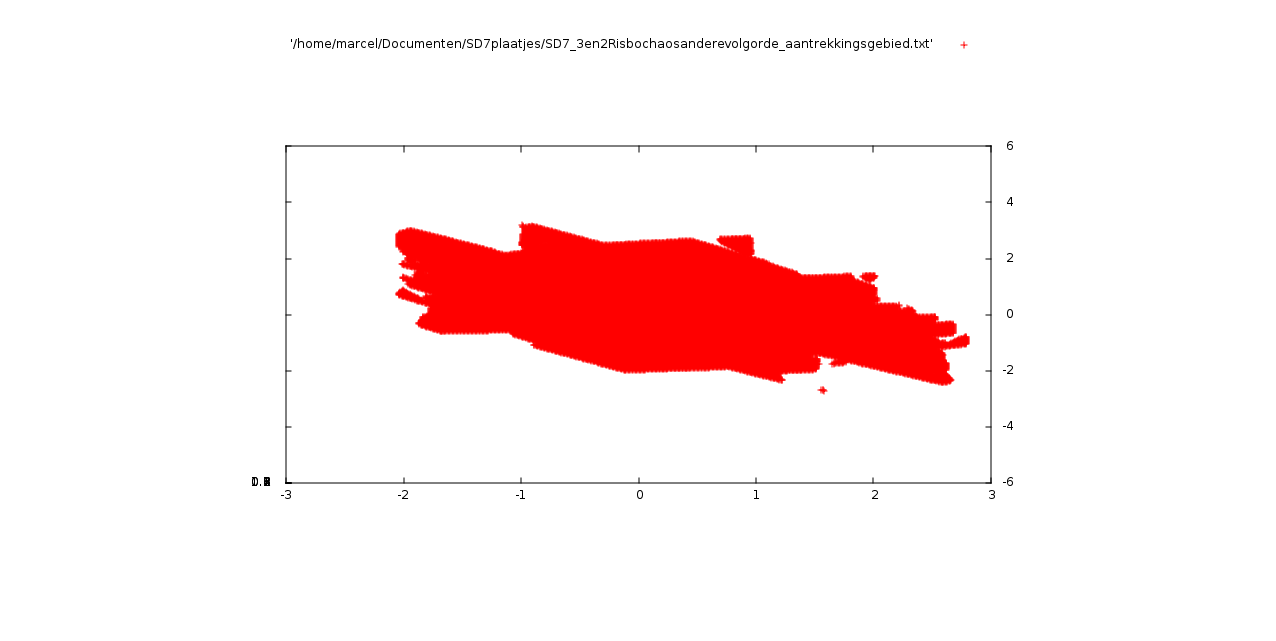

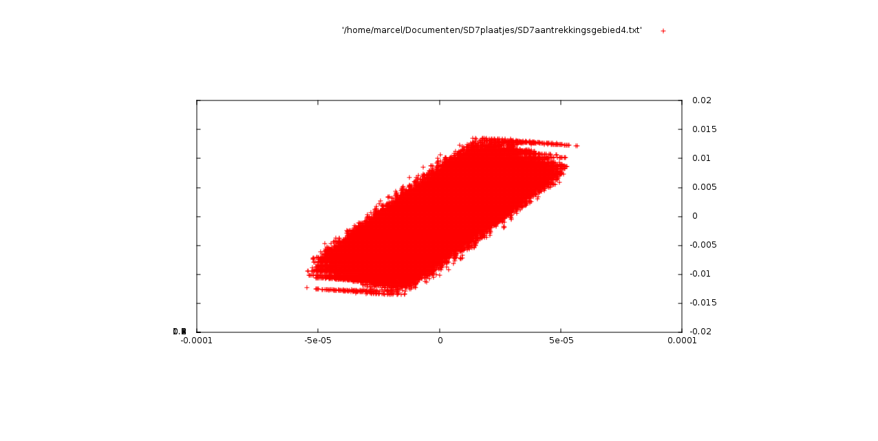

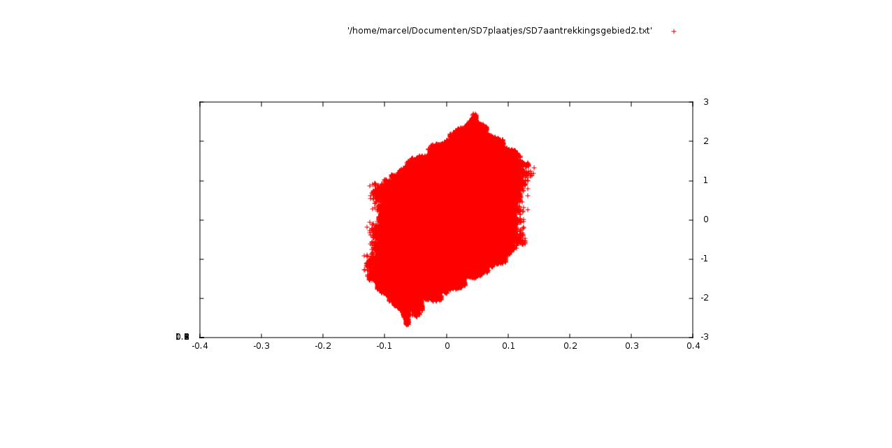

Just out of curiosity I've plotted some intersections of the basin of attraction of the seventh-order chaotic sigma-delta (with clippers switched off). Its basin of attraction is a seven-dimensional figure defined by all combinations of integrator start values that do not result in instability.
These plots have no practical use as far as I know, but I knew from Lars Risbo's PhD thesis that they can be very pretty. My plots are not nearly as pretty as Risbo's, though.
