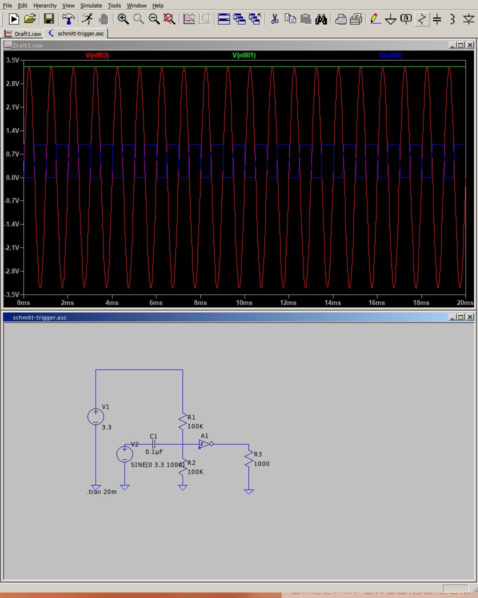

Just one thing these 2 x 100K resistors (at the inputs of inverters) attenuate signal? Or they are bus holders?

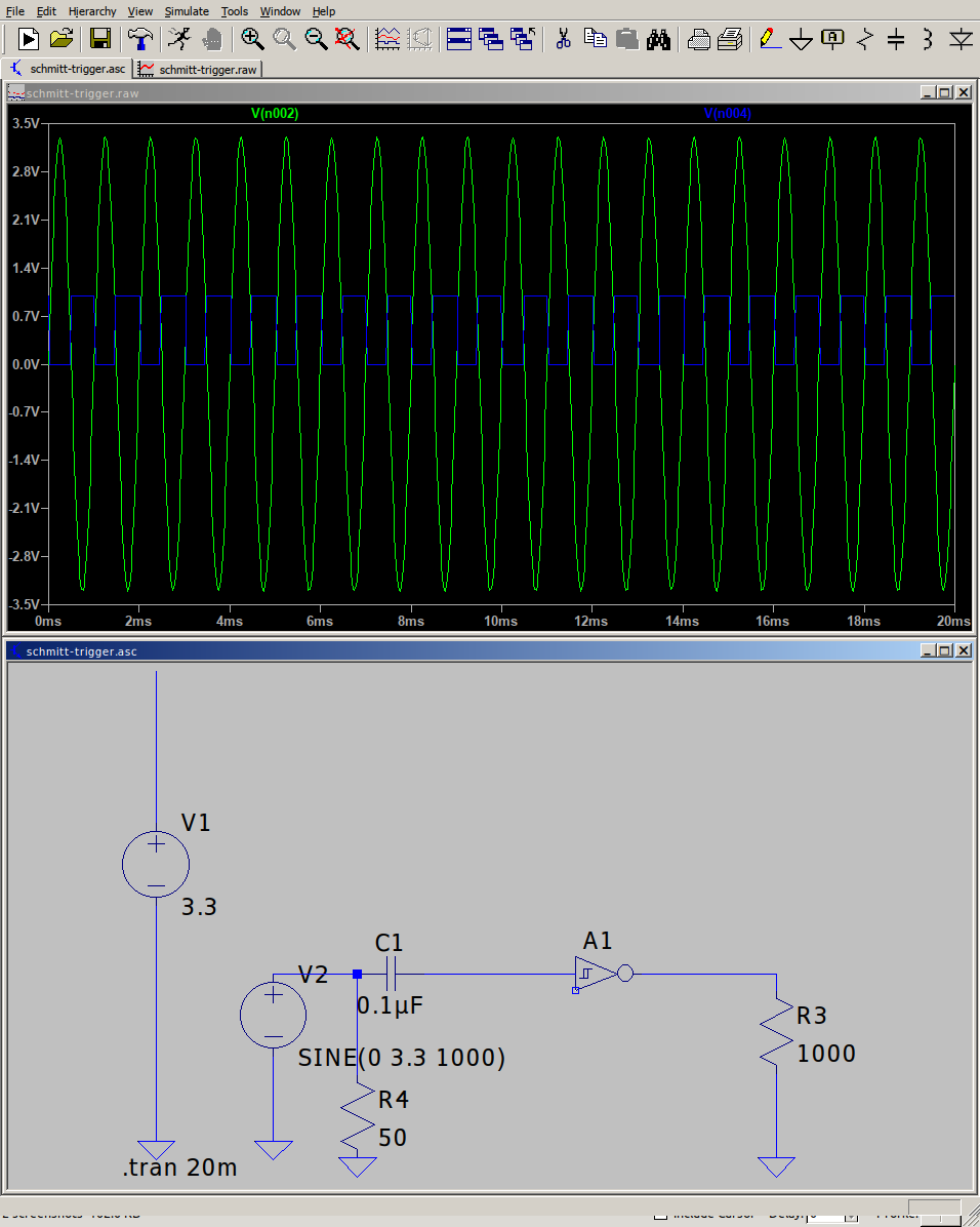

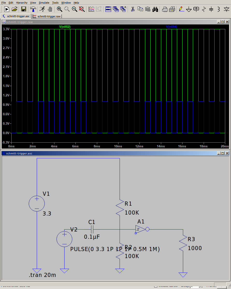

I think they are just basic voltage divider to ensure that signal swings from the middle. I LT-spiced the circuit with 10K and without them. The sim result is the same. Maybe they are not needed. I got the idea from here
