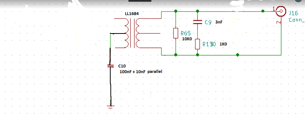

Marcel, I've decided to keep the output stage along the lines of your design and have dropped the idea of using the BCF valve stage, however, for my build I plan to use Lundahl LL1684 transformers instead of the Jensens; I already have some and will be using them in my Signalyst DSC2 decoder too (ppy's DSC 2.5.2 boards).
Do I need to make any changes to your filter schematics to use the LL1684s - I've attached the datasheet for info.
Oh, and I will be using the LL1684s to convert to balanced to SE output. I've attached a sketch of ppy's Signalyst DSC2 transformer configuration for the LL1684s.

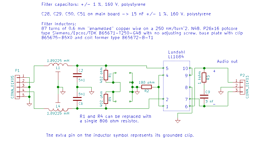

I would connect them as shown in the attachments. I've drawn the third-order variant (and only a single channel), but everything to the left of R1 and R4 simply stays as is, so you can figure out what the fifth-order version should look like.
You can connect the output to either a balanced or an unbalanced load, in the latter case the negative signal pin has to be grounded (preferably at the load). The same holds for the versions with Jensen transformers.
Assuming you refer to the DSD-only variant: for the SMD parts near the inputs, I assume that everything is electrically small and can simply be connected to a buffer output with short wires.
The clock lines to the 74AHCT74s that run on -132 V/-137 V, clock5 and clockn5, are simple source-terminated microstrip lines. They are tapped of for the 74AHCT74 that is closest to the buffer, so this one will first see a 2.5 V step and then another 2.5 V step when the reflected wave gets back. It is a bit inelegant, but the timing should be OK no matter whether the flip-flop triggers on the first or the second step. The clock input of the 74AHCT74 is a Schmitt trigger input, so there is no risk of it oscillating either.
The clock lines clock and clockn to the E88CCs are source-terminated 42 ohm lines that are split into two 84 ohm lines in the middle between the E88CCs.
U9 and U10 are clocked on the opposite clock edge from U6, because otherwise there could be hold time violations due to the delay of U5 and U8 (or U7). clock5 and clockn5 are delayed with respect to clock and clockn, so that the data coming from the 74AHCT74 will always switch when the E88CC it drives has no tail current (RTZ action).
Does this answer the question?
