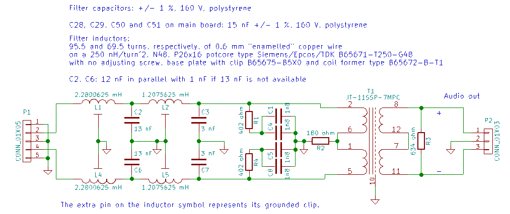

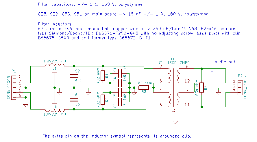

Attached are two suggested filter schematics with transformers for the raw-DSD version. I've drawn only one channel, the other is obviously the same.
The first is a third-order Butterworth at 42.9 kHz, the second a fifth-order Butterworth at 45 kHz. The first has a nicer-looking step response than the second, but worse suppression of out-of-band quantization noise. Out-of-band quantization noise may intermodulate in the amplifier and raise the in-band noise floor. Like I wrote this morning, I don't really know which one is most suitable.
Note that for the third-order filter, the termination impedance and the number of turns on the potcores are slightly different from what I wrote earlier.

Indeed, and by lucky coincidence, both require 15 nF filter capacitors on the main board.
Yes, I saw that - lucky indeed!

Could I ask why you choose 3rd & 5th order filters and why have different cutoff frequency?
The output signal of the E88CCs is a current, with low frequency components that represent the desired audio signal and with a lot of high-frequency quantization noise. To minimize crosstalk and/or voltage compliance issues, the high-frequency quantization noise should be shorted to ground. Hence, the filter has to start with a capacitor rather than a coil.
Not counting the DC blocking capacitors, the filter is essentially a C-L-C-L-... structure with a termination resistor at its end. As capacitors are much cheaper than the potcores, it is attractive to take an odd order: for example, going from fourth to fifth only requires extra capacitors, no extra potcores.
As far as I recall, the sigma-delta originally proposed by Sony for DSD64 has fifth-order noise shaping. Its quantization noise density goes up very fast just above 20 kHz, then changes into a fifth-order upward slope and eventually levels off. I don't remember exactly where it levels off, but it must be around 100 kHz or so.
A fifth-order Butterworth filter at 45 kHz will then just be sufficient to stop the density of the filtered noise from continuing to rise above 45 kHz. Instead, the filtered noise will level off around 45 kHz and start to drop above 100 kHz or so. Hence my choice for fifth order. (In the original valve DAC I even used a sixth order +/-0.05 degrees linear phase filter, but those have such a gradual roll-off that fifth-order Butterworth actually gives a better suppression of out-of-band quantization noise than sixth-order +/-0.05 degrees linear phase - and the phase response of a 45 kHz Butterworth filter is not bad at all up to 20 kHz.)
Still, most people on the noDAC thread seem to be satisfied with lower filter orders, and lower order filters do have a better transient response. Hence the third-order filter proposal. With this filter, the out-of-band quantization noise density will keep on rising gradually up to 100 kHz or whatever it may be and then drops.
The reason for the slightly different cut-off frequencies is related to rounding to E24 values - I just wanted something between 40 kHz and 50 kHz and tweaked the frequencies slightly until the values of the capacitors were as close as possible to E24 standard values.
