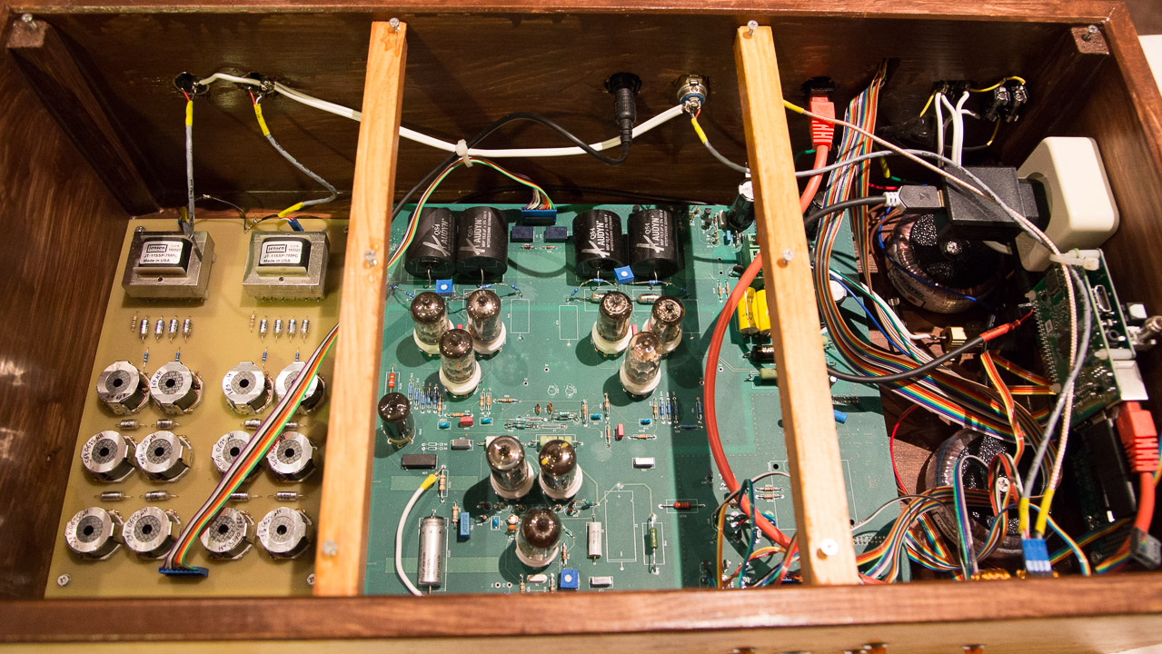

I have previously used a BCF in a conventional DAC project (AK4490 based) and it performed very well. Somewhere I have the manual for it, which isn't in the public domain as far as I know, let me dig it out...
I think you will need a bit more filtering than the first-order filtering that the BCF2 provides. You could try something like this:
-Place the 10 uF capacitors on the valve DAC main board
-Change the 8.2 nF capacitors into 10 nF each.
-Connect 390 ohm or 392 ohm from each output to ground.
-Connect the BCF2.
This will give you a cascade of two first-order low-pass filters.
Alternatively, you could make the balanced LC filter I wrote about in an earlier post and connect its output to the BCF2. That will give you better out-of-band noise suppression, flatter magnitude response and more phase shift.
In either case, you will still need the BCF2's input DC blocker capacitors to get the upper valve to bias correctly, and for proper balance you then also need to place the ones for the bottom valve.
-Connect the BCF2.
Thanks Marcel. I was planning on using the filter you posted about previously as I know the first order included on the BCF board isn't really sufficient. There's lots to do before I get anywhere near putting a BCF together though, little things like getting the DAC board assembled and tested!

This is what the inside looks like - photo made by Piet Blaas of the NVHR (Dutch historical radio association).
