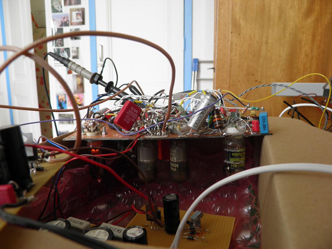

Attached are two pictures of my first prototype, which got its data from a makeshift analogue sigma-delta modulator built on a piece of perfboard. This was just to try it, as I could only go from analogue to digital and back to analogue with it. It worked, apart from some crystal oscillator issues, and music played though it sounded OK, but I did hear some soft background hiss and the hiss got worse by 10 dB or so when I touched the insulating sleeve of the coaxial cable that goes from the sigma-delta to the DAC. Clearly the noise floor was determined by the layout/crosstalk rather than the circuit. I didn't bother doing any noise measurements on this version.
Trying to reduce crosstalk as much as I could, I later went for the well-known four-layer board for the final circuit, with a ground and a -300 V plane as shields between digital and analogue/mixed signal. I made some mistakes, though, which initially led to a rather disappointing noise floor, just below -70 dB(A) if I remember well. After debugging, I got the -85.76 dB(A) and -91.29 dB(A) figures quoted in the article using the PWM8 algorithm. These are poor values compared to most solid-state DACs (as was to be expected with such a relatively simple circuit), but in practice they are good enough for me not to hear any hiss.
My guess is that your two-layer version will end up somewhere in between these two extremes, I can't predict where though. The fact that the clock and clockn lines are driven from a much lower impedance than in the original will definitely help.

By the way, you will have to use at least 2.5 mm of clearance between ground plane and any traces/holes that are close to the negative supply because of the voltages and the fact that the ground plane will be on an outer layer (which can get dirty, unlike inner layers - of course there is solder mask, but that can easily get damaged).
To keep the board from bending during production, you will also have to put ground fill on the other side, again with enough clearance. If there are any traces on the bottom side, cutting gaps in the ground plane, it is advisable to put vias on both sides of them so return currents that want to flow through the ground plane but can't because of the gap can switch to the top ground fill and back to the bottom ground plane.
