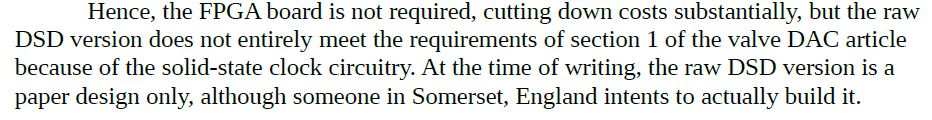

Please see the attachments for my raw DSD PCB design. The files are meant for a four-layer board process with prepreg layers of about 360 um thick (like Eurocircuits proto). I'll write a more extensive explanation after sleeping.

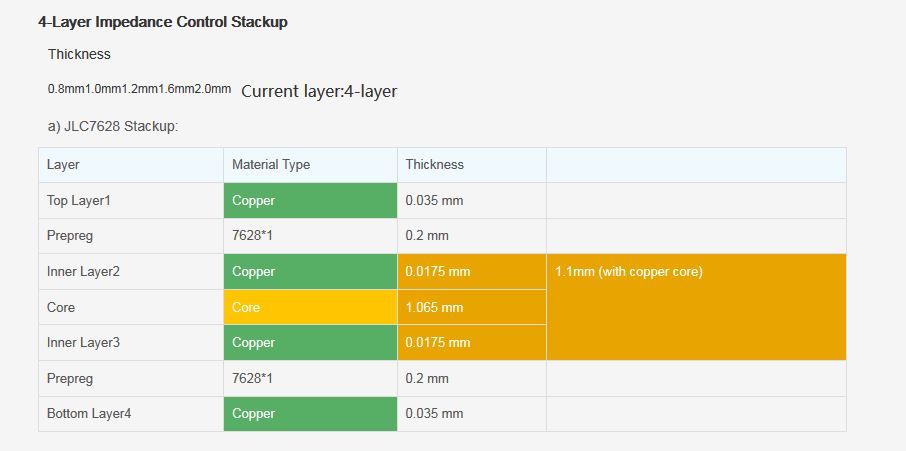

I've been costing up PCBs from JLCPCB, they're significantly cheaper than the Eurocircuits prototype service even if I specify a 2mm thick board to mitigate the PCB flexing when inserting/extracting valves from their sockets.
What i have noticed though is that JLC's copper layers seem to be reversed compared with eurocircuits, here's the info on the JLC layers;

What's reversed about it? It is copper-prepreg-copper-core-copper-prepreg-copper, just like Eurocircuits except that their prepreg is considerably thinner.
With Eurocircuits the inner copper is thicker than the outer, with JLC the inner copper is thinner than the outer.

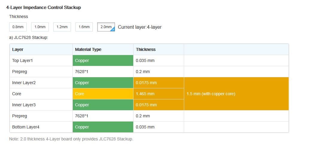

I noticed the pre-preg difference - the core layer of the JLC board is 1mm thick compared with 0.7mm for eurocircuits - outside of the core, the JLC uses 1 layer of PPR7628 pre-preg compared with two layers for eurocircuits, but with a 2mm thick board from JLC I believe it will also have 2 layers of the pre-preg.
That would be nice, because then I don't have to change the microstrip lines or to check whether 200 um prepreg thickness is enough for 400 V.
I'll contact JLC to try and confirm that the 2mm PCB has two layers of the pre-preg.
Can I assume that the copper thicknesses being reversed doesn't concern you?

I found the answer and I was mistaken, the 2mm thick PCB just has a thicker core layer and only a single layer of the pre-preg between the inner and outer coppers.I'll contact JLC to try and confirm that the 2mm PCB has two layers of the pre-preg.
In principle a single layer of prepreg should easily be able to handle 300 to 400 V. That does not take into account possible voids, though. With a double prepreg layer problems due to voids are unlikely. See multi layer - High Voltage Multilayer PCB - Electrical Engineering Stack Exchange
If you want to go for a single prepreg layer of 200 um, I'll make a version with a few transmission lines made narrower. What is the narrowest line width that JLC allows?
