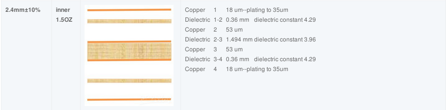

Anyway, I've also been checking out possible PCB fabricators as alternatives to EuroCircuits - I would prefer to buy in Europe but for the price on one board from them it looks as though I can get five from China and that might be sufficient to satisfy any GB interest. PCBWay say they can do a layer stack as follows;
  1. 35μm copper
  2. 180μm FR4 prepreg
  3. 180μm FR4 prepreg
  4. 1.2mm core with 35μm copper
  5. 180μm FR4 prepreg
  6. 180μm FR4 prepreg
  7. 35μm copper
but in order to provide a proper price quotation they need the layer stack specified in the gerber files. I did some quick googling and didn't find an answer on how to do it - any ideas? Perhaps it'll be better to post the question in the 'Design & Build' section.
Ray
I don't know either how to specify a custom layer stack in the Gerber files, I'll have to look into that.
By the way, have you seen their default stack-up for 2.4 mm-thick four-layer boards with 1.5 oz inner layer copper, the last of the four-layer stack-ups on PCBWay Multi-layer laminated structure - Custom PCB Prototype the Easy Way - PCBway ? It has the same prepreg thickness as Eurocircuits, although unfortunately they don't specify whether it is made up of two stacked thinner prepreg layers. It is substantially more expensive than the 1 oz inner copper version, but maybe less than a custom layer stack?

FWIW, at work, we specify all the stackup type information in a PWB drawing. The drawing and gerbers are provided to the board house when we order boards.
If we have controlled impedance traces, that should also be in the PWB drawing.
Notes to the PWB vendor will work fine for a diy project.
We use controlled impedance quite a bit. Impedance will depend on the dielectric of the actual FR4 type used, and thickness of the FR4 between the layers involved. The board house can tweak the pwb design to get 50 ohms, as long as you tell him you have 50 ohm traces. Unless you don't care if its not exactly 50 ohms. In most of my applications, I need an exact impedance match and so we work with the board house to get it.
Randy
Hi Marcel. I got a price for boards with the custom layer stack from PCBway - 350USD for five boards (plus shipping if I'm reading things correctly so I guess nearer to 400USD).
In the absence of anyone else being interested (I've had no response to my previous post asking for expressions of interest), should I choose to go with your board I will probably have to go with EuroCircuits.
