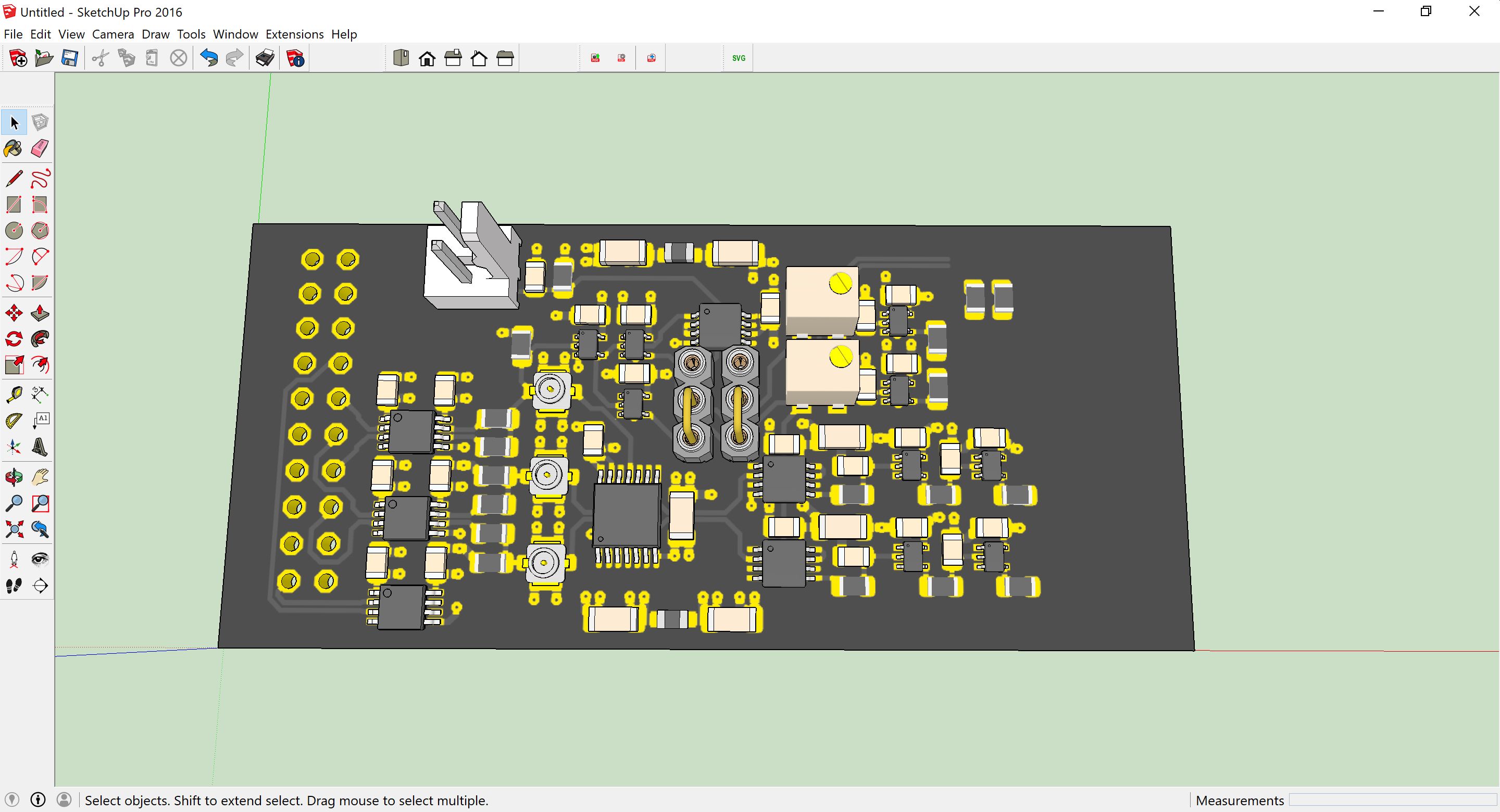

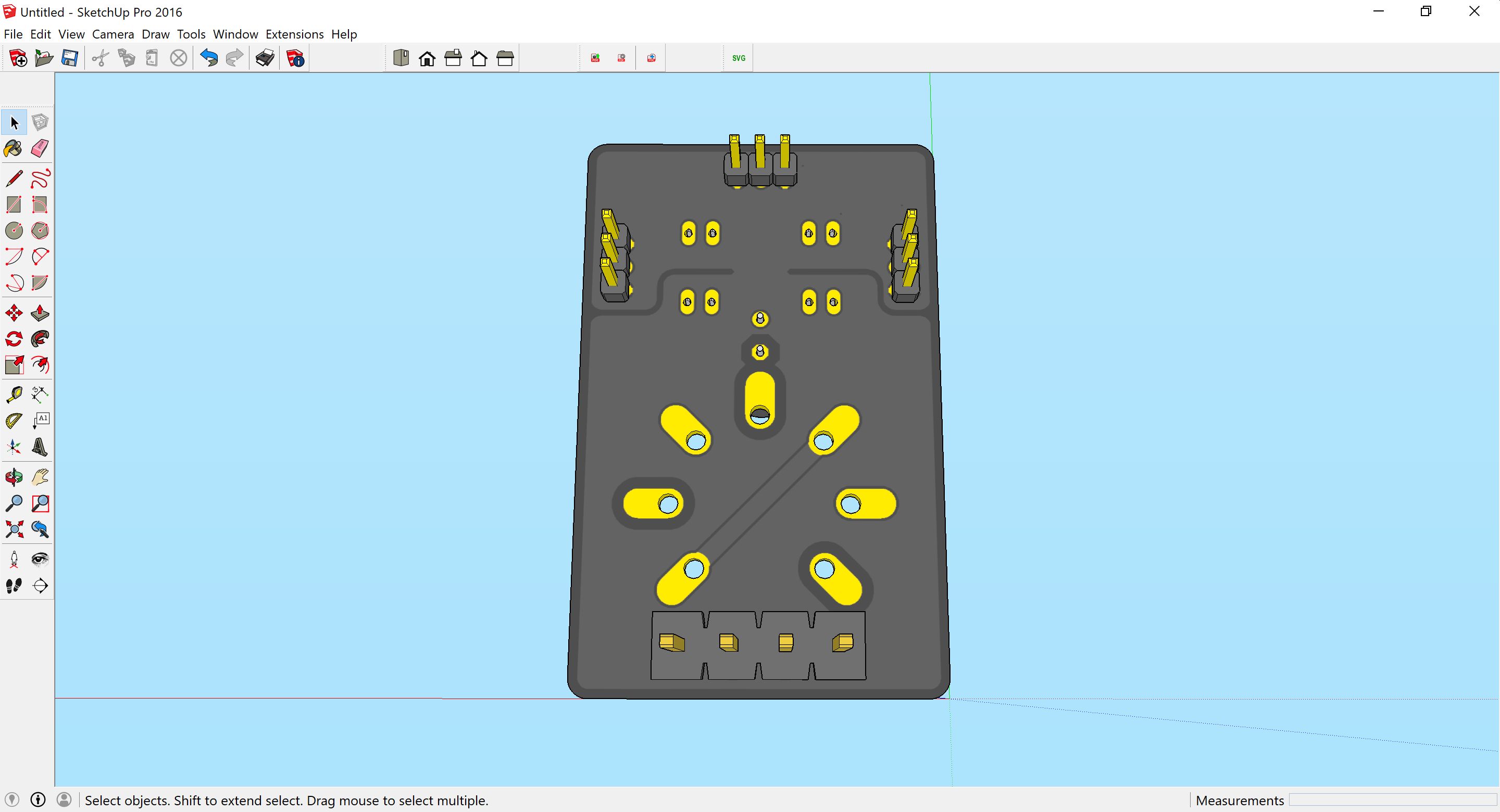

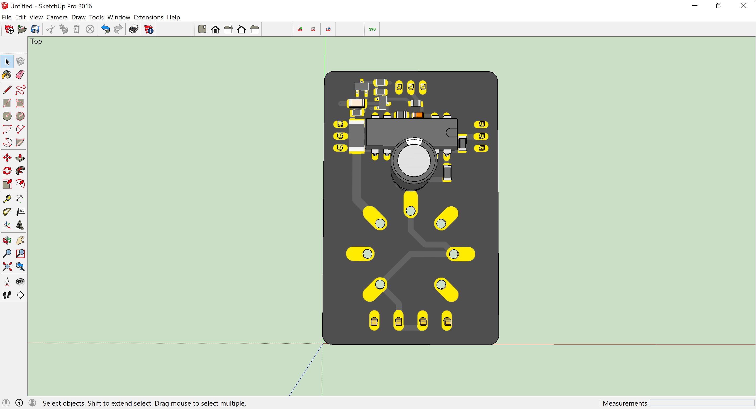

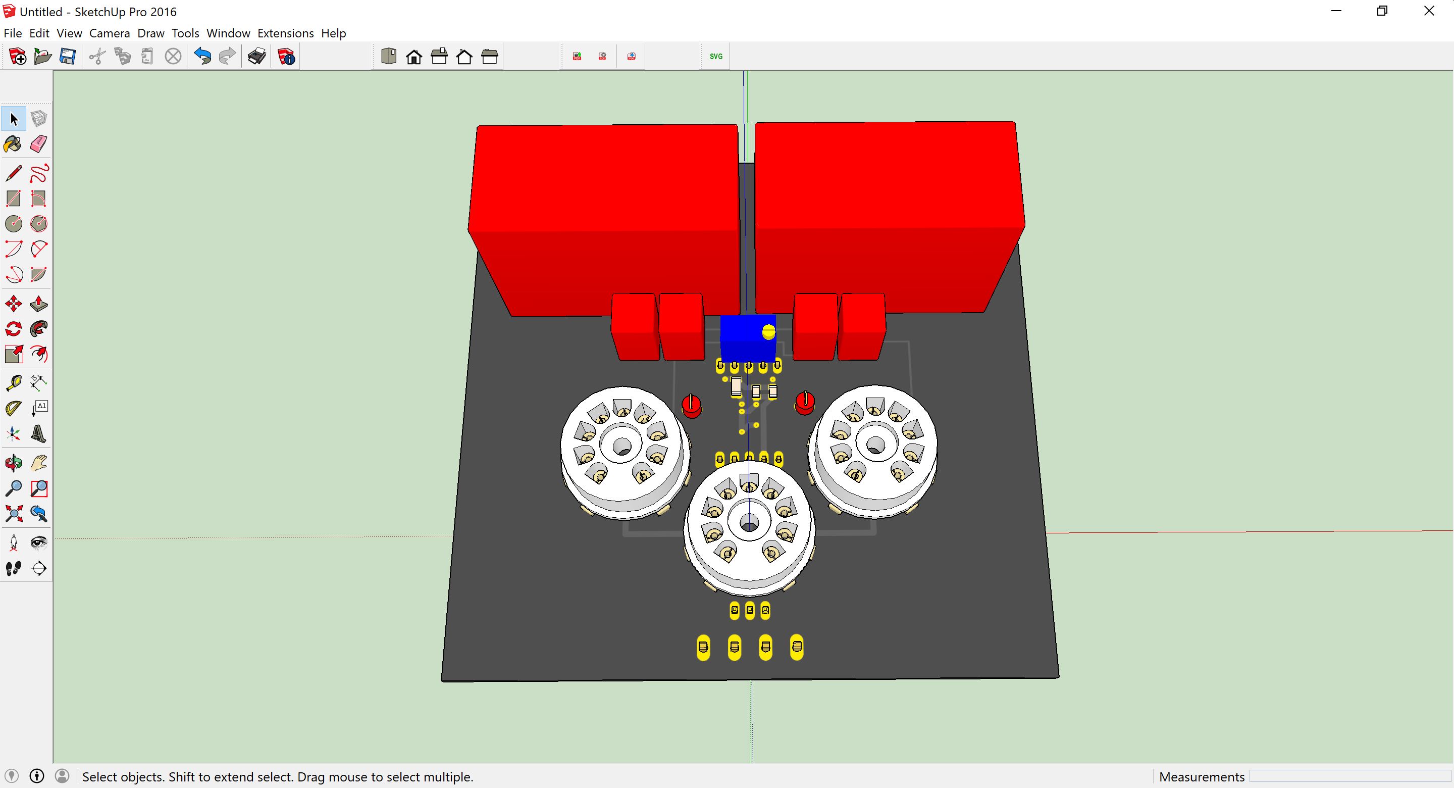

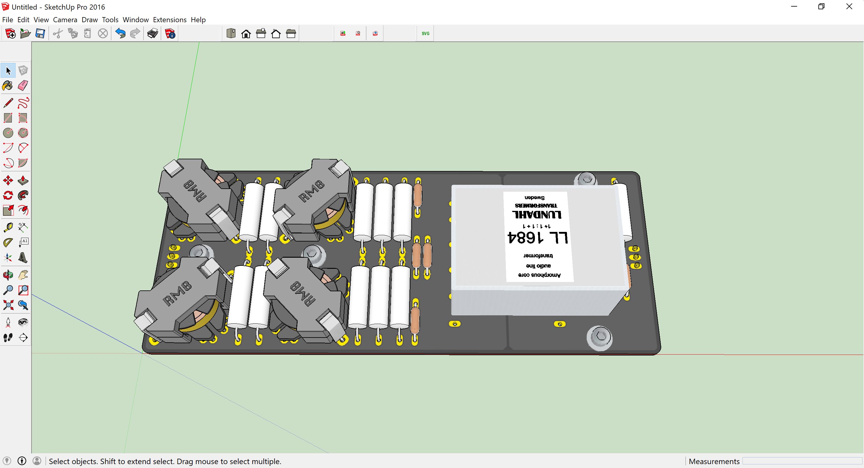

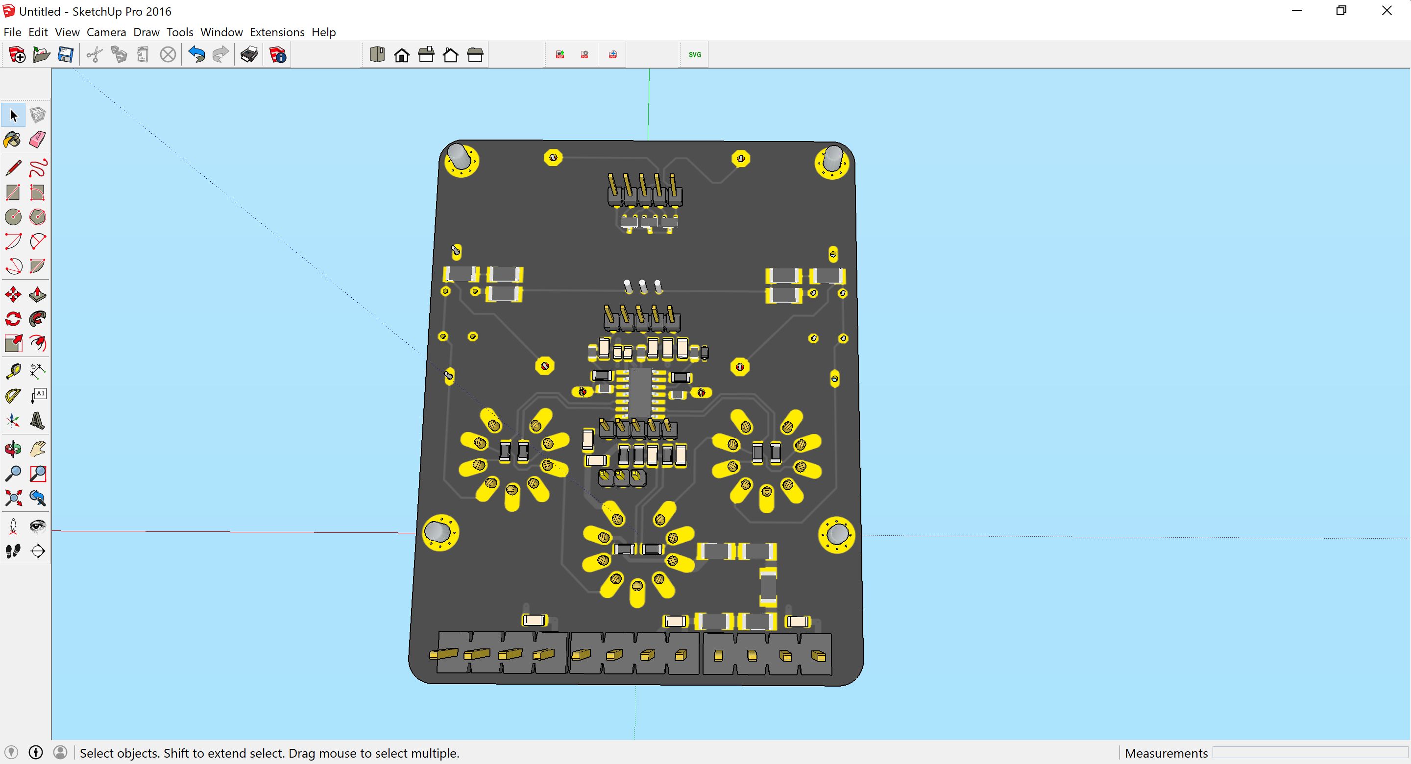

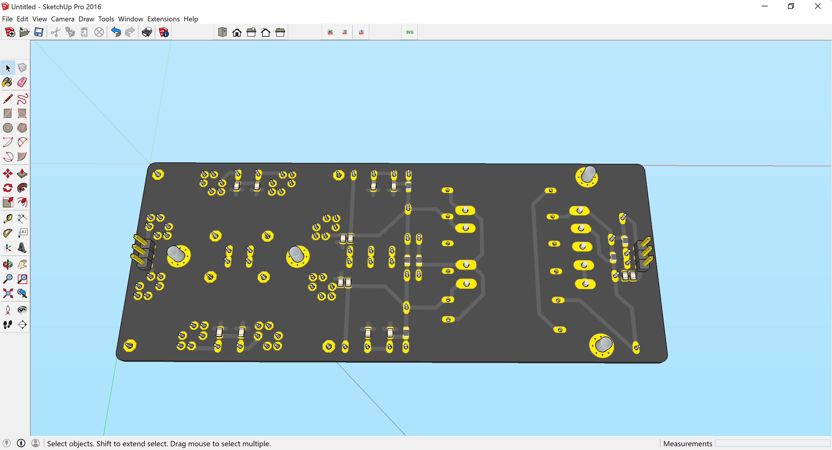

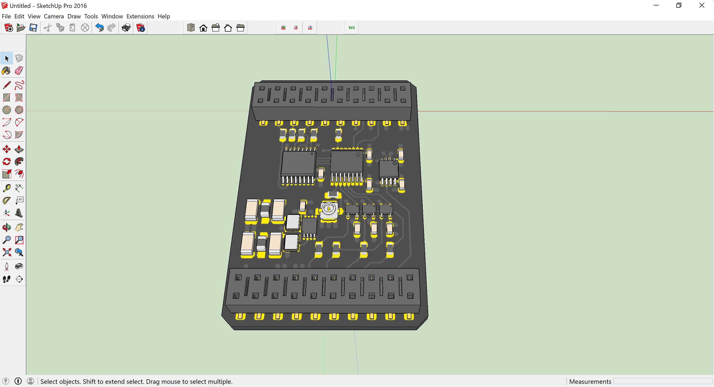

Hello Marcel and Ray,
some 3D views:
- FILTER board (RM8 custom Don audio; 2 layers)
- REF board (still need Pico socket and 85A2 3D models; 2 layers)
- DAC board started with routing (4 layers)
JP

Looks very nice! Are the creepage distances for the DAC board sufficient?

Looking good JP.
The Don Audio inductors look like a good find.
I still think there is value in separating the output transformers from the filter boards so that different filters can be 'plugged in'?

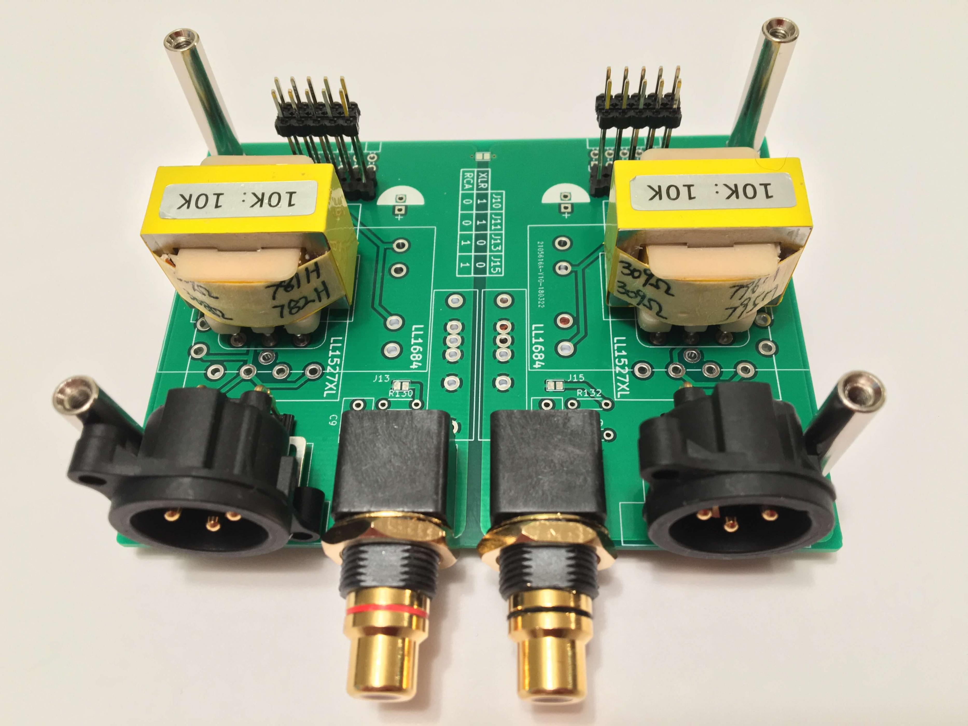

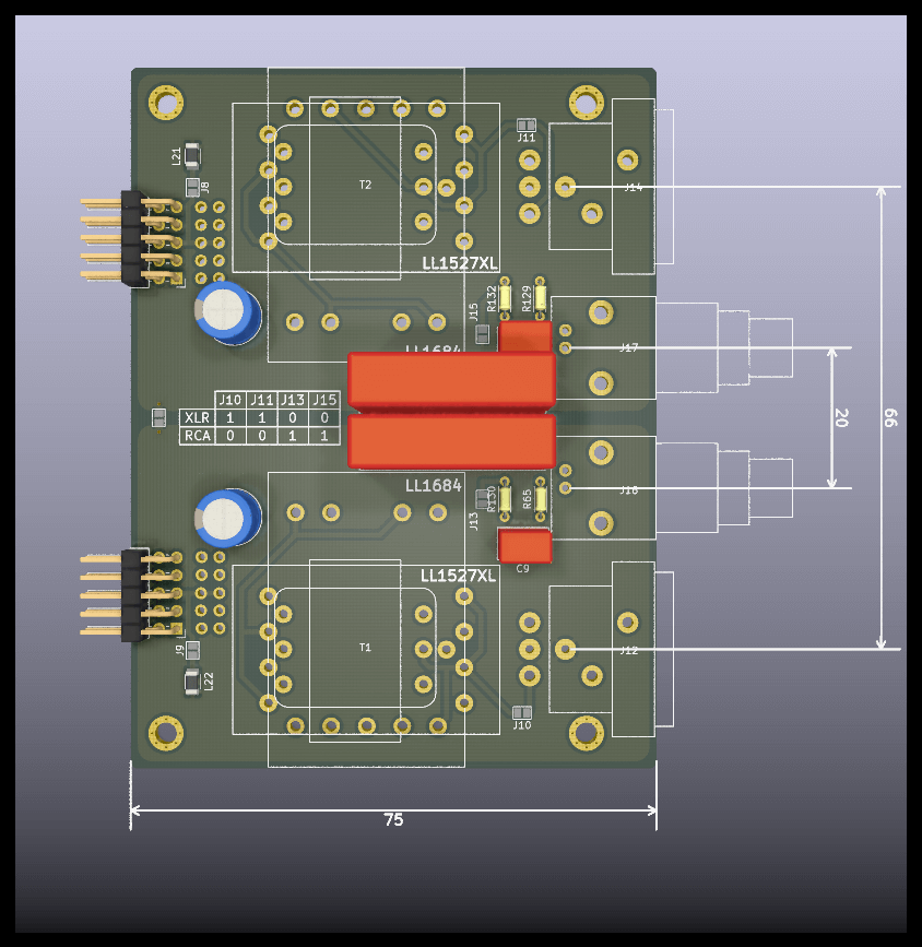

Attached are some pictures of the transformer output board for ppy's DSC2 decoder project (version 2.5.2). Very flexible and convenient - onboard output connectors, choice of transformers, choice of balanced or SE output, spaces for load components, etc - with gerber files available. I may just use this board 'as is' - thoughts?
Ray

The DSD-only filter board I´ve layouted is for JENSEN and Lundahl.
Attached DAC board (creepage constrains applied, WIMA and/or LCR polystyrene, high quality teflon PCB tube sockets), going on Beaglebone Black (with ppy´s reclocker) and COMBO384 using Marcel´s frontend.
JP

Your DAC boards are looking good JP, very neat and compact. How many layers are you using?
All of ppy's files are available on his website but I'll PM you the files that might be useful.
I appreciate that your filter board is for Jensen and Lundahl transformers - I was being selfish with looking at ppy's output board as I'll definitely use the Lundahls.
I don't know if there is a datasheet for the Chinese transformers but if you think they might be a useful addition to the options I'm happy to try and track them down on taobao and see what information is available?
Regarding ppy's transformer output board, I think getting some of them fabricated is my fallback/default position unless you are willing to design separate filter and transformer boards that will plug together? Mono boards would be great as would having the output sockets on the transformer boards? I was going to design some boards myself but if you're willing to do it, and with your far superior skills/experience, there seems little point.
Ray
