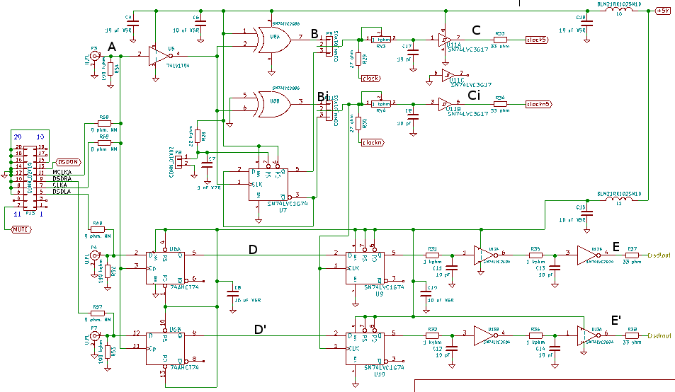

I still had to post the expected timing for the data and clock input section. Referring to the attached picture, this is what I calculated (with the SN74LVC2G86 connected, so without the clock division):
From A to B and Bi: 3.4 ns to 8.6 ns of delay, B in phase with A and Bi in antiphase
From A to D: data clocked in at the rising edge, delay between 1 ns and 9 ns
E and E': data transitions between 22.1 ns and 31.6 ns after the rising edge of Bi
C and C': rising clock edges between 1 ns and 4.1 ns after B and Bi, respectively, at minimum potmeter setting, between 10 ns and 17.3 ns after B and Bi, respectively, at maximum potmeter setting

R2 can be omitted when you connect the midpoint between R1 and R4 to ground (and the same holds with the Lundahl and the Chinese transformer).
Thanks. That's what I figured.
I'm hoping JP's reconstruction filter PCB design will become available to order some boards. If I go in that direction, the Silk TVCs will be easy to connect to the boards via their flying leads so no changes to the board layouts would be required.
