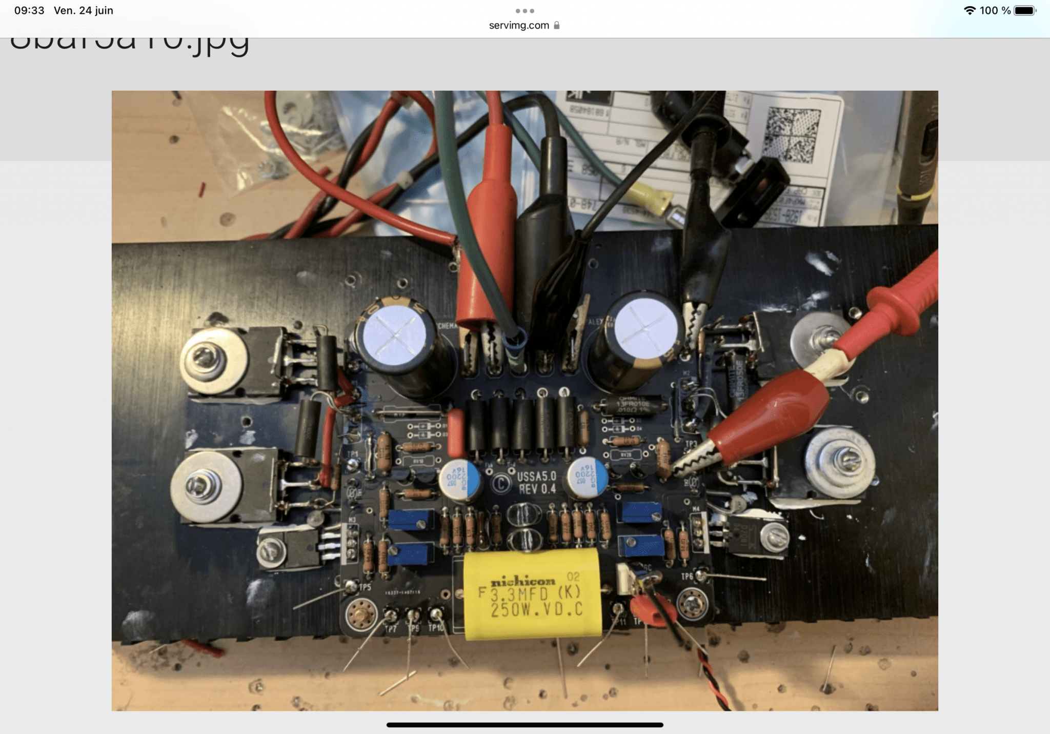

Hi nfsgameUnfortunately I can't edit my above posting. I've done a negative version and tidied it up a little bit.
nice! A few comments if I may:
1) increase size of PSU caps to populate at least 2200uf (50v or 63v). You can move source resistors closer to the top if needed.
2) marking:
A)V+ is not connected to Drain but to R source. Drain of mosfet is connected to output. Same thing for V-.
B) it could be used for a wider range. Ex: USSA and FSSA Twin Turbo extension board….
3) adding extra through holes can be used for Lateral and also Vertical mosfet and BJT. See attached picture (on the right) of my USSA-4 Mini Pcb.
Fab

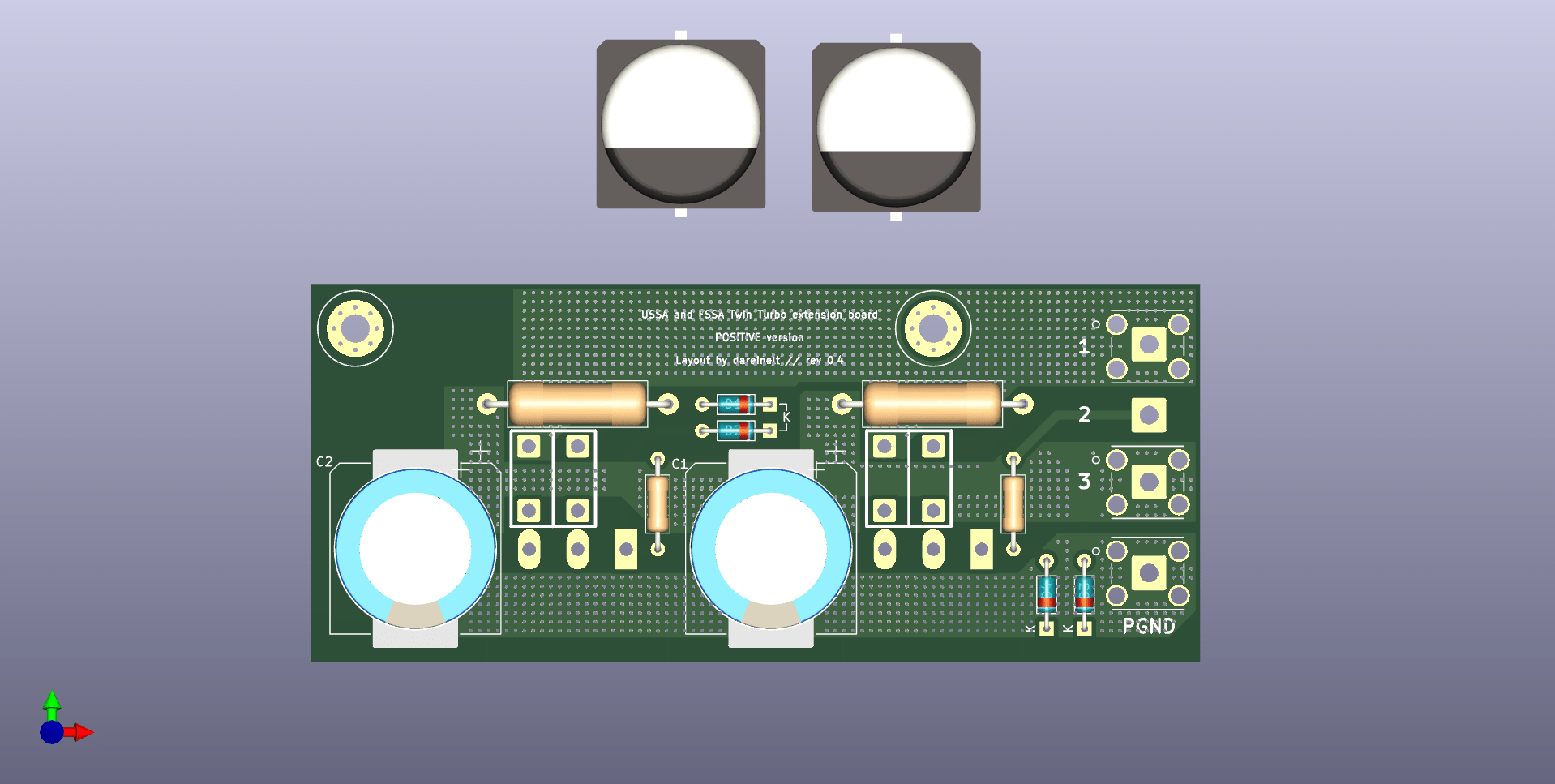

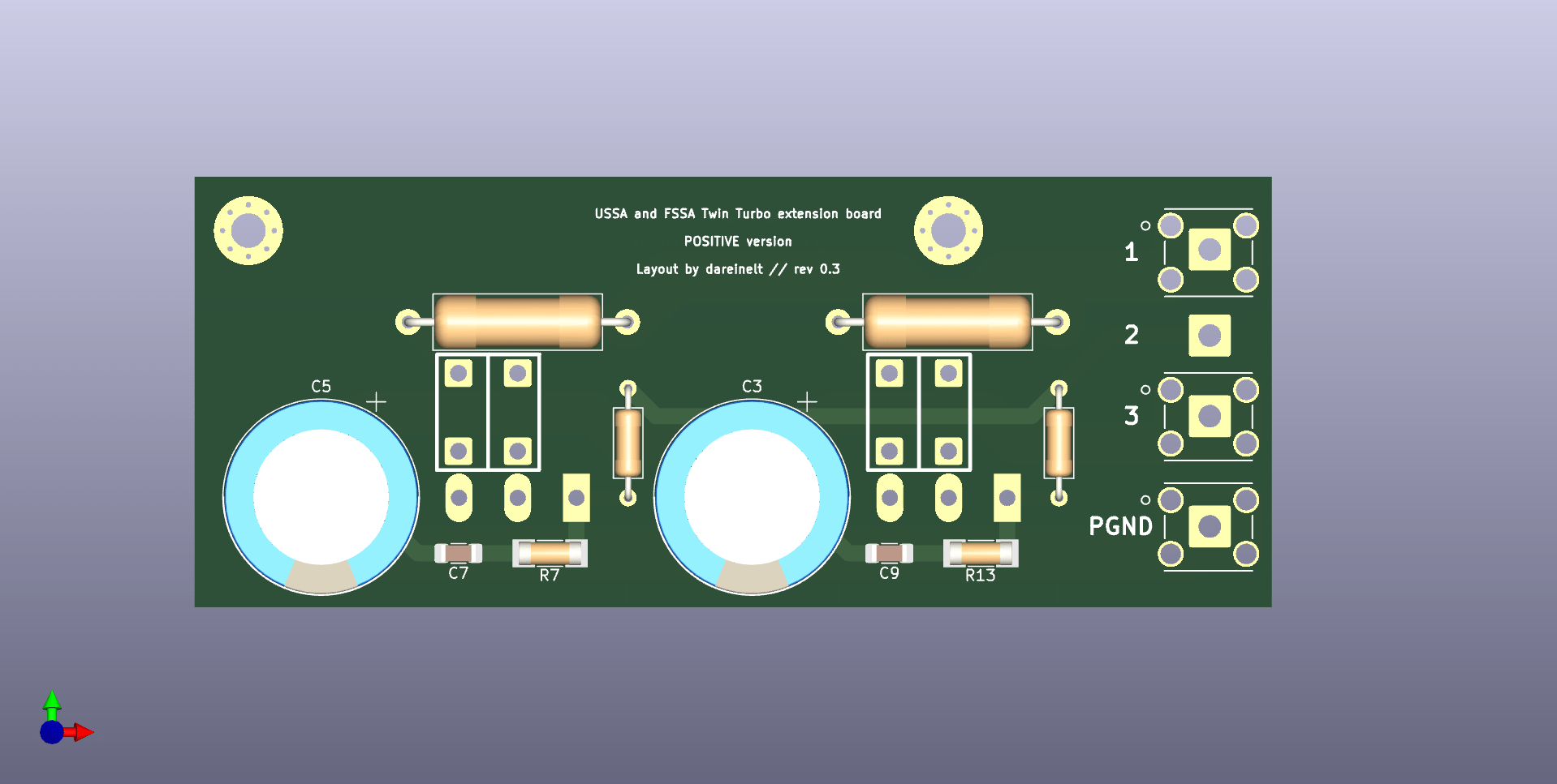

So there is Rev 0.3!
Caps are 18mm/7.5mm now so they could be Nichicon UVR 2200uF/63V, UCC GPD 2400uF/63V or something fancy like Nichicon UKZ 1000uF/50V.
Pads for switching leads are included now, snubbers went to the bottom and are surface mount now. But no reason to worry - they are MELF respective 1206. I could solder them faster and more comfortable then classic through hole parts as there are no nasty leads to cut off ...
Markings are cleaned up to be more universal as a tribute to the lead switching pads and to avoid confusion.

Hopefully it will be easier to provide instructions for as well. I don't really understand the layout of the double die - I've not seen it done... I'm not that experienced.

- Turbo version stands for higher PSU voltage for more power and in class AB (at medium to high power). This is achieved by a single package pair ( N + P) of vertical mosfet or BJT or with a single pair of « double die » package of Lateral mosfet. Double die means 2 transistors in patallel in the same package. Therefore, a single pair of double die lateral mosfet is equivalent to 2 pairs of 2SK1058/J162. for example, you can make an USSA-5.2 Turbo running at +/- 45VDC in class AB ( with medium bias) with a single pair of double die lateral mosfet.
- Twin Turbo stands for 2 pairs of vertical or BJT or double die lateral mofset. The latter is equivalent to 4 pairs of 2SK1058/J162! This is for difficult speaker loads.

One complementary pair is soldered to the amplifier pcb, the second complementary pair is attached to the heatsink and P2P wired to the amp pcb with the needed resistors and caps.
The helper boards come in Positive and Negative versions, a pair of P-channel Fets soldered to positive pcb and a pair of N-channel Fets soldered to the negative pcb. Then solder flying leads from each helper pcb to main amplifier pcb. No Fets are soldered to the main amp pcb.
Think about the FET with his two resistors as one unit. This unit is doubled now. You will wire from the "entry point" of the gate resistor on the PCB to the "entry point" of the gate resistor of the extra unit. Also wire the "exit point" of the source resistor of the extra unit to the "exit point" of the source resistor on the PCB. The drains in this example don't have any special with it. So they are simply connected with each other using a piece of wire.
The gate resistor always have to be as close to the gate pin as possible to avoid instability. There are even commercial amplifiers on the marked where the manufacturer removed a piece of the FET pin to solder the gate resistor closer to the FET entry (take a closer look at the bigger accuphase models of the early 2000s).

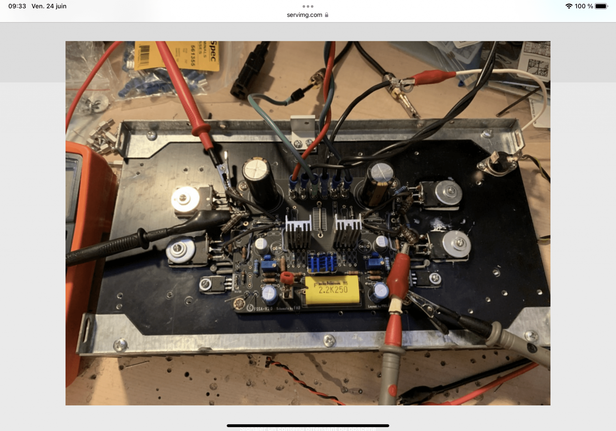

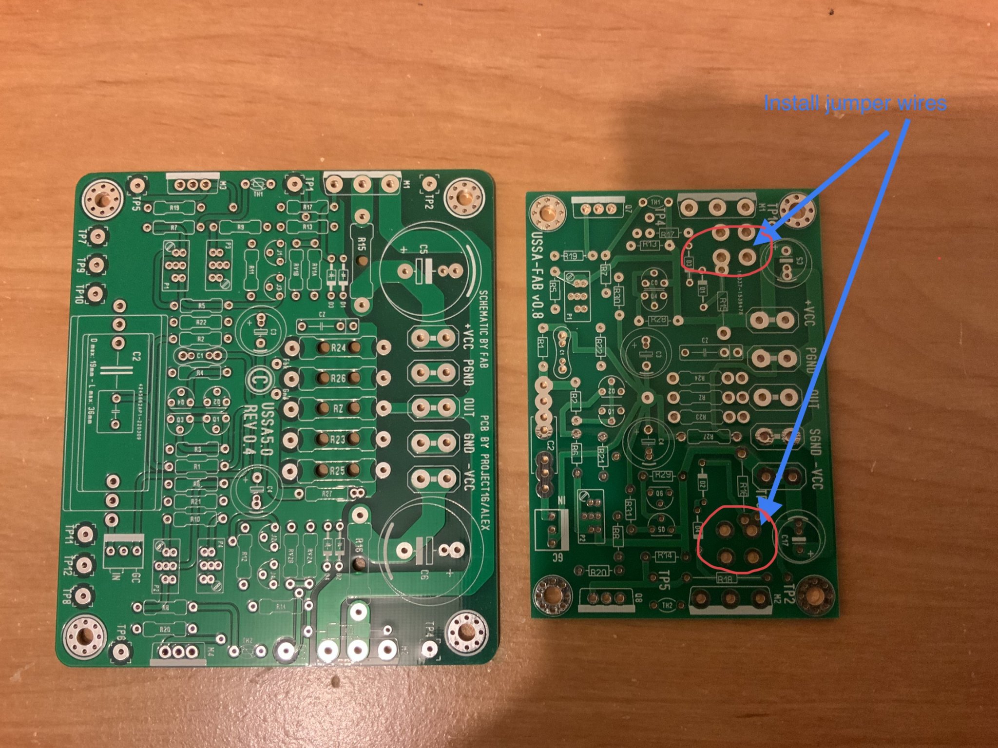

Here is what I have done for USSA-7 (FSSA pcb) and USSA-8 (USSA0cb) w/o the pcb helper.Yes sorry - so how do you arrange two pairs of ECW20N20/20P20 (which is a double die lateral mosfet) without the PCB helper?

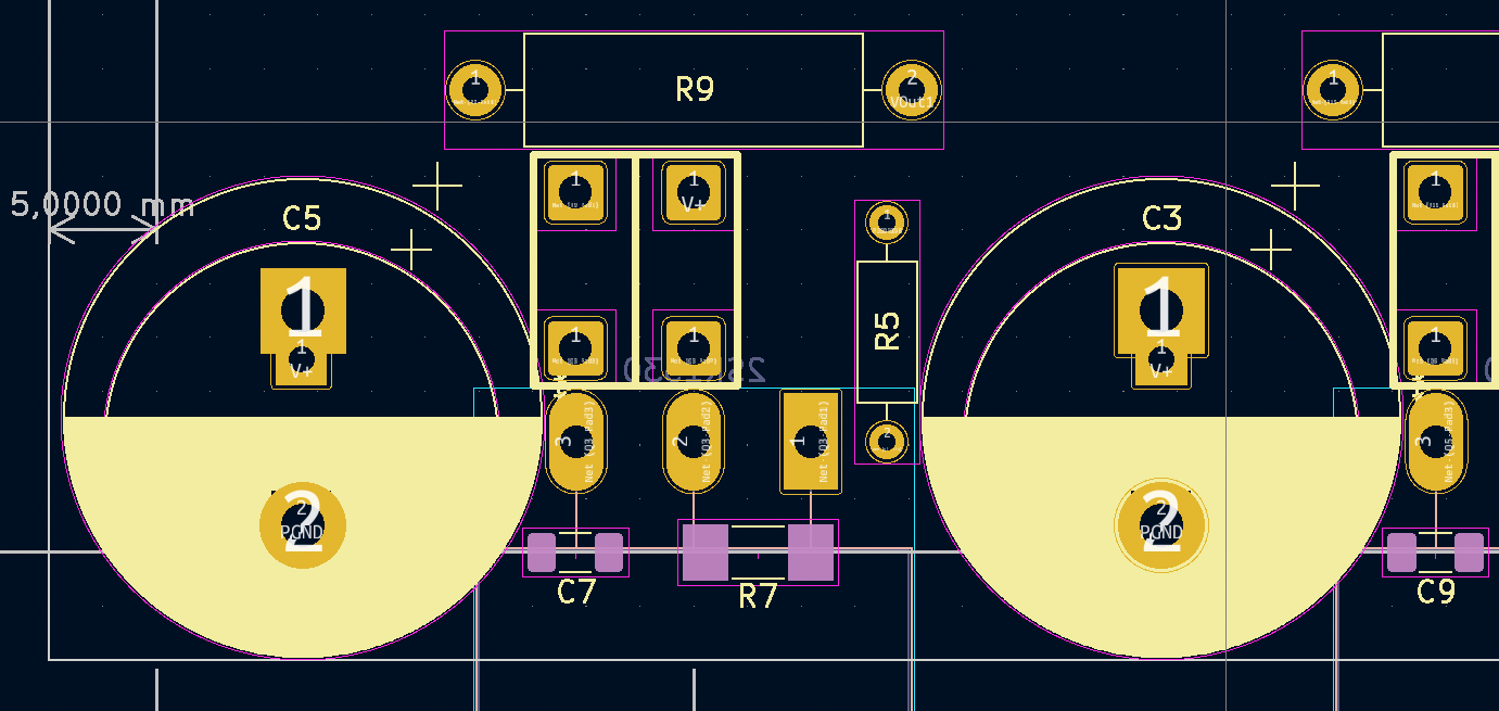

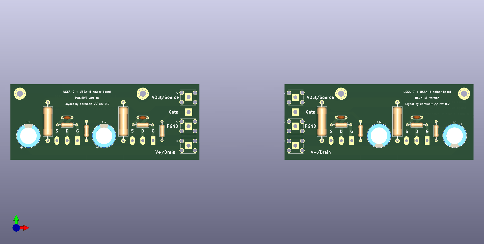

Rev 0.4 done...
- Removed snubbers until I've an idea how to place them without harming the current traces
- Current traces are now bigger and double-sided stichted-through for maximum surface area and best possible conductance
- Surfacemount pads for the big caps added as a reaction of the EOL-announcement of various TTH-cap series by Elna last week (RFS, ROA) and Nichicon today (UFW, UFG, UKL, UVR, UKW, ... 🙁) - one could now use Rubycon TRV 1500uf/50V or Vishay 146CTI 1000uf/50V or similar in the future when there is less choice for TTH-parts...
- Protection diodes added respecting fabs manual for the twin turbo versions
