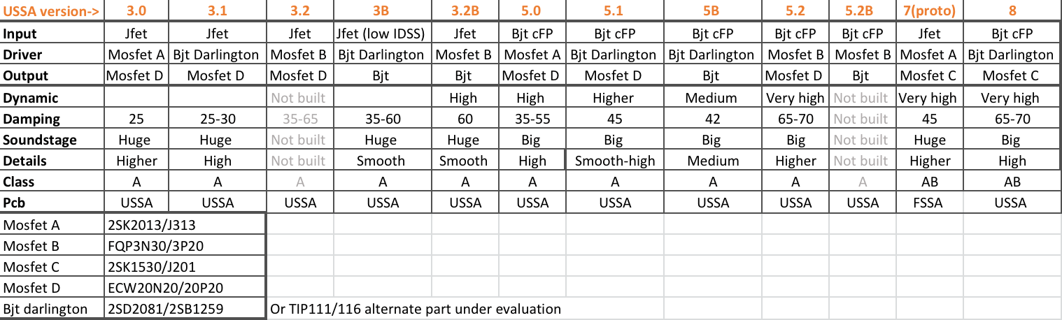

Yes single-Turbo does seem easier than waiting for the helper PCB and the added complexity. I just don't want to have regret of not having built twin-turbo 🙂
USSA 5.0 then, 36v CLC dual mono power supply, 1.2 to 1.5A bias, 4U modushop.
Or should I consider higher voltage for more class A/B?
stretchneck
Well…assuming +/-36 VDC that makes 86 to 108W steady dissipation per heatsink…
1.5A gives already min 36Wrms in full class A ( more in reality) into 8 ohms and then class AB up to maybe 60Wrms into 8 ohms in class AB (with +/-36VDC). For 4 ohms, >18W class A and about double power ( >100W) in class AB. I assume you have a big PSU.
Higher voltage gives more class AB but then less bias thus less class A…your choice.
Soundwise the USSA performs better in class A than class AB…. Higher class AB would benefit more going Twin Turbo…
My own USSA-5.2 Twin Turbo is 75Wrms / 8 ohms And about > 7Wrms in full class A / 8 ohms.
But, from reported experience, USSA 20Wrms/8 ohms class A can drive any speaker tried so far (example: kEF Reference 5 Meta) and even to high sound level in a normal size room…😉

Hello Elias
thanks for your interest in the FSSA amplifier. See this thread for more info: https://www.diyaudio.com/community/...-build-thread-with-review.350238/post-6097777
USSA type is mainly class A amplifier
FSSA is class AB amplifier
Both use different PCB.
I do not know that specific quasi complimentary amplifier you refer to. The FSSA design is quite different than this quasi design in many aspects. Both amps should sound very different in my opinion….
“huge“ mean bigger than big 😉, so wide and deep sound stage for example. This has no relation with mono or dual mono PSU which is more related to left and right channels separation. Soundstage is much more than channel separation and related to instruments separation (isolated) and position in space…. example : like a band playing in front of you where each instrument has its position and is clearly defined as opposed to a “blended” sound coming from nowhere in particular…. Some people’s report this type of sound as holographic.
