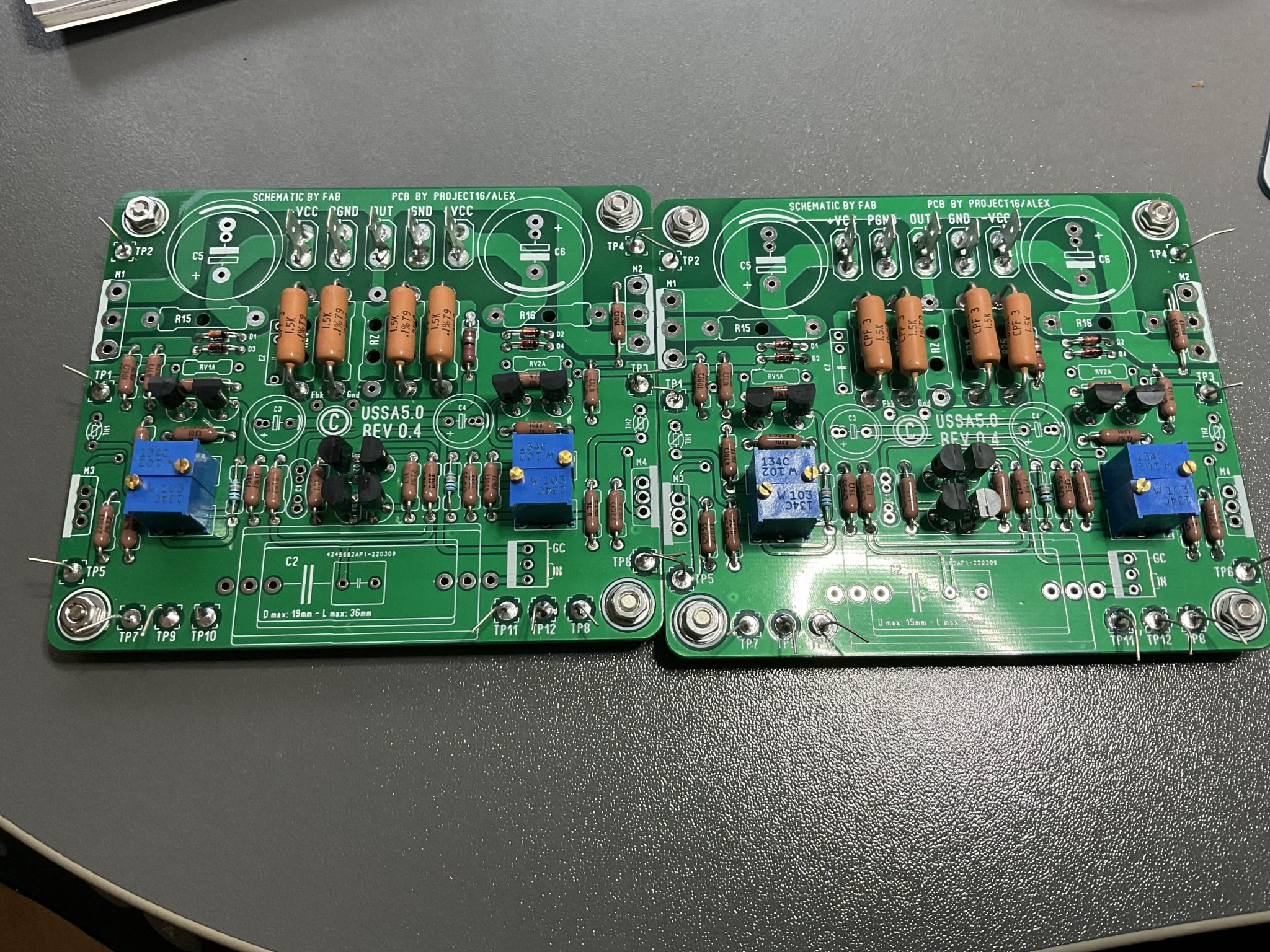

some observations or reminders:
1) potentiometer screw relative position when installed on pcb determines the resistor value direction change. In one board one for the 2 bias/dc offset pots it could be more « difficult« or not a consistent way to provide adjustment between left and right channels…
2) RV1/2 are mandatory to ensure right connection. Either use the calculated resistor value or a wire link.
good luck for the rest

Hi Nikodemuzz
good progress too!
you really should adjust the current sources before installing the mosfet drivers. The current sources jfet can have very different IDSS resulting in a very unbalanced current between positive and negative sides of circuit. This could potentially damage your drivers or output transistors (too high power dissipation) before you can even adjust the current properly. I have indicated to use a lower power supply voltage in that part of the build manual only because I thought a bench power supply was available to use instead of the real amplifier power supply - which also may not be validated.
USSA 3.0 does not need current sources since it uses input stage jfet self biasing property and the jfet are matched.
The test parts are the most interesting feature of the build manual to validate at different steps of the assembly to avoid frustration in destroying expensive parts….😢
Therefore , please adjust the current sources first…😉
and then test with the drivers and then afterwards test with output transistors- as per the manual. Then you can be a happy monkey🐵

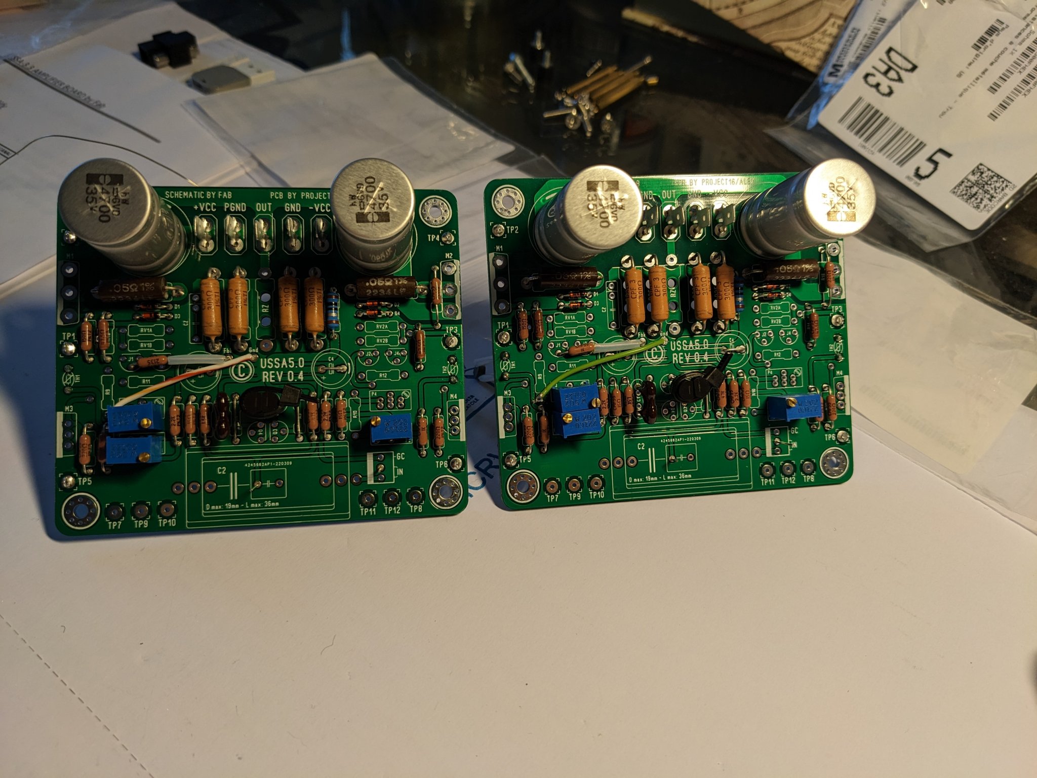

Hmm, now I'm slightly confused. By mosfet drivers you mean the Exicons? M1 and M2 in the BOM? I don't think I'm supposed to touch those until way later in the process, and I haven't. I have tried to follow the manual to the letter. Besides resistors, I have installed only the D1-4, J1-4, Q1-4 and the potentiometers.
Maybe I caused the confusion by stating that I will build first and measure later. I was referring to our earlier discussion and potentially changing some of the resistor values to accommodate the slightly higher voltage. I meant that I would complete the build and observe if there is enough voltage drop "naturally" to not need any changes.
My intention was very much to proceed with the build according to the manual, with the next step being current source adjustment. =)
