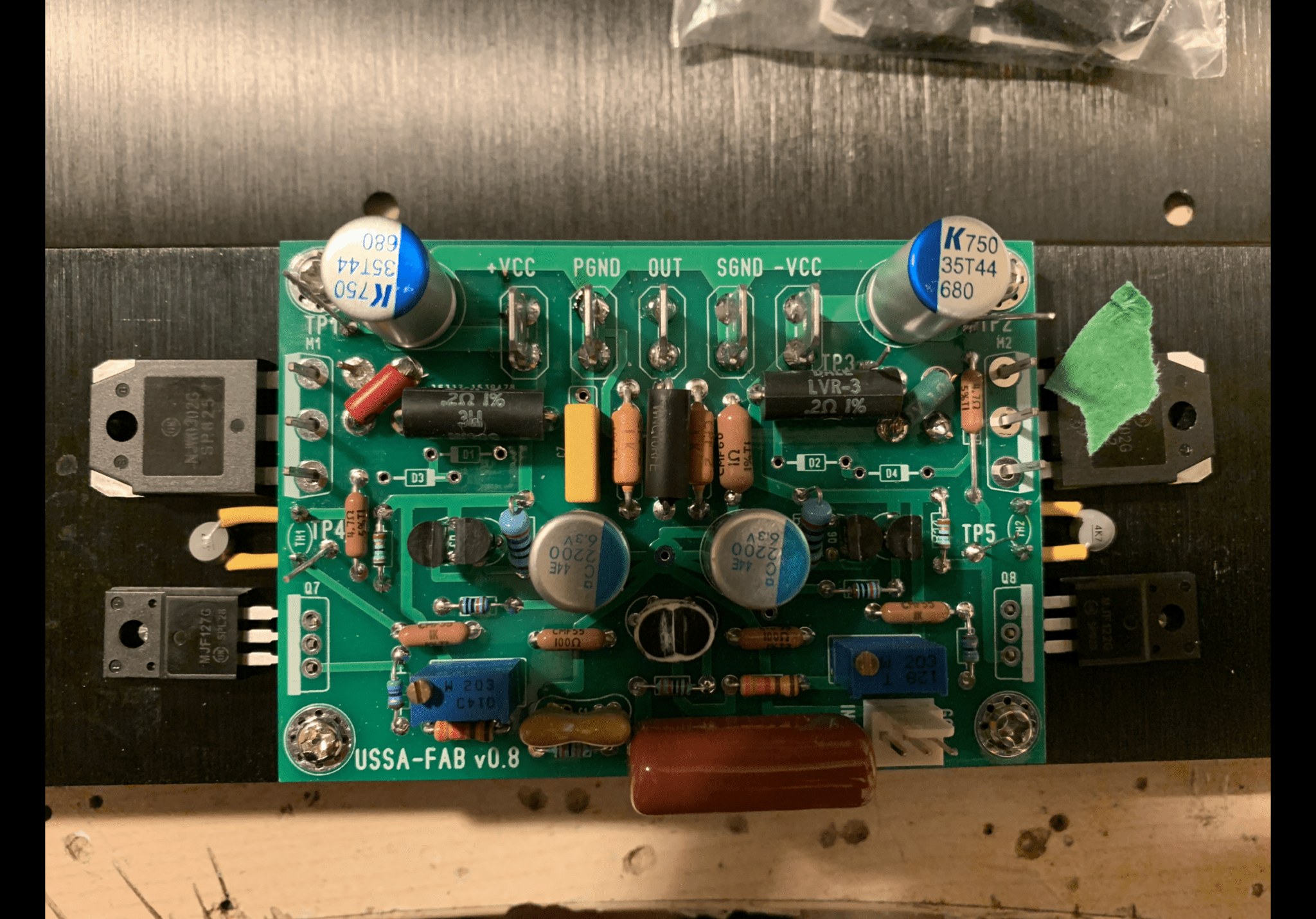

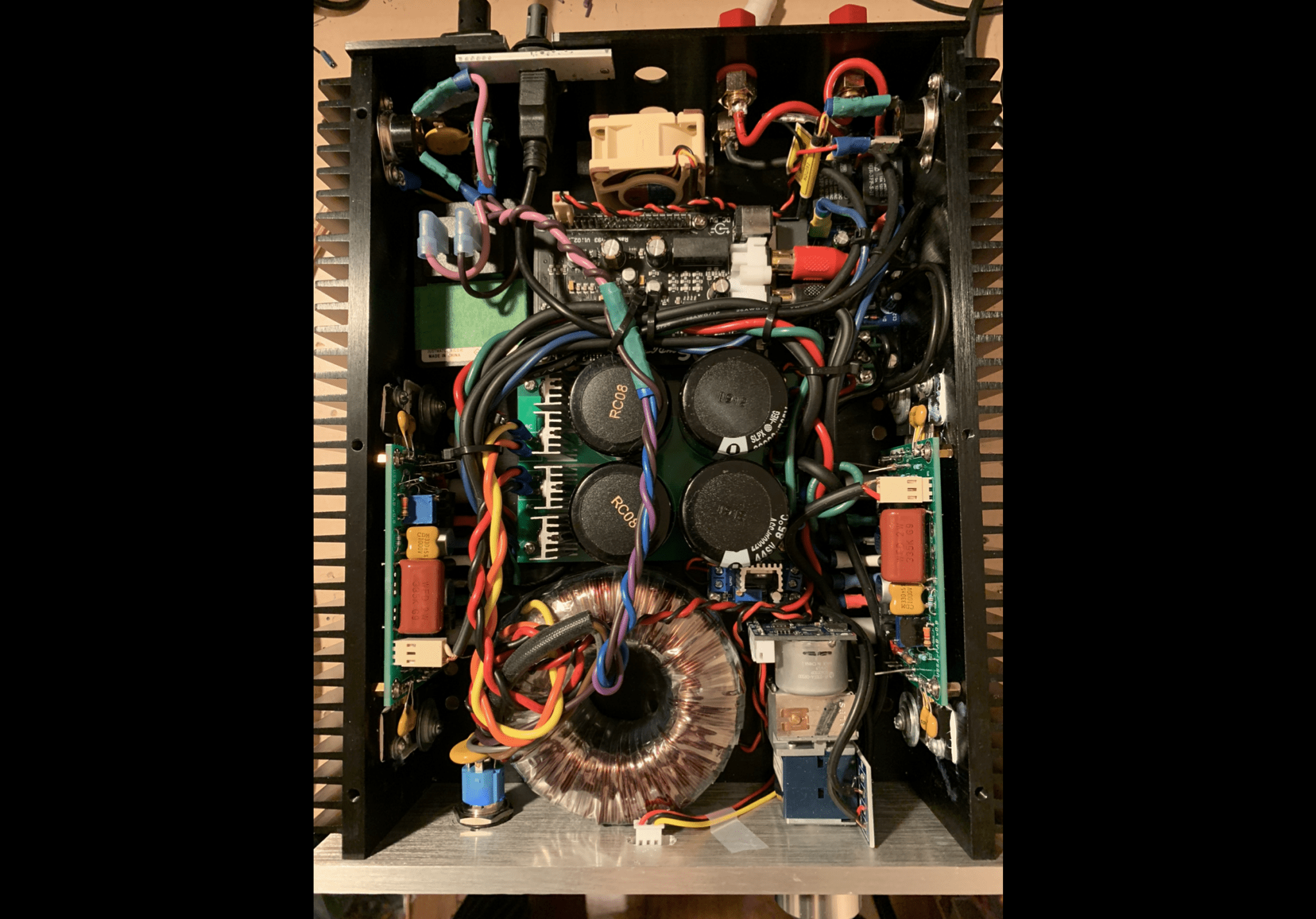

v 0.8 USSA pcb is a mini version for lower power amplifier to integrate in a small chassis. I use this pcb in my portable all-in-one music server/amplifier. In that case it is for an USSA-4B version. See attached pictures. Useful when I want good sound in a remote location rental cabin in the woods….
Fab
Fab
Sure it can be used as a headphone amp. But in that case I would not install the power ouput transistors and rely only on drivers since they operate at more than 50ma which is quite enough for any headphone in class A region….

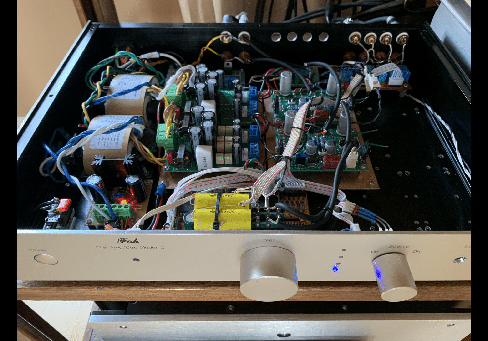

See below this USSA v0.8 pcb used in a preamp with bjt input and only drivers as output. Note the input cap on pcb is bypassed with a wire. However I have used a speaker crossover cap to protect the TKD potentiometer….
