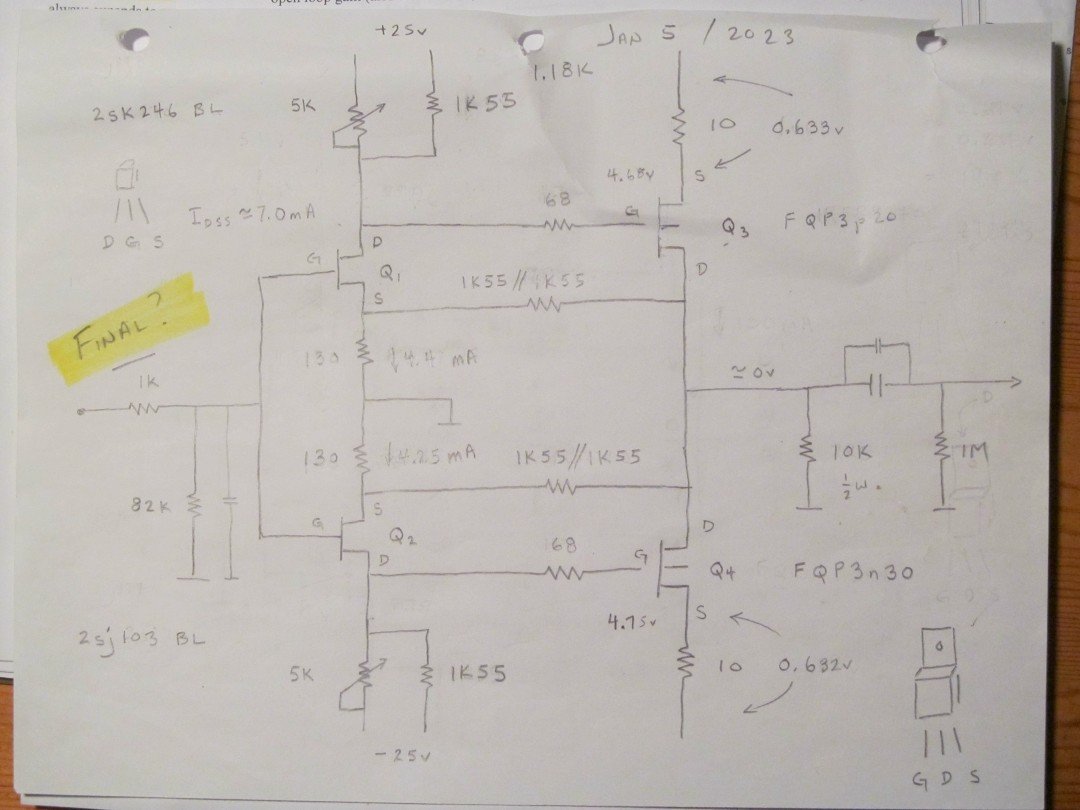

For , 2sk2013Y and 2sj313Y 's the manual says the current should be 23 to 28 mA
What bias current range do you recommend for FQP3n30's and FQP3p20's ?

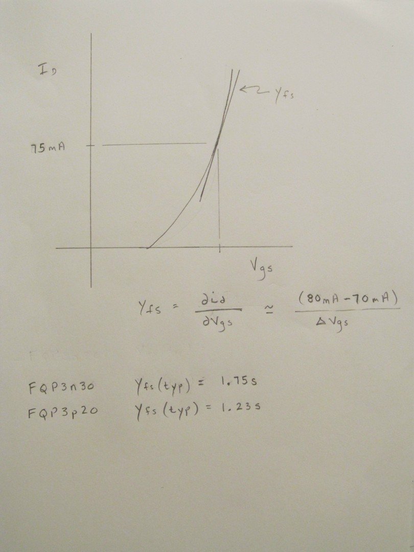

Thanks for this . I was thinking in terms of what is enough current to effectively drive the Ciss of the Exicon ECW20 MOSFET's .
But then running the FQP3 MOSFET's at a good linear operating point would come into play as well .

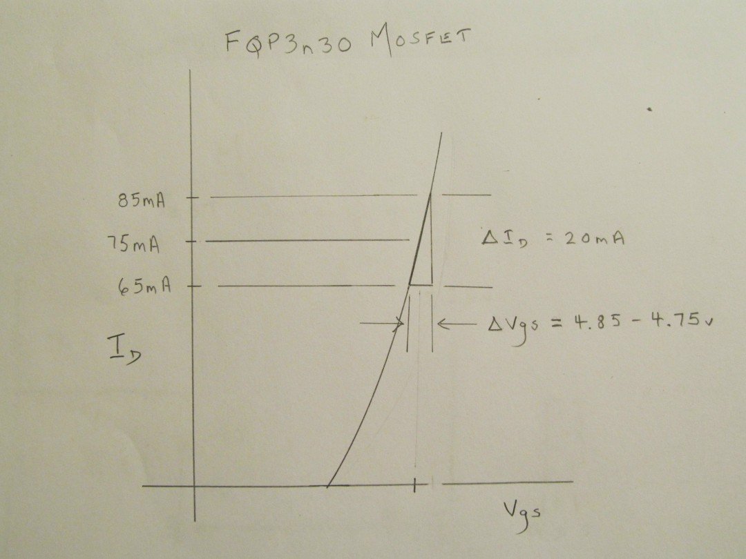

Looking at the datasheet of a FQP3n30 , there is a graph showing the transfer characteristics
https://www.mouser.ca/datasheet/2/308/1/FQP3N30_D-2314058.pdf
Yfs = delta Id / delta Vgs , but this only goes down to 100 mA .

Fab ,
Unfortunately , I got caught up with silly things like bathroom renovations and other projects ,
so the USSA 3.2 was put on hold for a while .

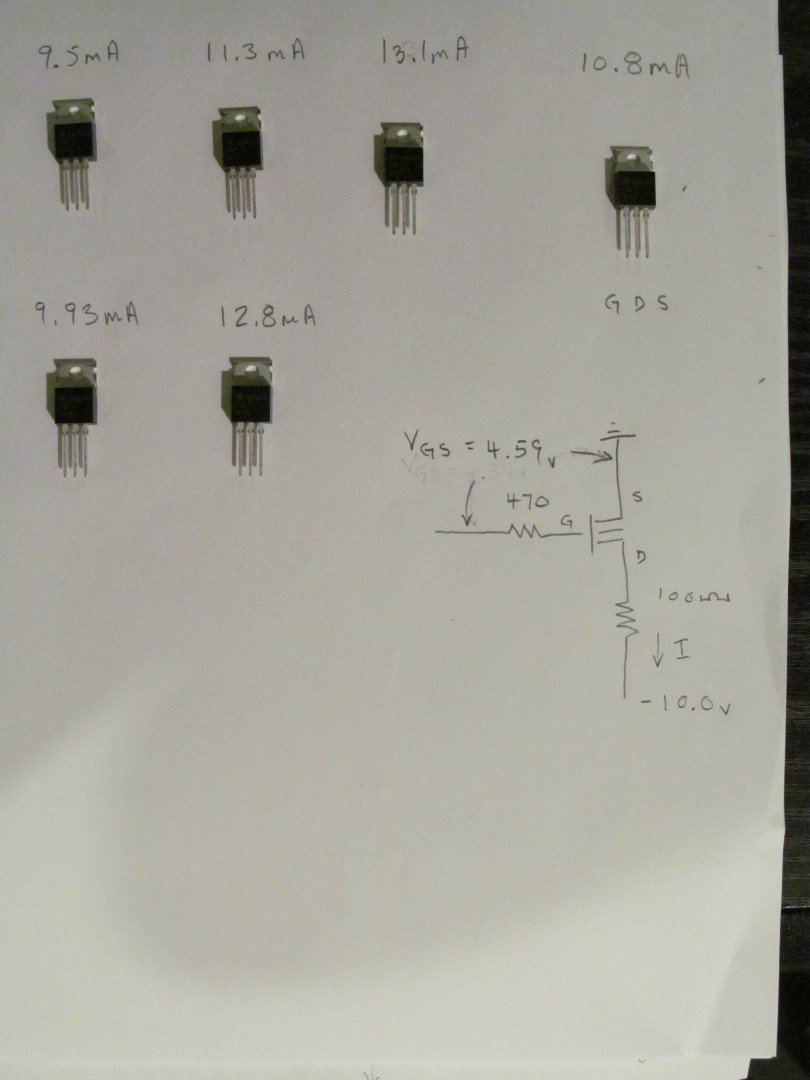

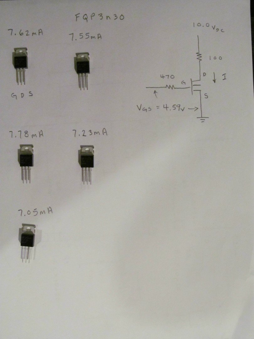

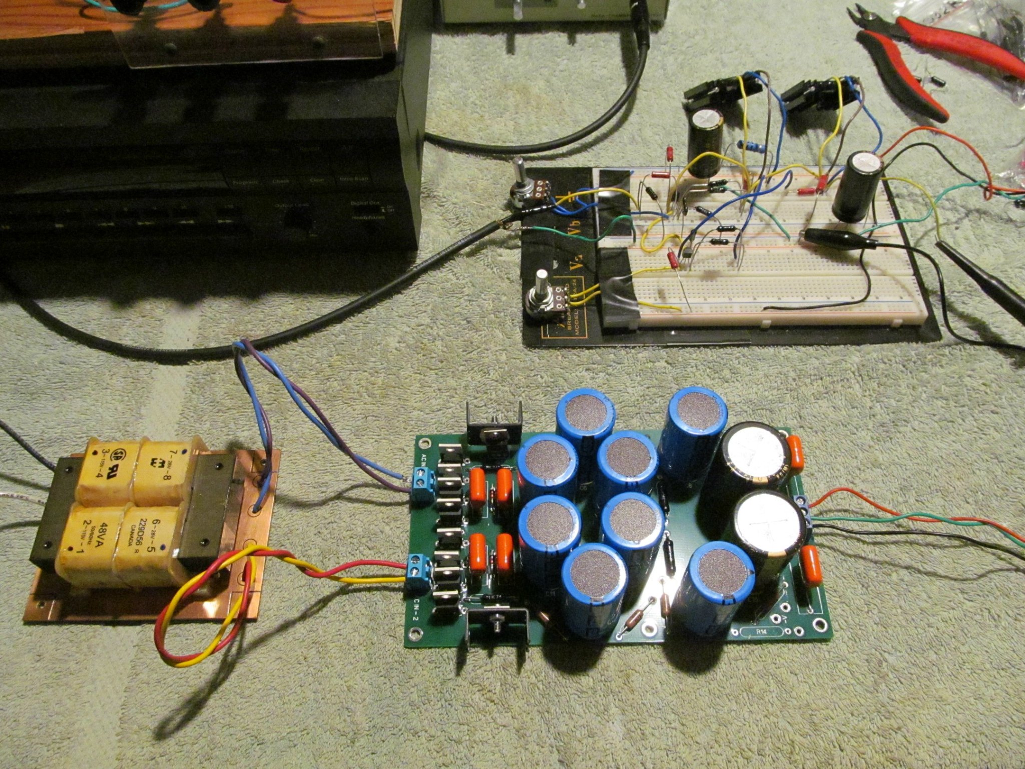

So I just tested some FQP3n30's and FQP3p20's using a different method than what Nelson Pass used .
Since Vgs controls Id , I tested them by setting Vgs to a constant and then measured Id .
In general , for the same Vgs , Id was considerable higher for the p type rather than the n type .
The MOSFET's take a while to warm up , so that's why I set Vds and Id on the low side when testing them .

Your method is not correct for this application. The threshold voltage is just a parameter and does not give the vgs-Id curve. If the N channel and P channel have different voltage threshold starting point it is no big deal because in the end it the source current that matters. You should rather test for a same transistor the Id for different VGS value . It is around the used driver bias current that it can matter. If the transconductance (Yfs) is about the same at about half , used and double current than it means you are in the linear part and also you have a good match between N and P channels for the transconductance. The detailed method to calculate the transconductance is in the build manual..if you have genuine parts - as determined by transconductance measurements- then you should not even worry too much about a close transconductance perfect match in this topology.😉

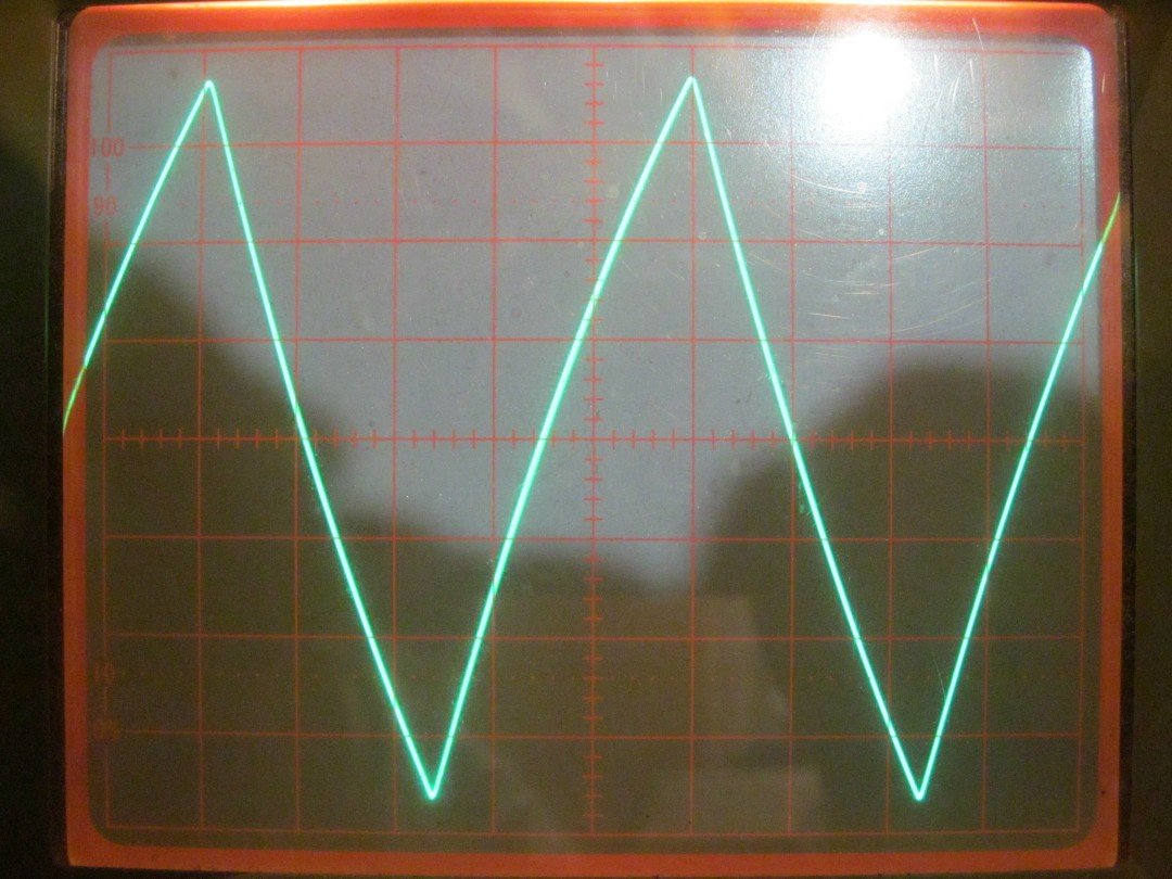

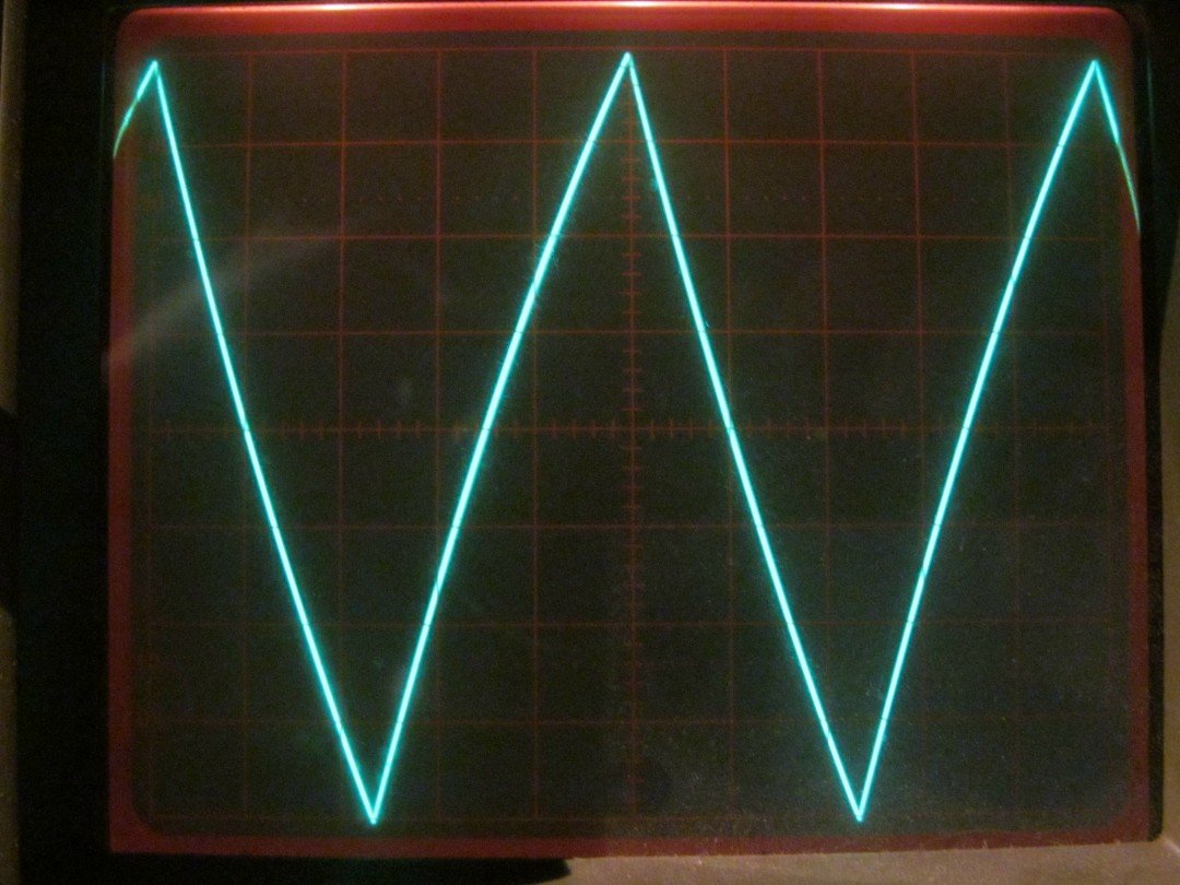

You are right about the current required for the FQP3 mosfet's .
The test frequency shown was 10 KHz .
When Id = 25mA the waveform was compressed .
But when Id was pushed up to 75mA the linearity improved .

" ... in the end it the source current that matters. You should rather test for a same transistor the Id for different VGS value . It is around the used driver bias current that it can matter. If the transconductance (Yfs) is about the same at about half , used and double current than it means you are in the linear part and also you have a good match between N and P channels for the transconductance. ... "
I've read your comment carefully , as well as the booklet .
Hopefully , I understand this correctly .
Since its the source current that matters , should I try to find an n and p MOSFET where Yfs matches at 75 mA ???
The datasheet for the FQP3n30 says Yfs (typ) = 1.75s
and FQP3p20 Yfs (typ) = 1.23 s

You are on the good path but trying to find the same yfs between N and P is maybe too ambitious…. Better to find same yfs for both left and right audio channels (thus N with N, P and P) so left and right channel behave similarly (especially in low overall feedback design). If N and P channels are both in the linear part of the curve at the intended bias current then it is correct.

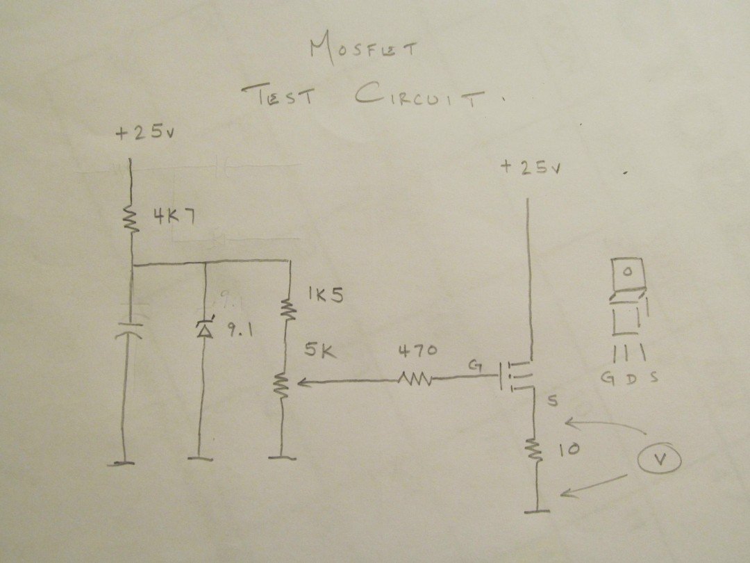

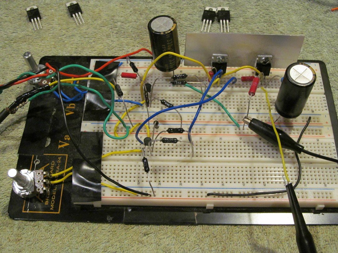

Trying to measure Yfs , I modded a section from one of Nelson Pass's Amps to create a test circuit .
Id was set by adjusting the 5K pot .
The problem is delta Vgs is so small , a really accurate way of measuring Vgs is required , to obtain delta Vgs .
Also the MOSFET's need to warm up before taking a measurement ... which is a total pain .

A 3rd method would be to build a differential pair with 2 MOSFET's . Add a signal to both MOSFET's .
Then if Vout = 0 , then the 2 MOSFET 's are matched .
Also , tried building an amp to measure Av ( the voltage gain ) .
Once knowing Av , Yfs could be obtained .
But this didn't work out .

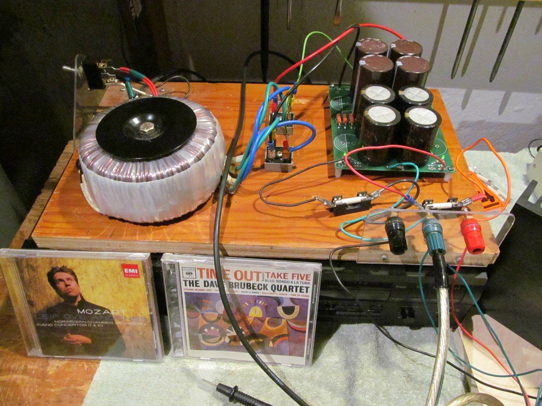

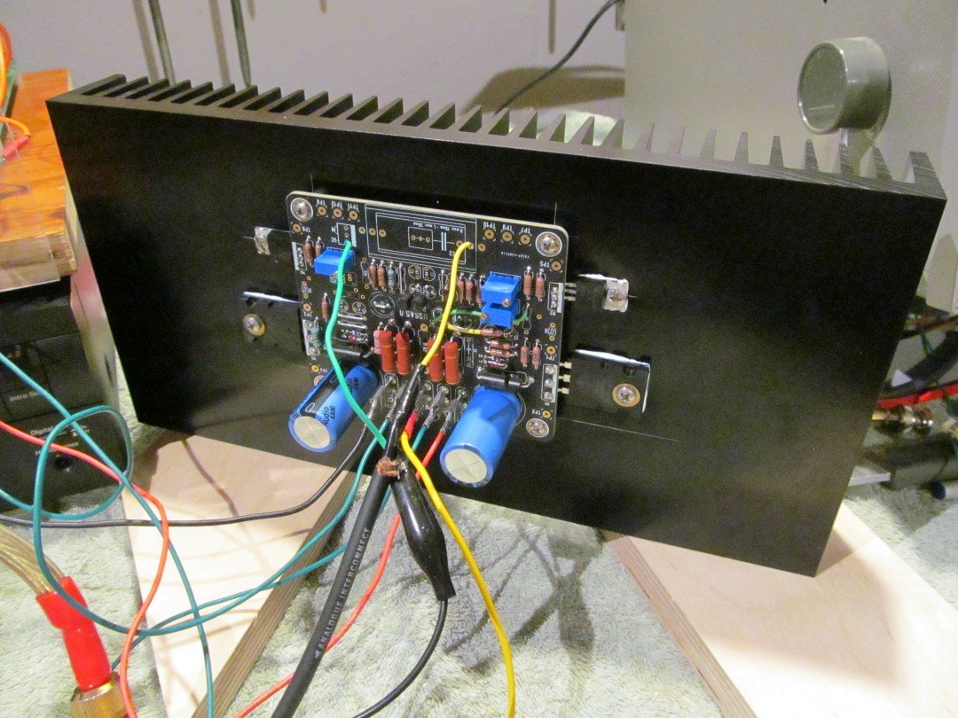

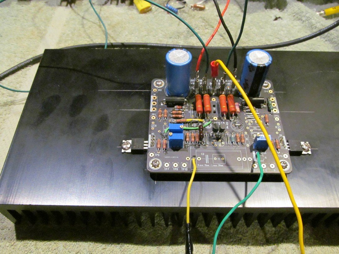

So I increased the current on the USSA 3.2 slowly , first with a bench power supply and then switched to the 300 VA supply shown below .
Note the 3 Amp fast blow fuses on the + Ve and - Ve of the 300 VA supply .
Without the thermistors , the amp took about at 60 minutes to reach full bias current .
The amp is so well behaved . The DC offset on Vout only drifted from +19 mV to - 6.0 mV as the amp was warming up
before settling down to 0.1 mV .
The amp has only had about 6 hours of running time .
DiyAudio member Pinnocchio said to give these amps 30 to 50 hours of burn in time .
But so far the bias currents are
.......................... n ................................... p
FQP3 's ........... 54.1 mA ........................ 58.9 mA
Exicon 's .......... 1.22 A ............................1.22 A

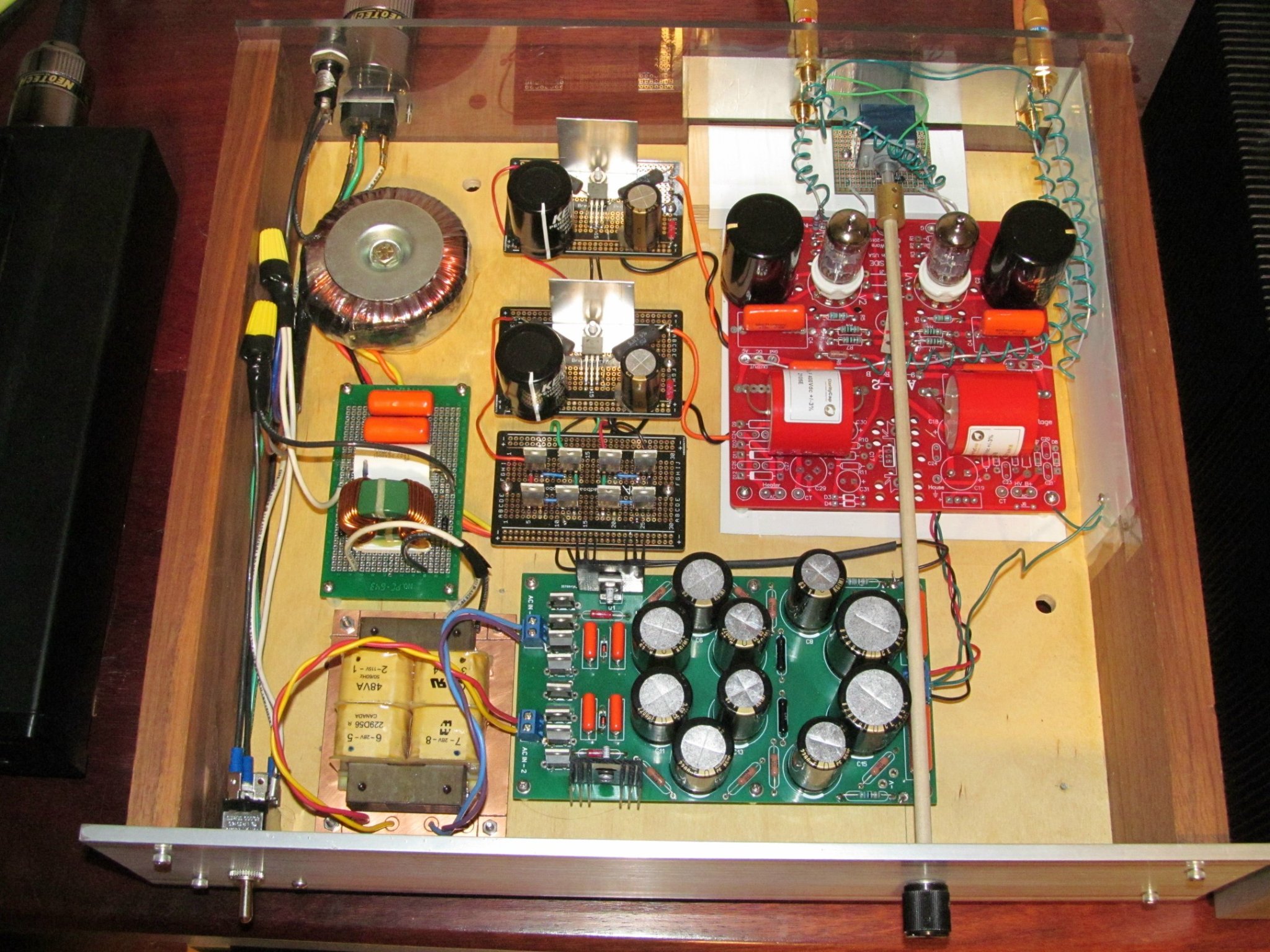

- Looking at the datasheet for the Exicon ECW20x20 MOSFET's , it does not show the metal back of the case is connected to the source .
But it is . Have no idea how this amp worked without thermal pads ... but it did .
https://www.exicon.info/PDFs/ecw20n20.pdf
After , receiving great amount of advise from DIYAudio members on the issue of thermal pads , have decided to go with AL2O3 pads .
Aavid 8120G thermal pads have a thermal conductivity of 79 W / ( m x k ) .
https://www.mouser.ca/c/thermal-management/thermal-interface-products/?m=Aavid&thermal conductivity=79.56 W/m-K
- When connecting the amp in the final build , I still connected fast blow fuses between the power supply and the amp .
Highly recommend doing this when testing or setting up any amp .

As shown in the photos attached , I use a clipper power supply .
The clipper just takes a pair of scissors , and cuts the top right off the rectified waveform .
Then this is followed with a 4th order Low Pass Filter . This may be a bit crude , but its ultra simple and it works .
