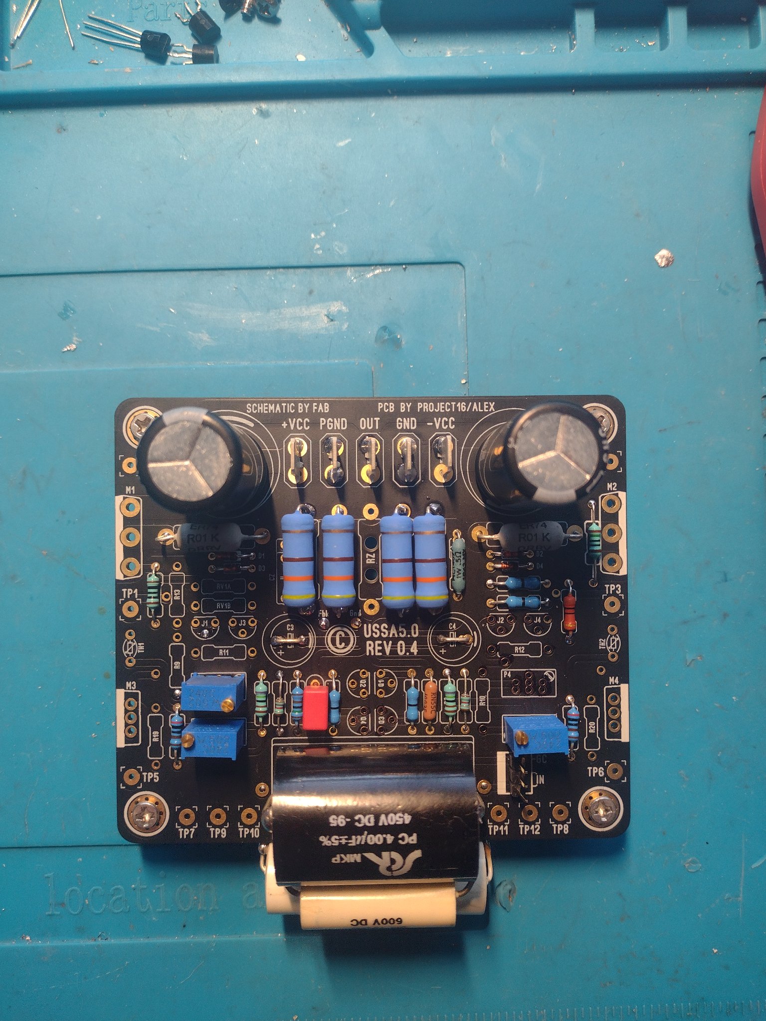

Built the best I could so far with the schematic. Waiting for laterals from profusion, ordered May 1st, still havent shipped. I have a matched pair of jfets at 9ma idss. I know the damping will suffer. Should I get a set of jfets matched at 4.5-6 instead off ebay? This is a 3.2 build with FQA drivers.

Is R13 is missing ?
When ever bending metal , a form should always be used . So rather bending the leads on the MOSFET's freehand ,
recommend bending them around a 1/4 " drill bit .
I used a 6-32 machine screw to fasten the FQP3 MOSFET's to the heat sink .
The hole in the Exicon MOSFET's is large enough to accommodate a 6-32 , but there is no margin for error .
So consider using a 4-40 machine screws for the Exicons .
If you are waiting for the Exicon MOSFET's to arrive , you can still test the USSA 3.2 without them , as shown on post #92 .
Highly recommend using a dual bench supply for this , and start off with a low voltage supply rails .
Maybe +/- 10 Vdc . Keep an eye on the current when you switch on the bench supply , and slowly bring the supply voltage up to +/- 24 Vdc .
This allows you to get familiar with how the trimmers work .
Actually , I taped up the jeweler's screw driver , so if it was dropped , it wouldn't short anything .

Yes in the schematics r13 is crossed out and just RV1 is listed, but I see I would then possibly need to jump r13 to complete the circuit. I am also missing r19/20 since the values are not clear in the schematic. I planned on asking once I get back to working on the Pcb. I may PM you to ask some of your values and I am still not totally clear on setting the current for the FQA mosfets. Will def be trying first with no laterals and just a power supply. Profusion actually finally shipped today so hurray.

Very impressive, those are huge capacitors. I will be trying something completely different. My dual mono setup will have 160va transformers feeding 4 Tombo R25 power supply boards. Yes just 4 capacitors at 22000uf each. The power supply is the easy part for me, I am more concerned with getting the boards up and running. Hopefully I can mount the boards on the heatsinks and figure out how to test without the laterals. Will be using a VRDN board as my temp power supply to test the boards before hooking everything up.
Hi gsrchrisu
160VA transformers rating is not that much… I suppose the Tombo R25 are voltage regulator boards?
To test without the output stage latéral is precisely the uniqueness of my build manual to test at different steps of building instead to wait at the end of assembly and not having a clue what mistakes have possibly been done…..
Refer to section 9 “Test front end without output transistors:”
However, since the manual does not cover for version 3.2 you should measure differently:
“9.2 Voltage/current measurements:
9.2.1 Adjust voltage in driver stage
• Connect V+ and V- and PGND and GND to power supply (from 15Vdc to 30Vdc).
• Adjust P2 for about 0,7 Vdc between TP6 and V-
• Adjust P1 for about 1,0 Vdc between TP5 and V+.”
But before testing these part of the build you should test first the input stage of section 8 “Test Input stage”…
Also installing the test point leads will help in the measurements…
Good luck
Fab
