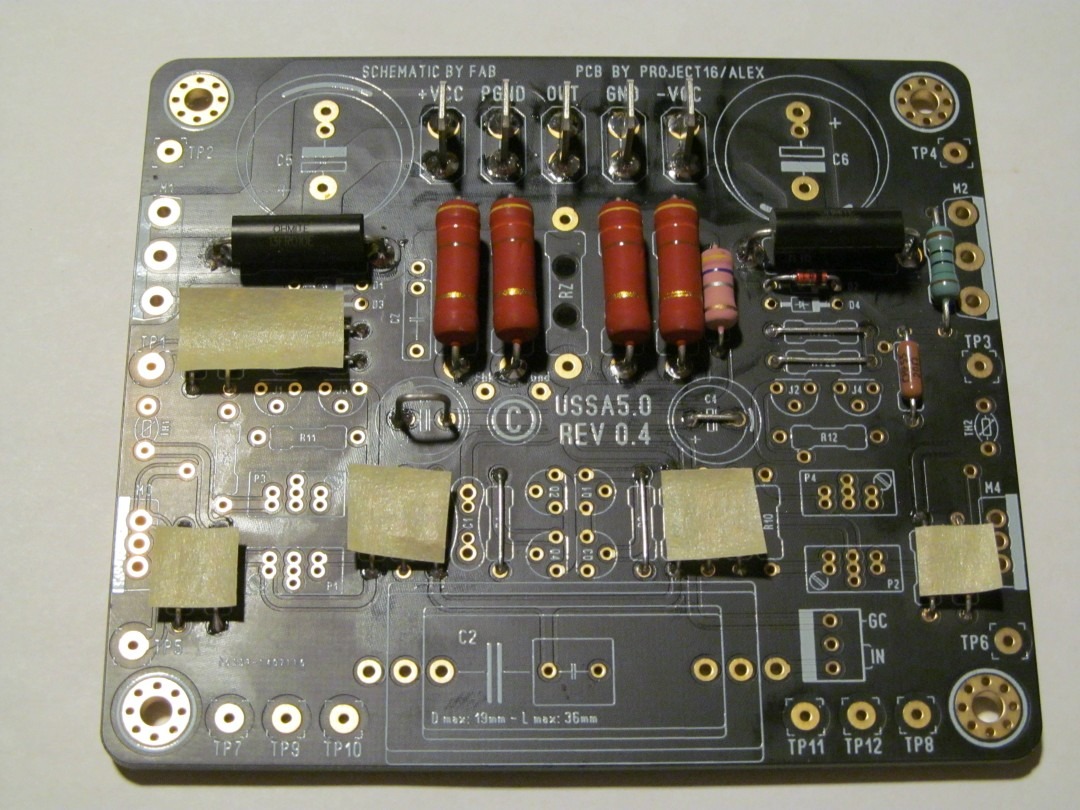

Building the USSA 3.2 Amp * ... on the USSA 5.0 Rev 4 board ,
1 ) The 4 ellipses on the schematic indicate that 4 jumpers are required .
As you've shown in Post #1 and I've shown in the photo attached .
Jumpers are required across R3 , R4 , C3 and C4 as well as RV2A and RV2B .
I set up a bar , to connect a scope probe ground , on the jumper of C3 .
2 ) It would not be happy moment if the jFET's got soldered into the wrong location
Q1 on the board - J1 2sk170 BL
Q2 on the board - J2 2sj74 BL
Q3 and Q4 are left empty .

this info is already in the USSA3 manual, except the use of the drivers you mentioned.
Fab
Fab , originally thought I would build FSSA -2 amp , so I ordered FSSA - V3.0 boards ,
so the manual sent looks to be for the FSSA - 2 Amp .
But I also ordered USSA 5.0 REV 0.4 boards . I know F5 style amps quite well , so have since decided to build the USSA 3.2 amp .
So I'm trying to figure out where the jumper wires go on the USSA 5.0 REV 0.4 board .
To add to the list above ,
- To connect P3 to Gnd , a jumper wire is required from R9 to the Gnd eyelet at the center of the board .
- R32 connected between Gate of J1 on the board to Fbk ??? ( Note : J1 on the board , not J1 of the circuit ) .

Hi Uundehill
if your transistors directly come from these big distributors then you cannot do better unless you bought them directly from the manufacturer -which might prove difficult for an individual, except for samples….
No need to match N with P channels. Try instead to have about similar Ns and similar Ps to have similar left and right amplifier channels.
25-30ma is low to get max performance from these transistor.
Testing methodology is explained in the build manual and must be followed. It is the best part of the manual and I support the builders who follow this manual step-by-step…
to-92 package is not for FQP but rather input jfet….😉
Fab
