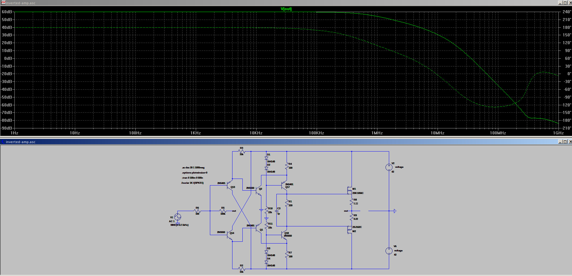

This is CFA ?
I guess not...
Yes, I think so.
After closer look it looks like a inverted VFA, build with symmetrical singletons ??
That's why it has DC offset. If you couple it with signal source via big capacitor, offset gets better in the sim.
In real life, when transistors are not perfectly matched, this DC offset will be even bigger.

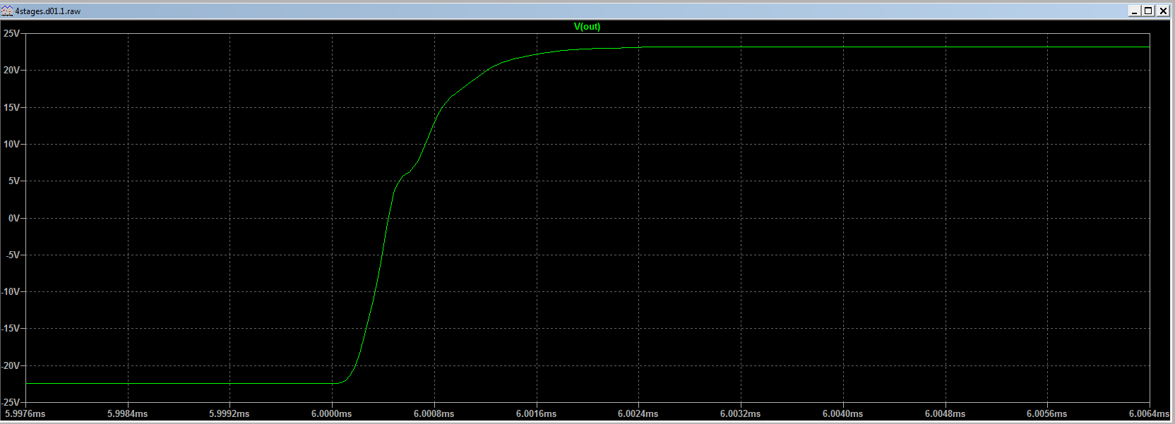

But square waves have kinks in the middle of the rise, it needs some fix...
Slew rate seems to be low, maybe 5V/us

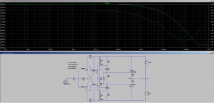

Where does the feedback return to the input?
That's also CFA... It will need servo to correct DC offset..
Connect T1
I see T1, but where is the other end on the input side?
Oh, I see T1 now on the input end (left lower corner). It looked like ground...
So it's inverted CFA. I'm sure it will need the servo...
Should be fast.
And only 4 transistors in the input stage. Not too bad. But the servo spoils it...

Maxim - do you think this amp here can be converted to use LMK/Wiederhold style VAS?
Input stage connected to the Emitter of VAS transistor?
It looks promising (SR 44V/us) , perhaps would get even better if connectivity between input stages and VAS was converted to LMK/W style...

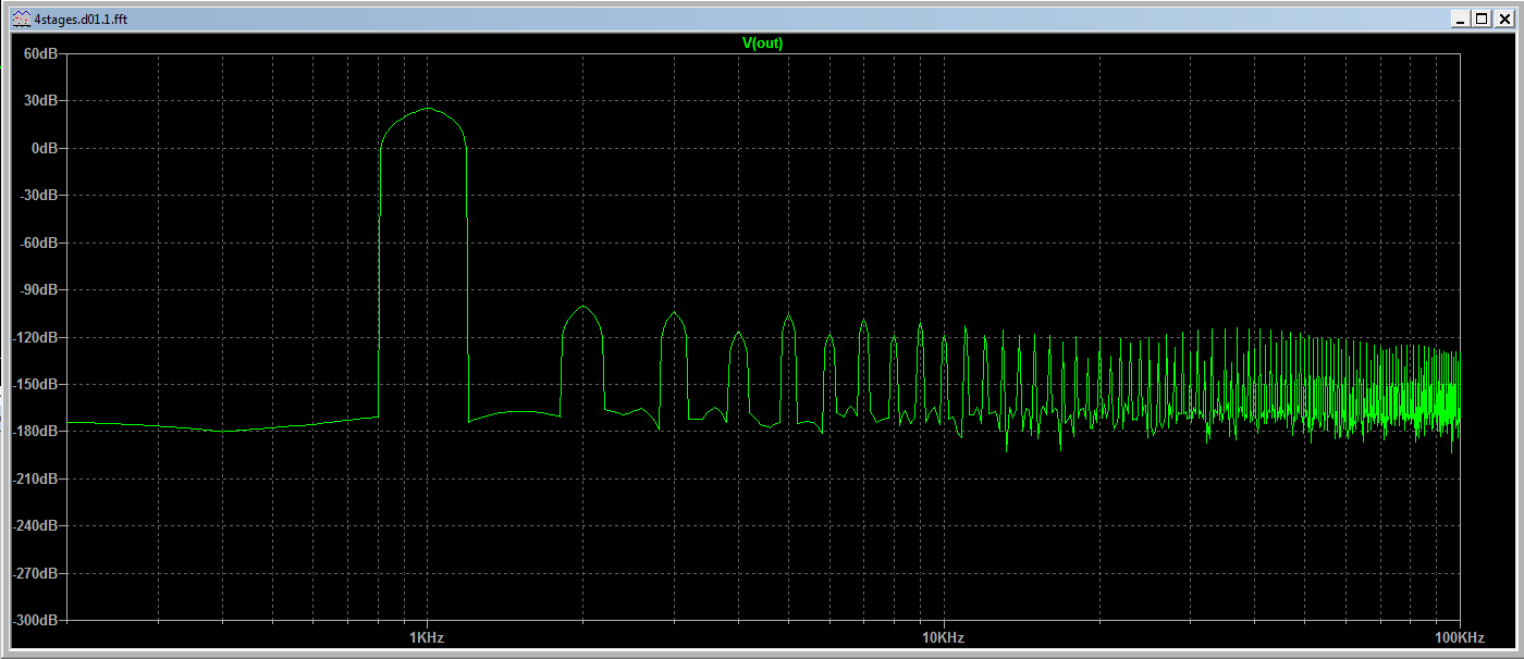

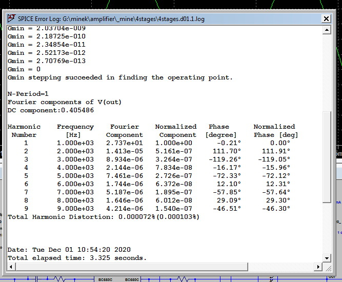

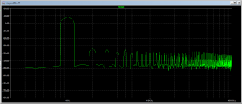

Very stable, fast, square waves look good, low Thd, FFT also look fine.
