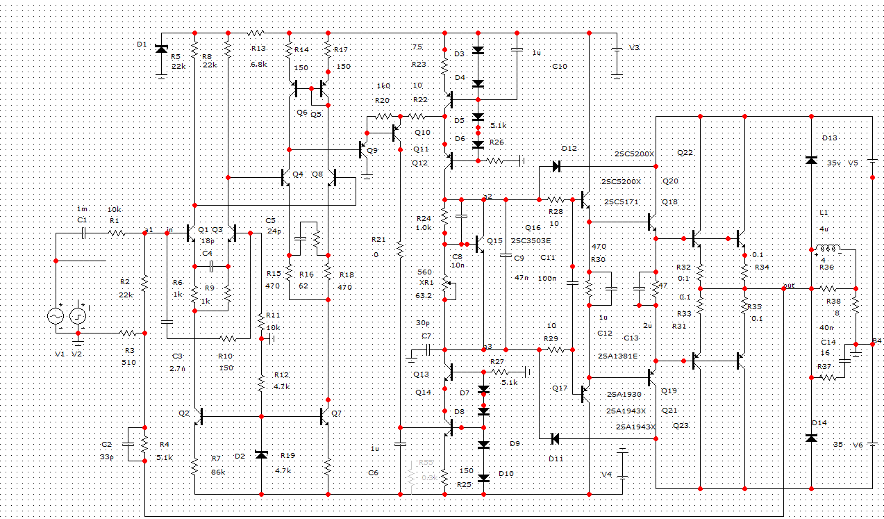

First we need to come up with an amp (e.g. version of LMK/Wiederhold), with faster op-amp (E.g. TLE2081), that at least would sim well, had SR > 40V/us, nice frequency profile to your liking, and had good square waves, clip, and was relatively simple 🙂

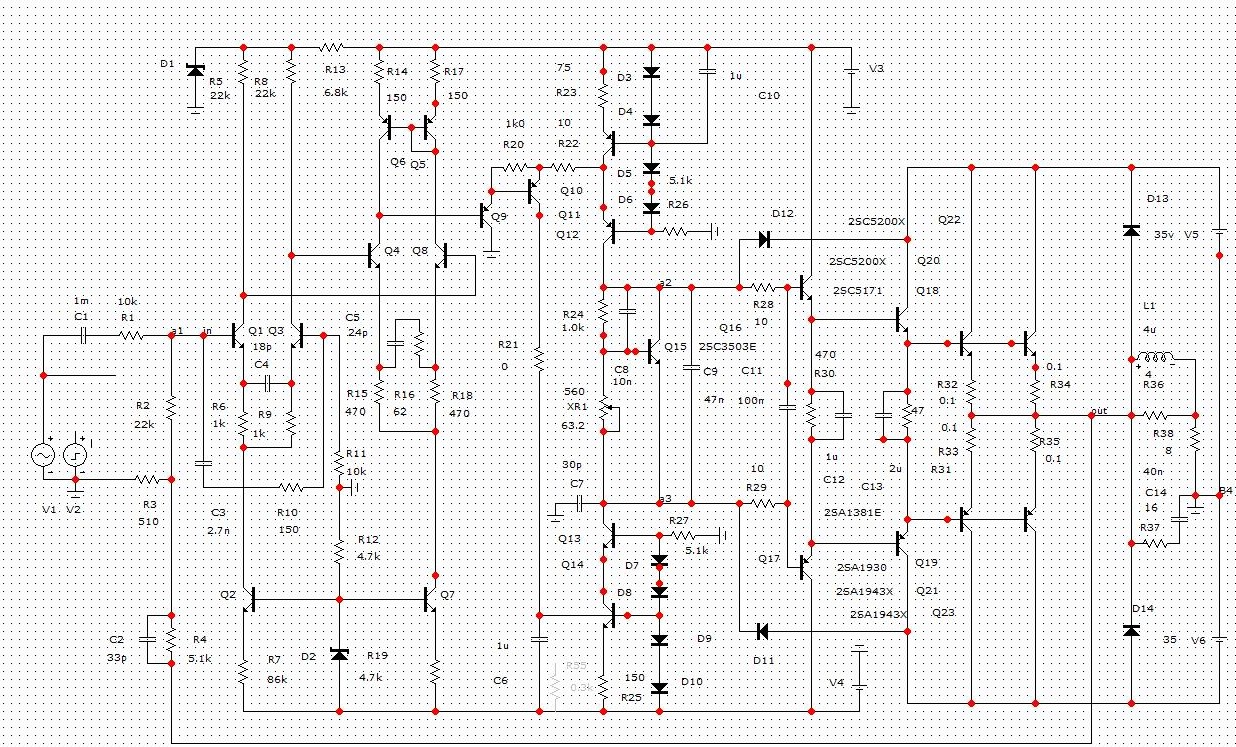

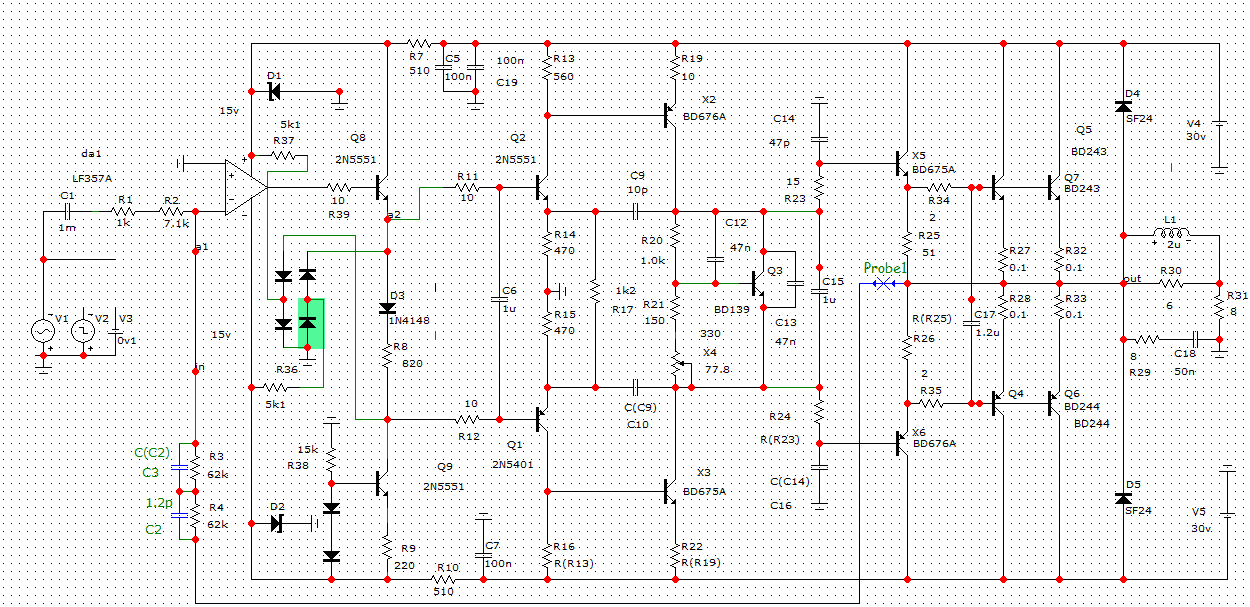

Well, here's a quick booster .Clone of my monster

The end of the year is the end of the year!.While you're working!
well, I'm retired.And the schemes, just when mastering MS-9, are by-products. I just learned how to model and draw a printed circuit Board, as well as how to solder in a modern way.
монстрик 200вт 4 ом.

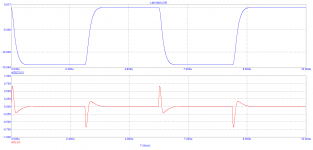

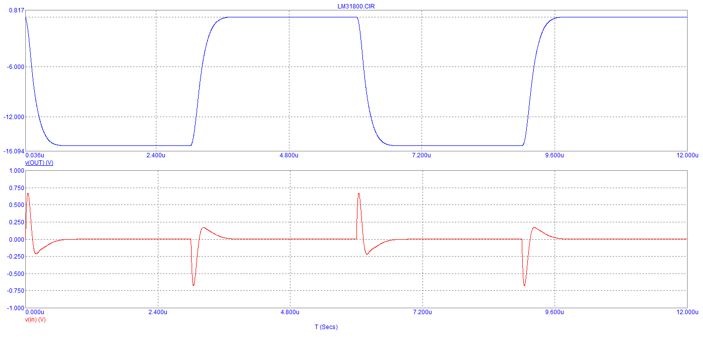

op-amp has SlewRate 15V/us yet whole amp is almost 60V/us
and relatively simple. Low distortions, very nice square waves.
Originally rails were at 78V, so perhaps SlewRate can be even higher..

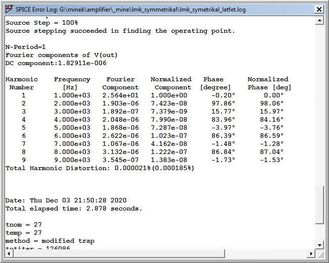

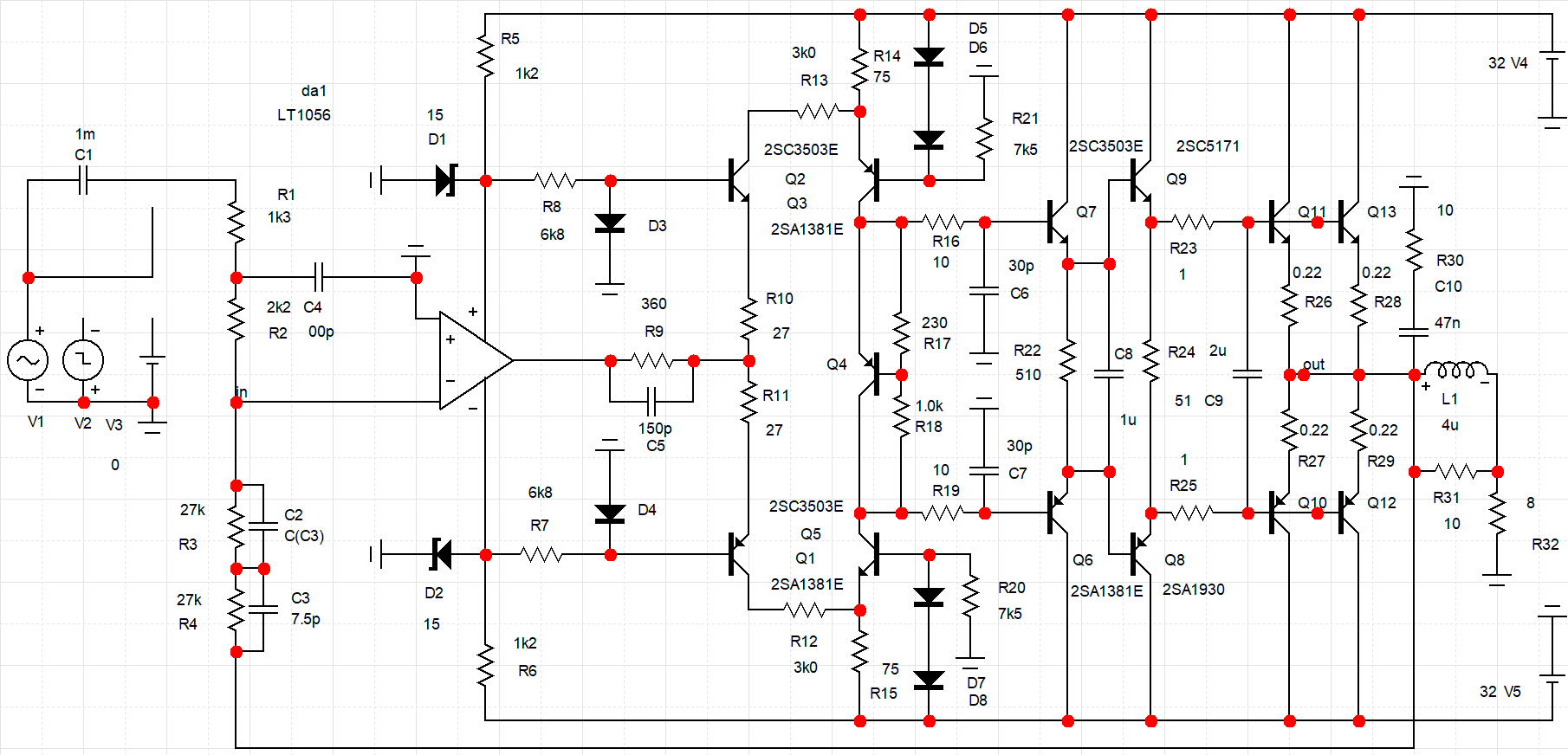

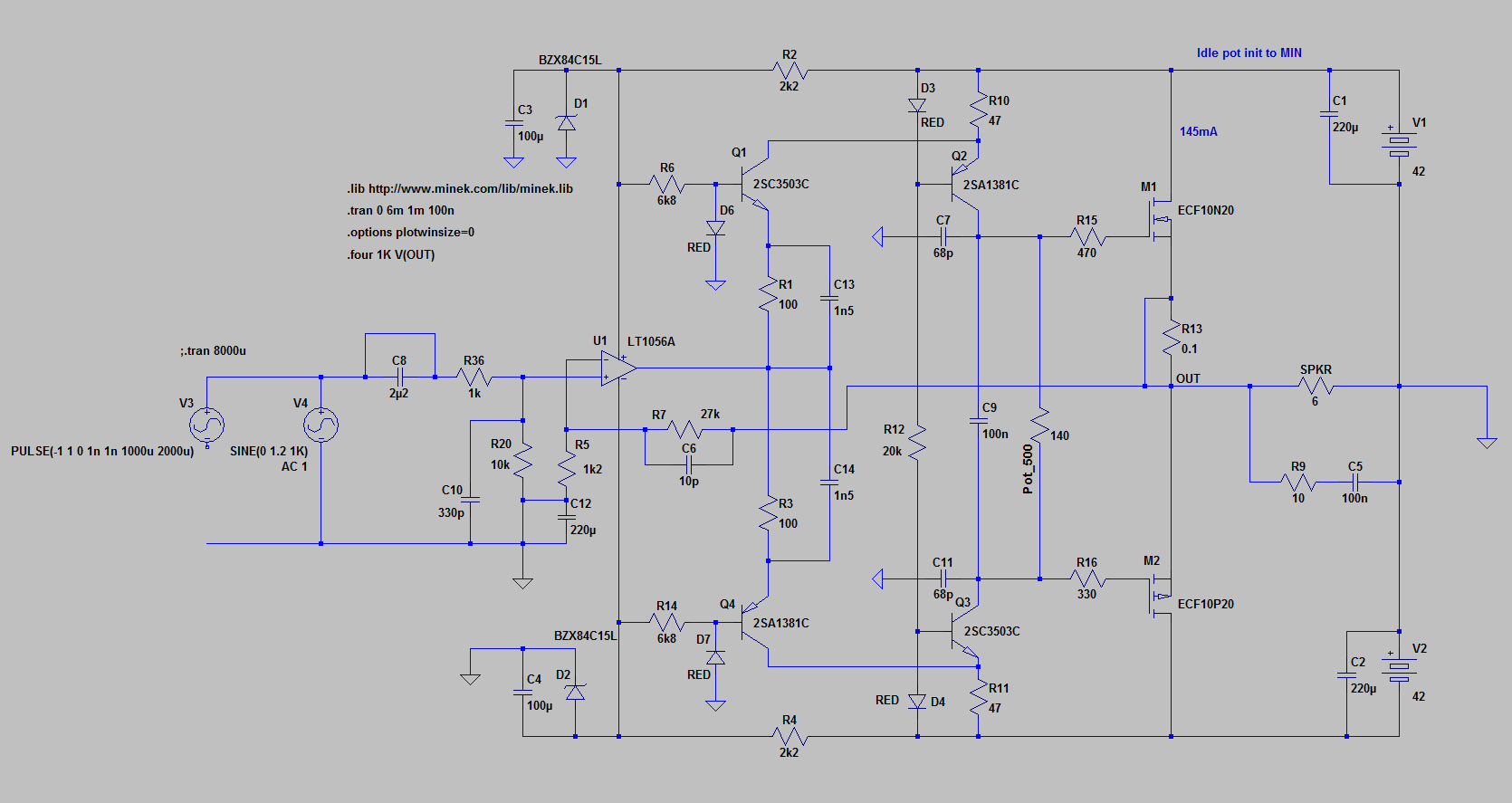

Symmetrical Wiederhold amp
It seems that secret to higher slew rate in this topology (LMK/Wiederhold) is in symmetry.
I see that symmetrical LMK (or is Wiederhold?) is able to do over 50V/us with all other parameters not worse than before.
Here is an example. Square waves have rise time ~1us for 50V swing.
That's even with relatively slow op-amp (LT1056).
With asymmetrical design, it was impossible (for me) to get good square waves handling, and speed, at the same time.
For some strange reason, this symmetrical designs reminds me of Blomley/Hartsuiker design..

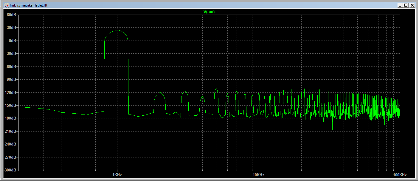

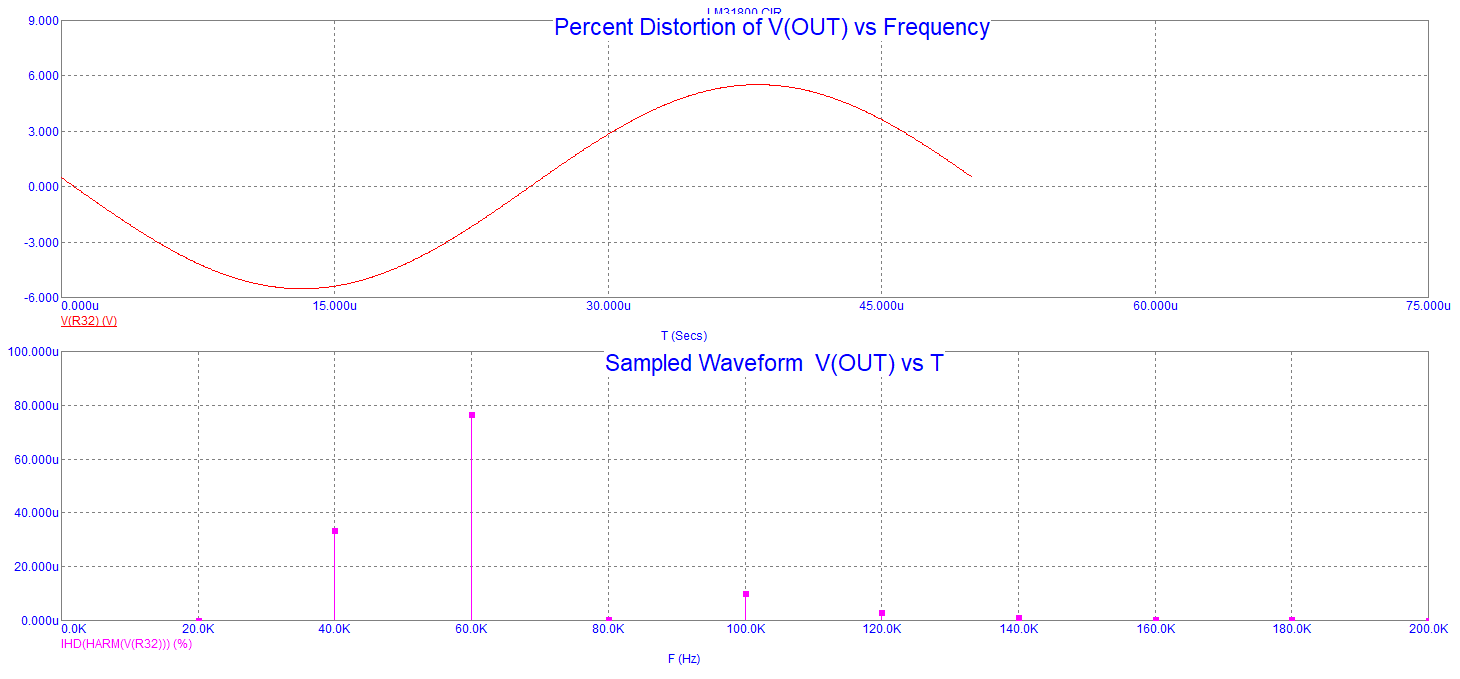

>And why do you look at distortion at 1kHz, and not at 20kHz
1kHz is a start.... Work in progress.
What you are simulating in last post, is not the same as mine.
When I tested your symmetrical designs from few weeks ago, I agree - they did not surpass LMK. That's why I didn't continued with them.
But I tried slightly different design yesterday.
Schematic I published yesterday night, simulates the same as LMK, at least for me. I don't see any problems with it. All the numbers/graphs are very close to LMK/Wiederhold.
What is R2 in your schematic? connected between (+) and (-) of op-amp?
Also, if you want to test symmetrical schemas - do not use inverted input with (-) grounded.
This approach is messing up square waves.
Non-inverting approach gives much better results - at least for square waves and speed. I compared them.
The only difference is in the inverting switching on of the op-amp . .Well, Bipolars in VK instead of laterals

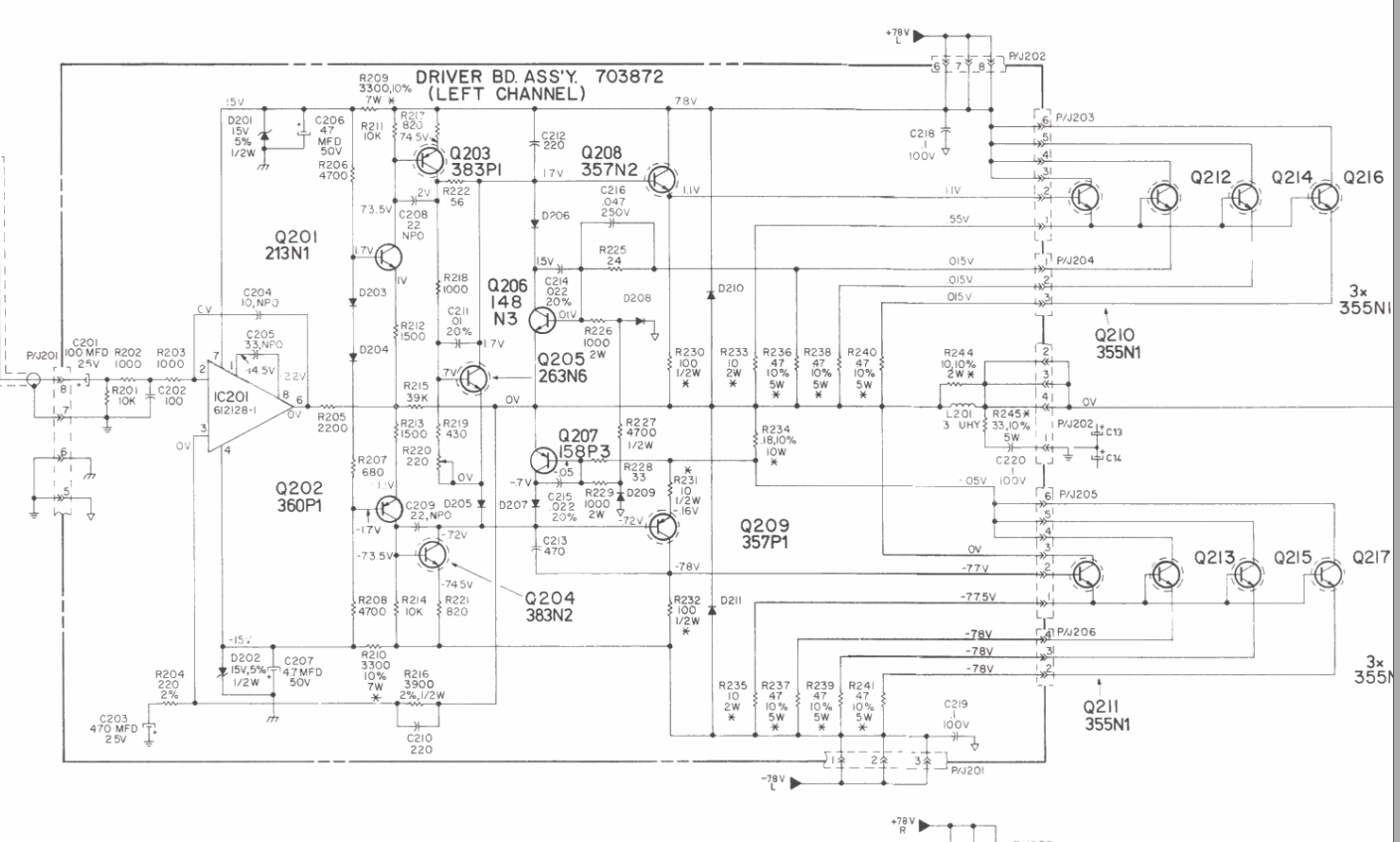

- Unusual amp from 1987
