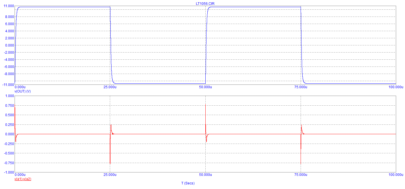

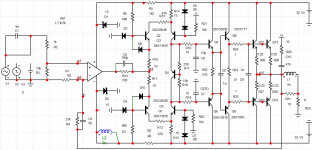

You ignore common-mode interference. .In a non-inverting switch-on, the interference level may be highWhat is R2 in your schematic? connected between (+) and (-) of op-amp?
Also, if you want to test symmetrical schemas - do not use inverted input with (-) grounded.
This approach is messing up square waves.
Non-inverting approach gives much better results - at least for square waves and speed. I compared them.

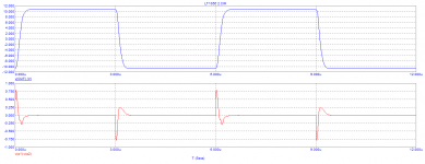

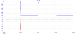

high frequency of the meander generator in the model.Not 20 kHz, but much higher.
In the model, it makes no sense to look at 20kHz.It is necessary to take the frequency higher and look at both the meander and the difference signal.
150khz
Meandr 20khz attach
150khz
Meandr 20khz attach

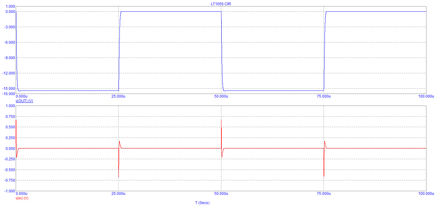

To evaluate SR, I was looking at square waves at 1kHz, with amplitude of 50V.
If that looks bad - no need to look further...
The microcap MS does not take into account the rate of voltage rise.Although, maybe I just don't know all the features of the simulator.

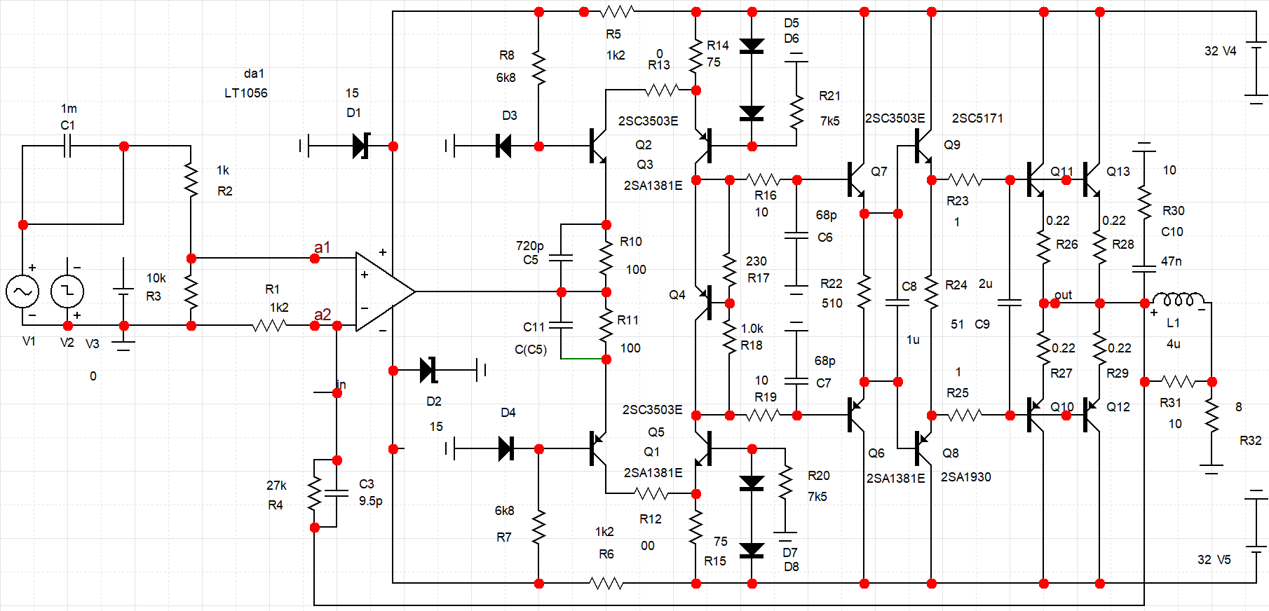

R9/C5 in your schematic? If I add it to mine, distortions increase a lot (increased 5 times)
C5/C11 at 1n5 were tuned to that value to smooth square waves.
At 50Vpp, there were kinks.
Otherwise, they don't affect anything else, as far as I can see..
720pF works OK?
If not for tuning for square wave response, C5/C11 were not needed...
Square waves with small amplitude are easy to handle, but if you go over 30Vpp, there are kinks in there....
That's why C5/C11 C7/C6 have these values....
Higher values of C6/C7 are slowing down rise time.
720pF works OK?
1500pf . Overexcitation. It will whistle in the iron. That's why I changed this chain a bit initially, to remove the probability of exciting factors .
Difference signal look at the meander. The voltage at the input of opamp +in minus the voltage at the input of opamp -in

Similar, but from a different Opera.We have 80dB of loop gain at 20kHz and cascodes

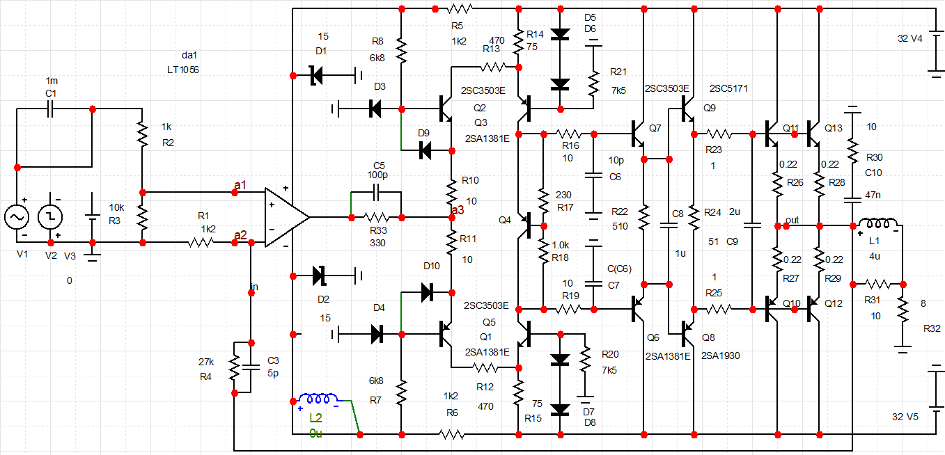

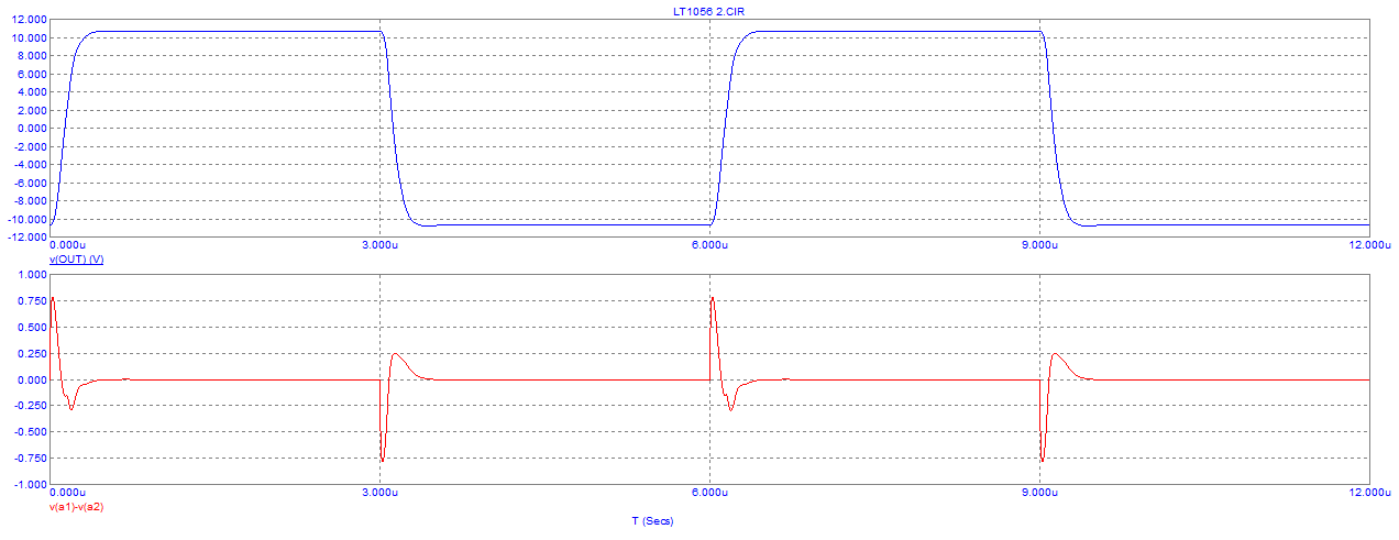

A little bit dispersed this option . Distortion decreased,but still too much of them. C7/C6 10pF, 75pf in parallel with the resistor330 from the opamp output. And as always, I didn't forget about the protective diodes.
LT1056 place in the integrator . It is better to use LF357 / LF356.
replaced with LF357 and another matter
