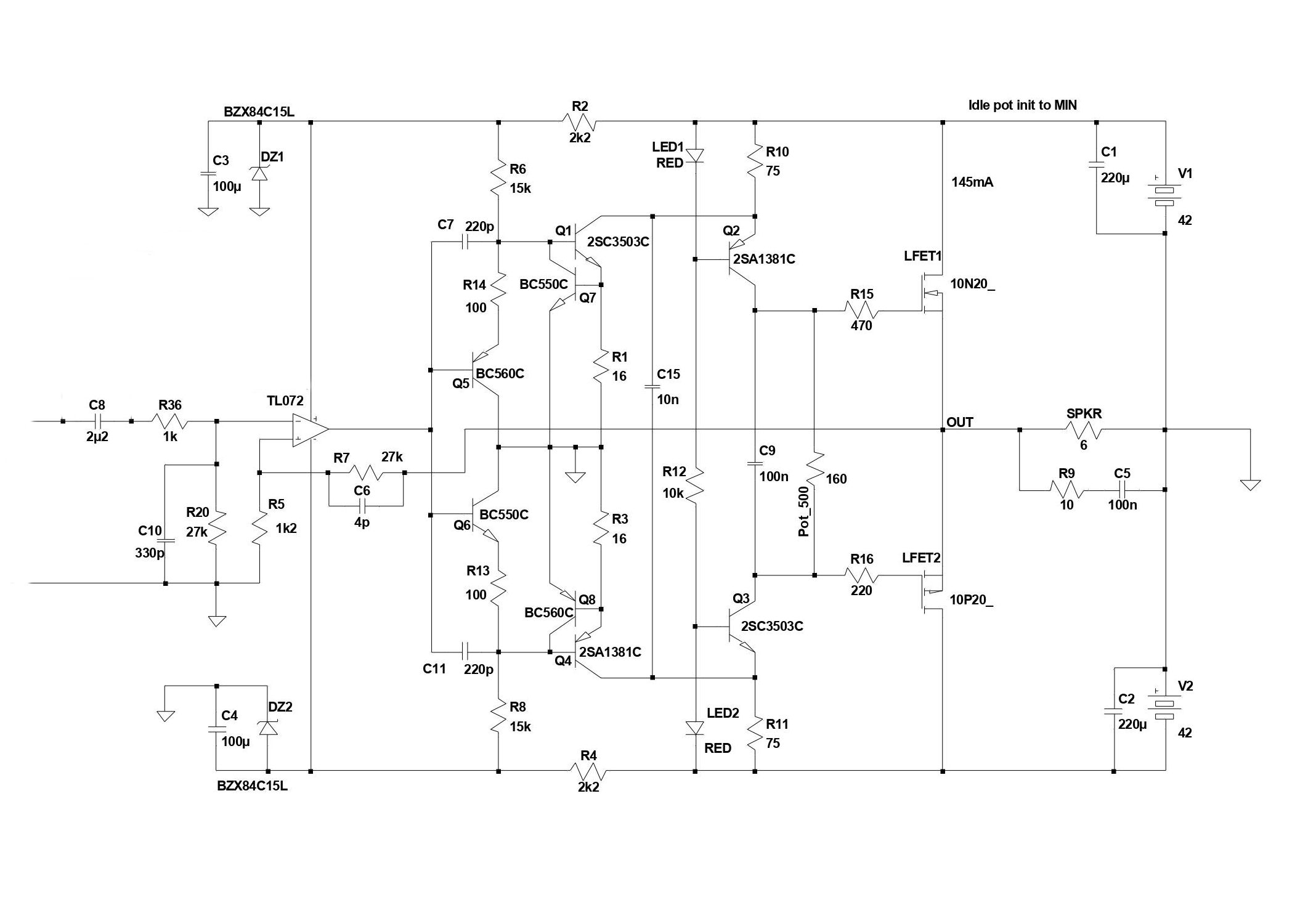

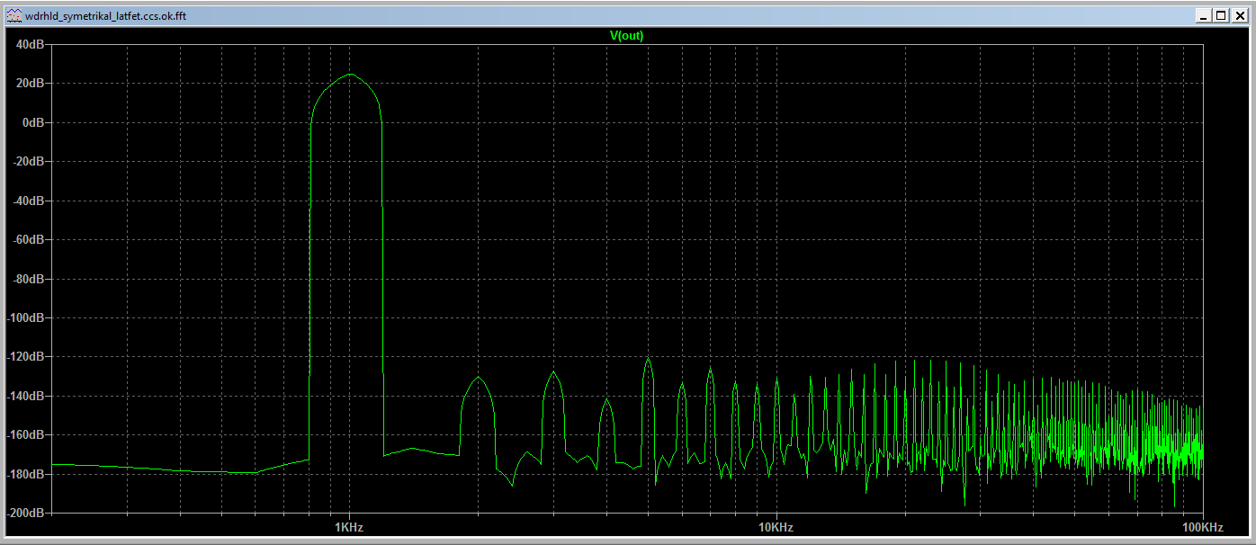

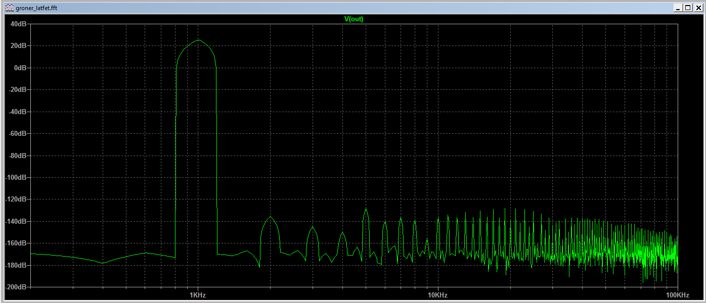

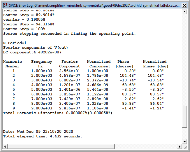

Here is another attempt, so far I think giving the best results (symmetrical without inductors 🙂 )
Basically this is Wiederhold, with slightly different biasing, and CCS added to keep symmetry as even as possible. Without the CCS, symmetry was questionable at best...
From what I see, square waves always look good/acceptable in most of simulations we posted here so far, if output is below 30Vpp.
Real problems to smooth them out, and keep rise time low at the same time, show up only at higher amplitude of input signal (E.g. output Vpp = 50V).
In .asc file R6/R8 have small caps added to smooth square waves
at 50V amplitude (not shown in the jpg image).
Diodes biasing Q1/Q4 must be LEDs, not 1n4148.
Slew Rate is approx 50..60 V/us

Check the clip on the amp output and the op amp output.
In fact, there is no speed higher than 20 V / microseconds in sound
Check ac coupled input distortion.
You will find something near to 0.005%. It means your input load resistence R20 is too low or you need a bigger C8
With sufficiently big input cap, these distortions disappear.

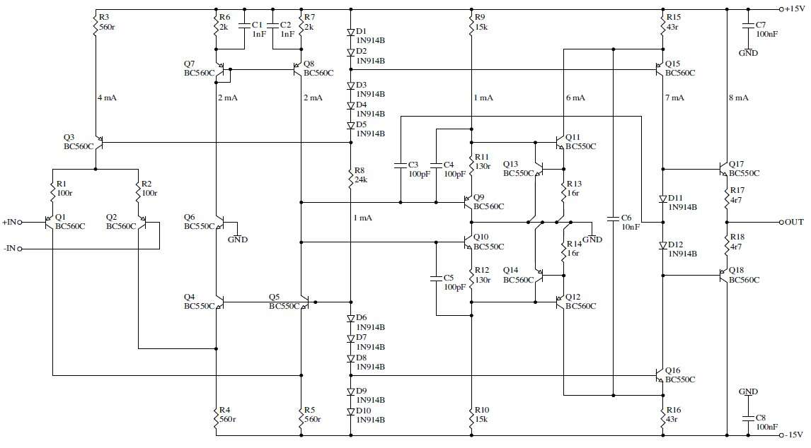

Groner's amp

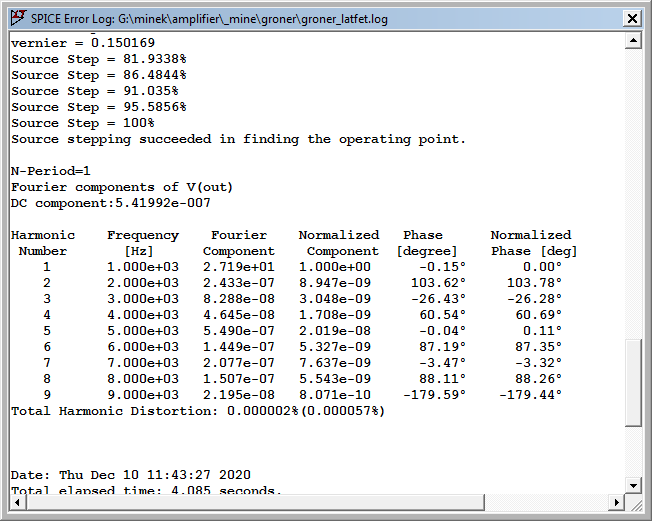

Here is something new - Samuel Groner's topology, with input LTP replaced by opamp. Looks almost like Wiederhold 🙂
Groner's article is available on Linear Audio ($$), and there was some discussion here, on DIYAudio:
Samuel Groner's New Audio Amplifier Topology Article
Looks quiet promising.. Square waves also OK.

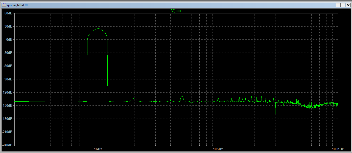

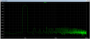

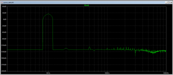

Previous symmetrical versions of LP never simmed right for me..
Either slow, or square waves not good.
This one also gives slightly better numbers/graphs.

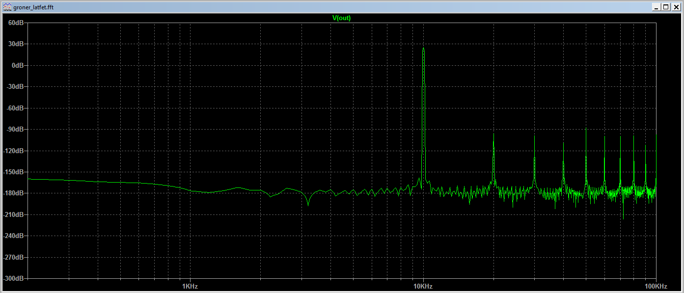

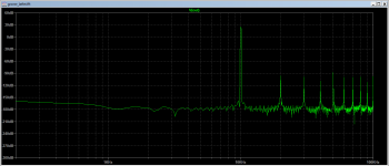

The spectrum relative to 1 kHz and the band up to 100 kHz mean nothing. Better a 10 kHz main tone and a 100 kHz band graph and cut out at the bottom of 500-600 Hz.Then the graph is informative
