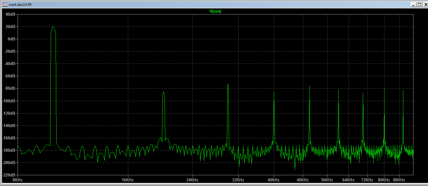

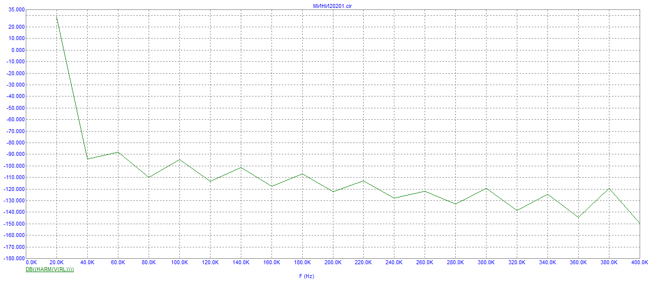

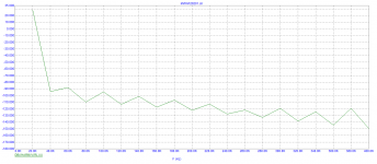

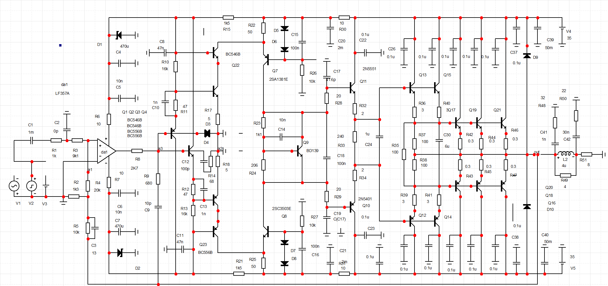

Microcap draws a little differently,but I'll try to show a similar picture
This graph has less details compared to ltspice's graph, but
generally speaking it's very similar to what I posted...

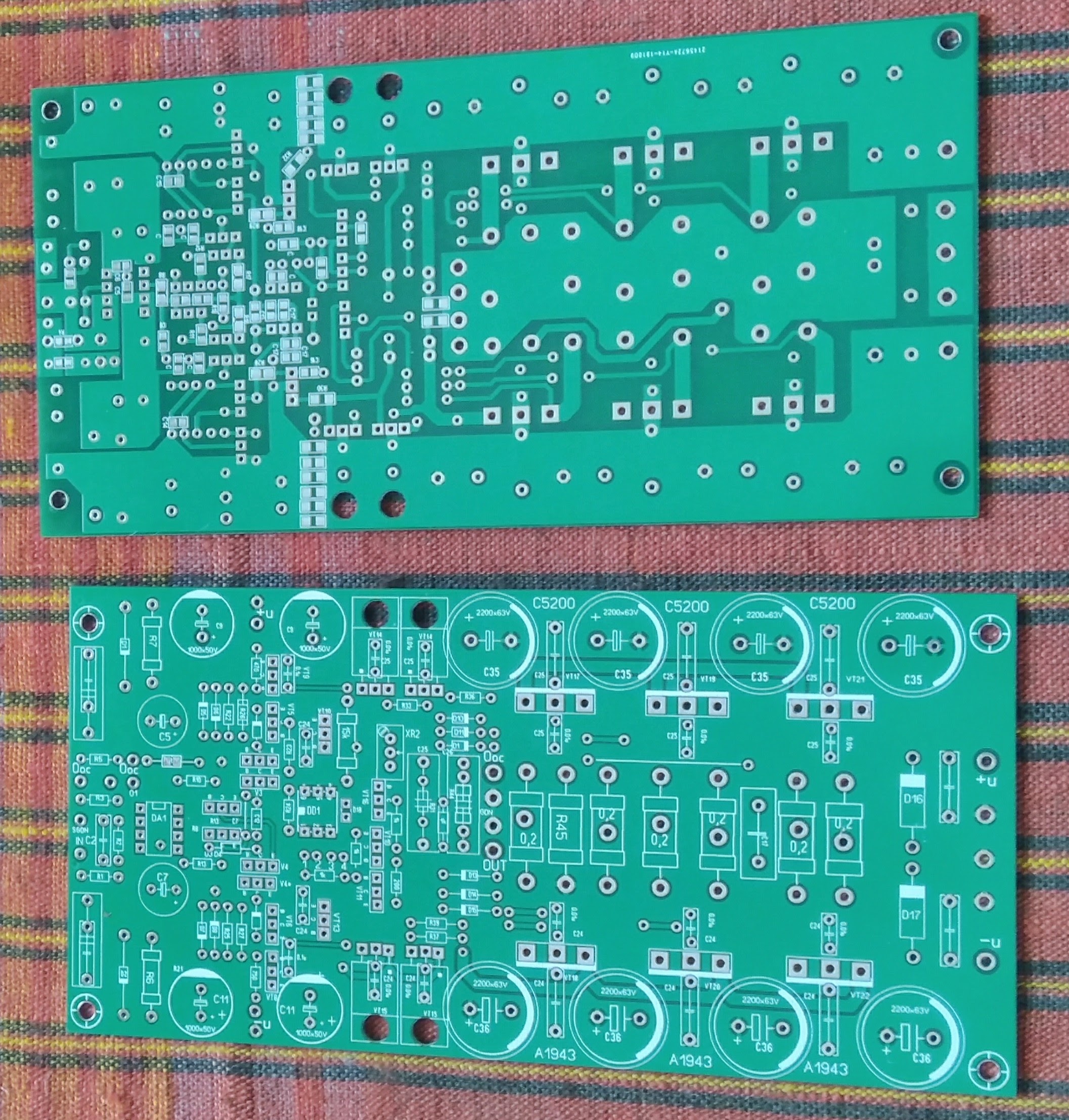

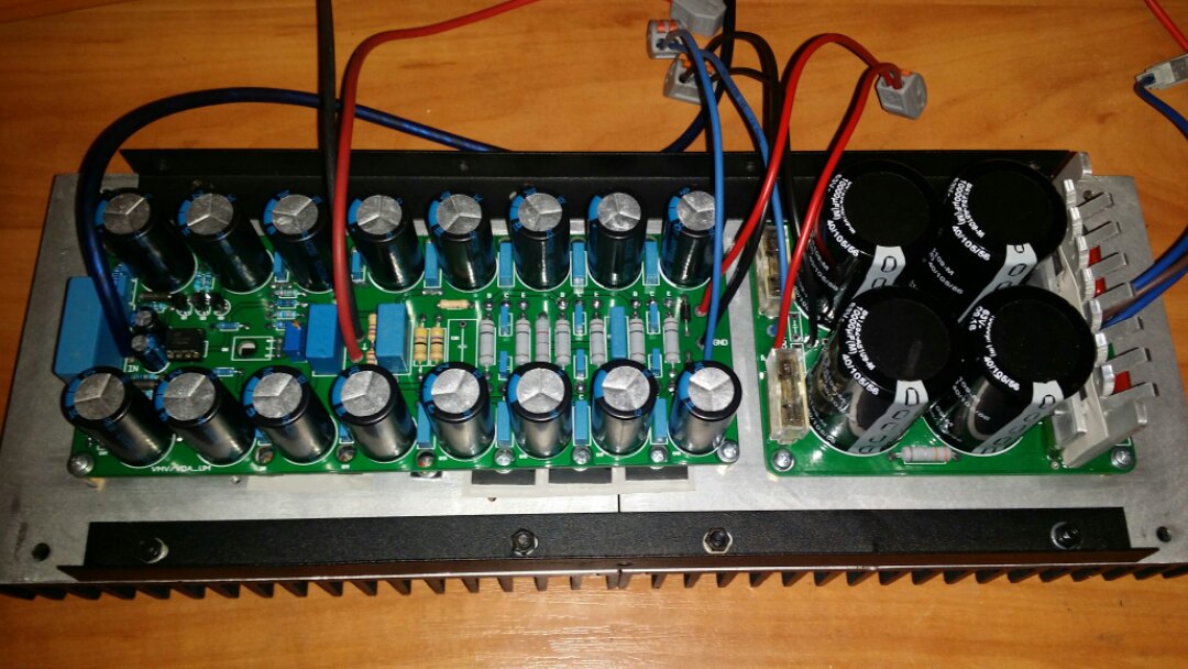

Impressive thread! I try to follow / understand, but there were so many versions I am not sure which one is the one to build. So may I ask which one sounds best? I would prefer a discrete version without opamps, and also I tend to like BJT quasi output stages, but if latfets or hexfets sound even better I would be tempted too!
As I wrote in one of the previous messages:
> I'll give $100 to anyone who will distinguish any of these amps in blind listening test
So that's for "which amp sounds the best" question.
From the 3 amps I built in this thread: Lomakin & Parshin BJT, Wiederhold77 Latfet, and Wiederhold77 Quasi HexFet - if I was to build another one I would do Wiederhold77 Latfet.
Simple to build, and theoretically should be sounding the best (disputable opinion).
Lomakin in Parshin is also simple and smaller - I built it with 1 pair of output devices.

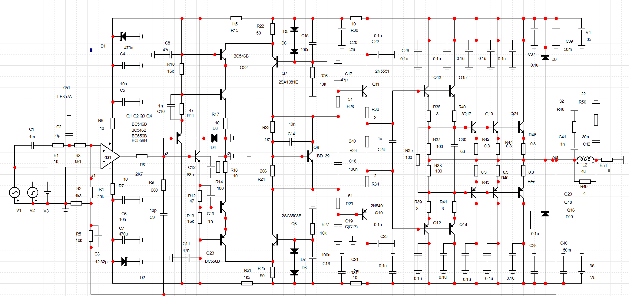

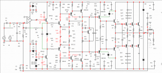

Circuits with a very large loop gain. The presence of an oscilloscope will help in the construction, although an experienced colleague can cope without it .
I can show you a symmetrical amplifier circuit . Slightly different topology.

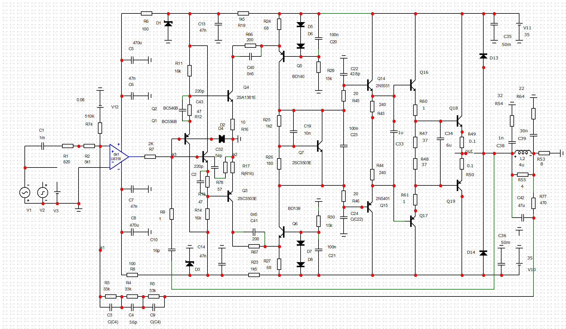

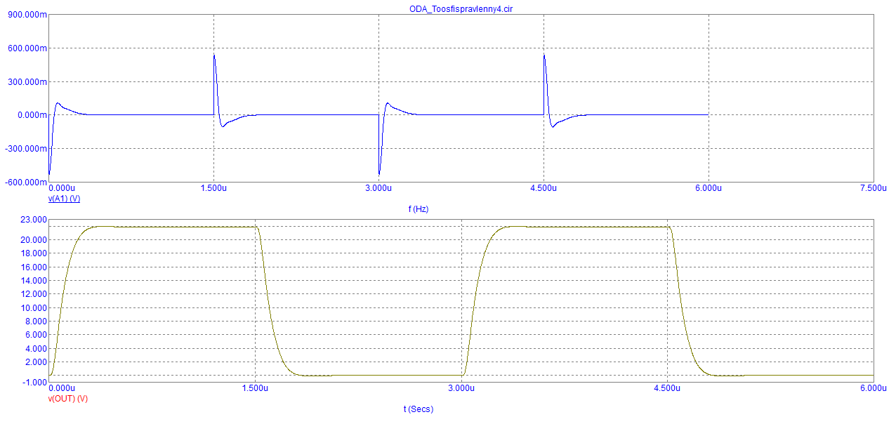

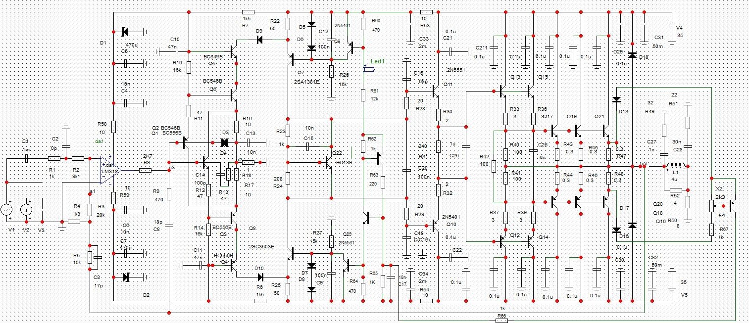

Maxim, I'm referring to your amp from post #595, this seems to be the "latest and greatest" from you.
As for asymmetrical design, this one gives so far the best overall results, except:
1) high amplitude (50Vpp) square waves have ugly kinks, and need further improvements
2) making these squares better, will slow down the amp, to basically the same speed as standard LMK/Wiederhold.
15V/us seems enough for any normal amp, but I would like to try something faster. No point to build the same thing again and again 🙂
3) This amp will be tricky to build in practical terms: all of these devices affect stability, and the margin of stability, even in the sim, is thin: C6, C7, C10, R6, L2, C17, C18 - in real build this will be a nightmare.
Do you think a better version of this design is possible?
Symmetrical? Simpler?
Here is a simple circuit with a gain of 94 dB at 20 kHz. Distortion is also minimal.
The slew rate has been increased . .
This is traditional (EF) VAS, not folded cascode...
That's something else, but perhaps worth trying. Nothing wrong with EF VAS, actually this might be the best one 🙂

What is that last transistor on the right side?
DC detect and protection? Overcurrent protection?
Overload protection based on thyristor analog .
Without protection
Without protection

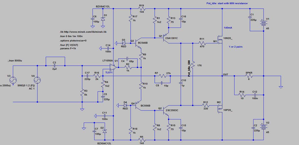

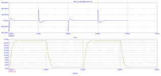

If we decide to use normal VAS - not a folded cascode like LMK or Wiederhold, here is a simple amp based on Crest topology.
Gives great results, SR approx 60V/us,
very good square waves, and frequency profile.
For such simple amp - great results..
FFT/Thd screenshots at 10kHz.

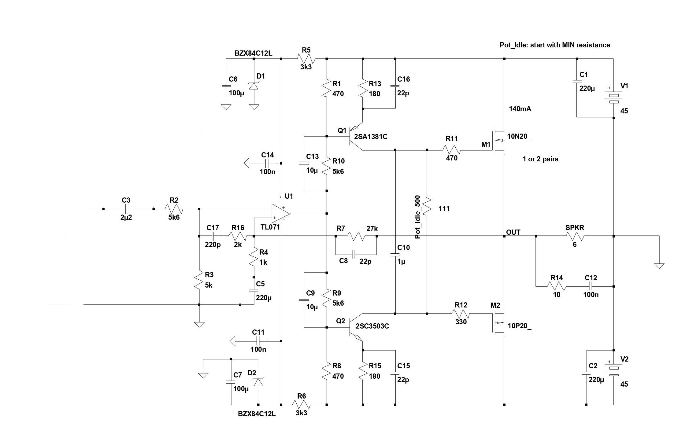

This one - same VAS, but extra buffer added between op-amp and VAS is even better.
Lower Thd, beter FFT, faster Slew Rate (60V/us), very stable, and easy to compensate.
This is also based on Crest amp.
Kind of similar to the Philips amp I was testing few pages ago, but with different (better) VAS compensation,
