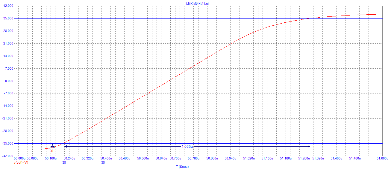

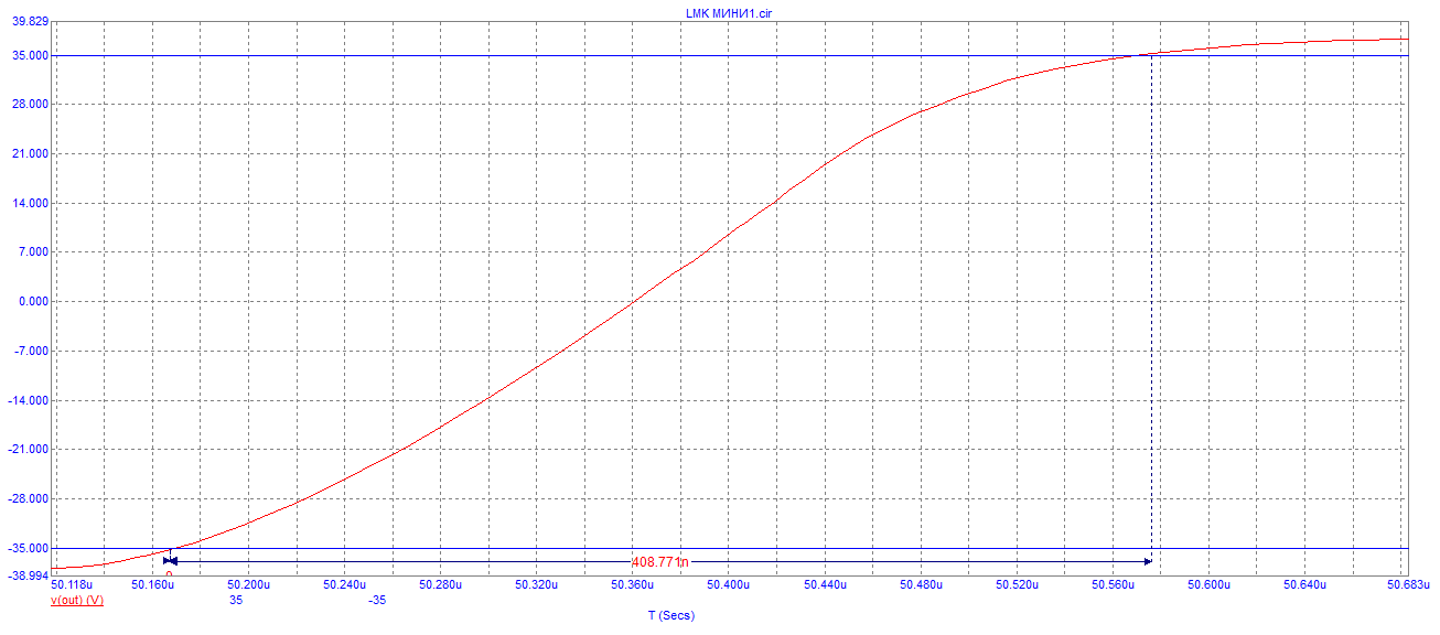

What exactly is your rise time? Hard to tell from your square plot. Can you zoom it to show on rise slope?
OK/
So for you it 0.5 us, and for me 2us.
Huge difference! Why?

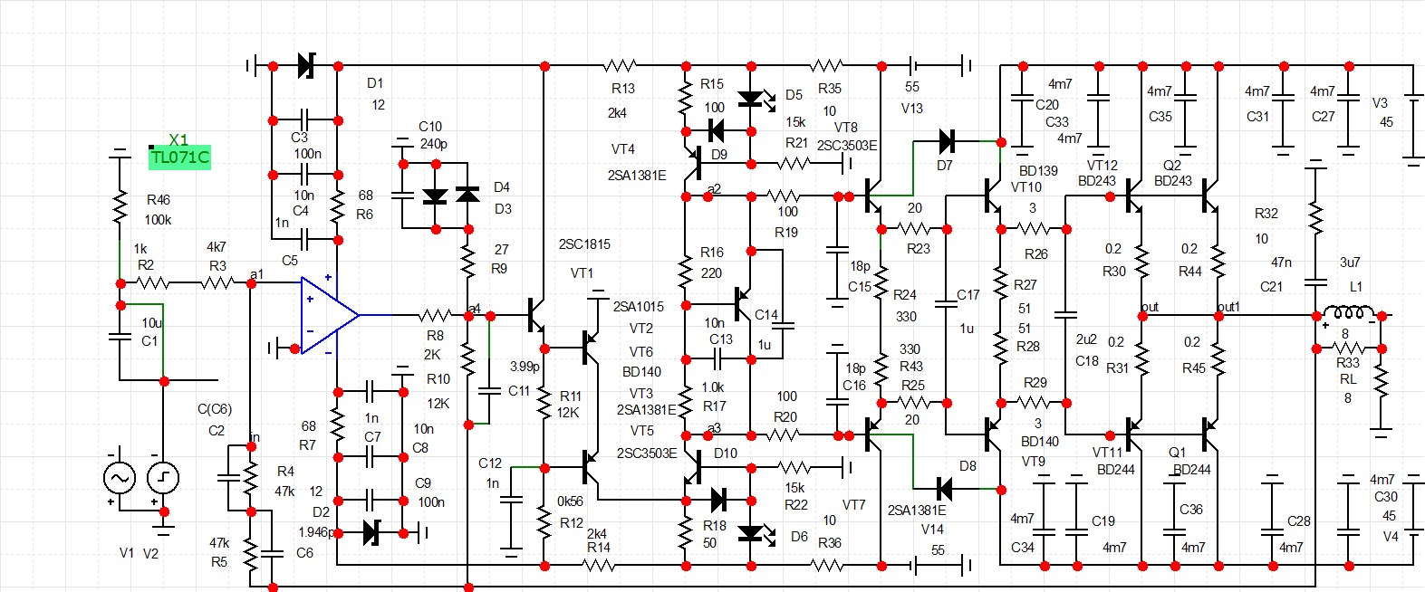

See my schematic I just posted (post #900)...
You have different op-amp; but I tested other simulations with TL071, and these amps are definitely capable to do slew rate 100V/us with this or similar topology, so I don't think it's an op-amp issue - unless your latest amp demands higher current from the op-amp, that LF357 can provide, and TL071 can not - but I highly doubt this is the reason..

I didn't understand. Better show your similar schedule. Even in GIFs, at least in LTS The spice.I will compare.
tl071 slow opamp. Put ad711 in the model

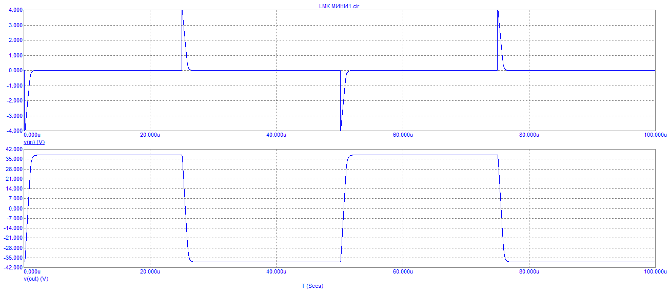

If I try C6=2pF (like in your schematic), rise time is still 2 microseconds, but square waves have ugly kinks, so it has to be 5pF.

Well, C11 who will reduce with a slow opamp ?R10 will reduce to 12 k. C11 according to the best form of the difference signal to choose.Opamp ad711 in the LTS is
I tried with R18 at 12k, didn't make any difference.
Should I try to skip C7?

>конденсатор С7 подобрать
What is " подобрать" ??
I guess it doesn't mean 'skip'...
Try different values? Will try smaller values.

Can't go lower then 12pF on C7. Square waves start oscillating...

Maxim, when simulating all these amps, including yours, I tried to make them faster by playing with compensation and feedback values. So I went through these kind of adjustments already...
I'm telling you - I couldn't make them faster without deforming square waves.
It was always a compromise between square waves quality, and speed.

My conclusion so far - it's relatively easy to DOUBLE slew rate of LMK topology (folded cascode VAS), by making it symmetrical. But I don't see a way to make it faster than that..

The AD711 works well with opamp.C17/c18 with 47pf it is necessary to reduce capacities. I can't reduce it.replaced by 12pf
In the Russian forum, the OPamp band is limited by a capacitor of 100-200 pF from the output to the inverting input. GNFB - as usual.

Yes, that's true, but in these cases here, capacitance is much lower, isn't it?
Even with TL071, amp from post #882 was achieving 100V/us.
To me looks like the limitation factor here is the folded cascode VAS...
