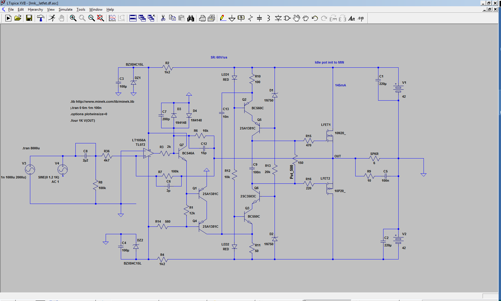

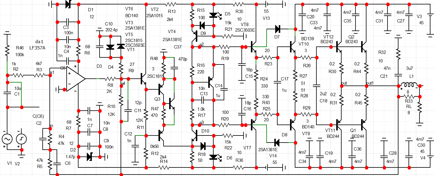

I do not put a capacitor in the filter at the input of the amplifier.

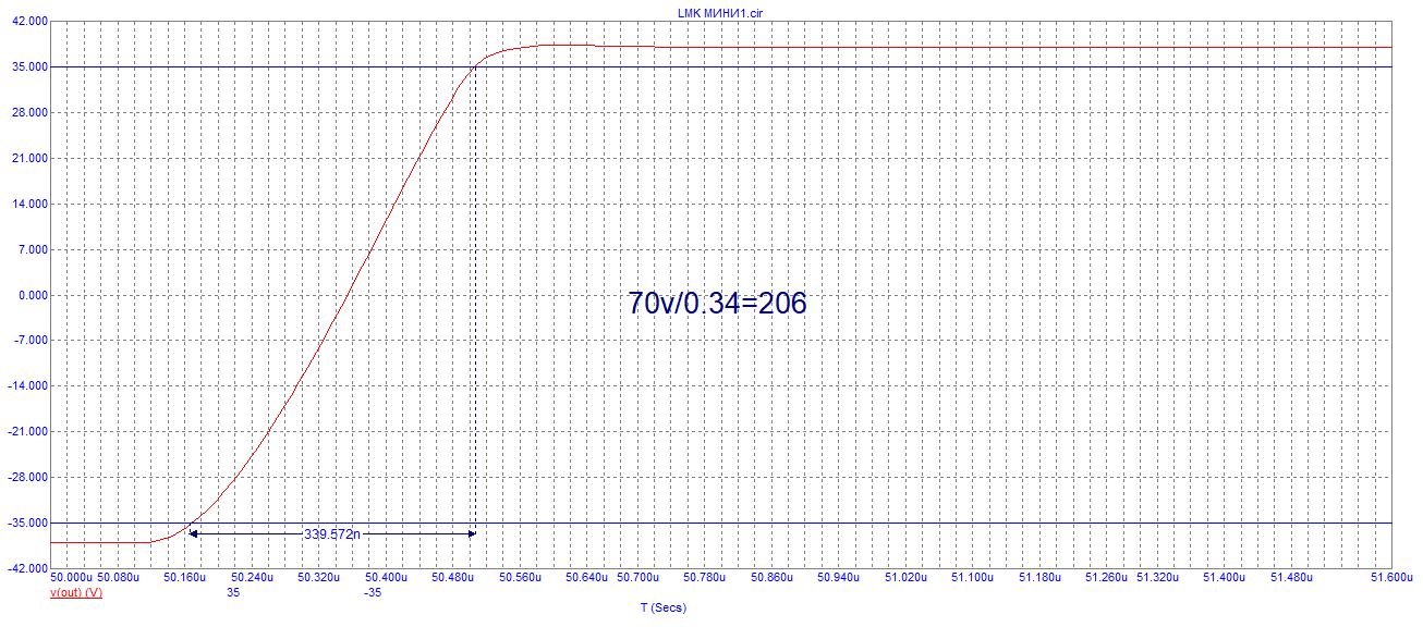

The achieved speed is enough, the main thing is the linearity of the amplifier . A cleaner sound
No. This does not affect the speed, only affects the frequency of the single gain.Perhaps C10 in Maxim's schematic counts here and slows the amp down?
In a Microcap with tl071.The speed dropped significantly.
It's a pity I'm not good at lts
What happens if you try LT1056?
the correction values matched yours. there is no capacitance at the input of the amplifier.What happens if you try LT1056?
I agree that achieved slew rate is sufficient, that's not why I'm trying to squeeze more speed from it... it's just a game. To me all these amps sound the same anyway 🙂

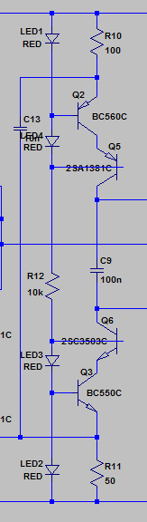

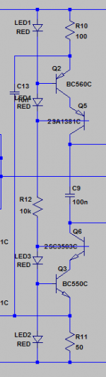

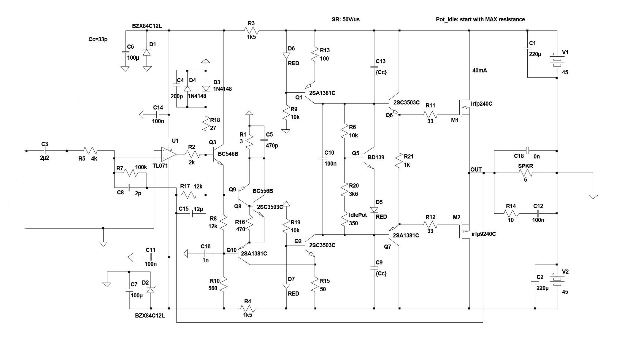

Here is double folded cascode VAS - gives twice the speed of normal LMK VAS.
Perhaps it will improve your amp?
Вот каскод VAS, сложенный вдвое - дает вдвое большую скорость, чем обычный LMK VAS. Может, это улучшит твой усилок?
By introducing an emitter follower, the speed can be doubled.The printed circuit board is easier to get

I know how this is going to end - you are going to add a coil to it...

Do not use the coil. .kg still doesn't change.If the loop gain was greater, then the result would be, and so there is no sense.I thought you went to sleep 🙂

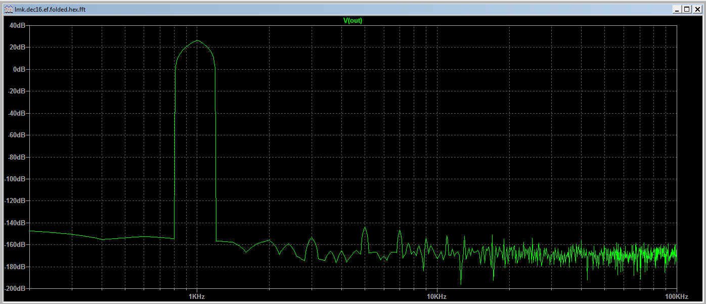

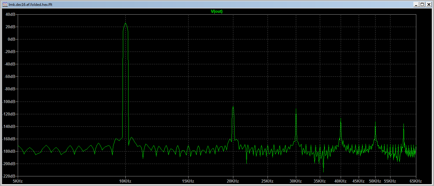

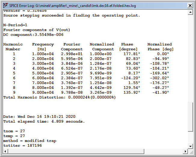

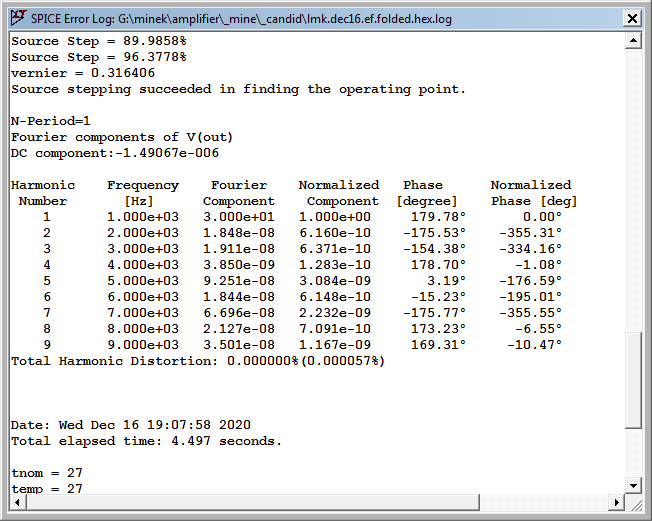

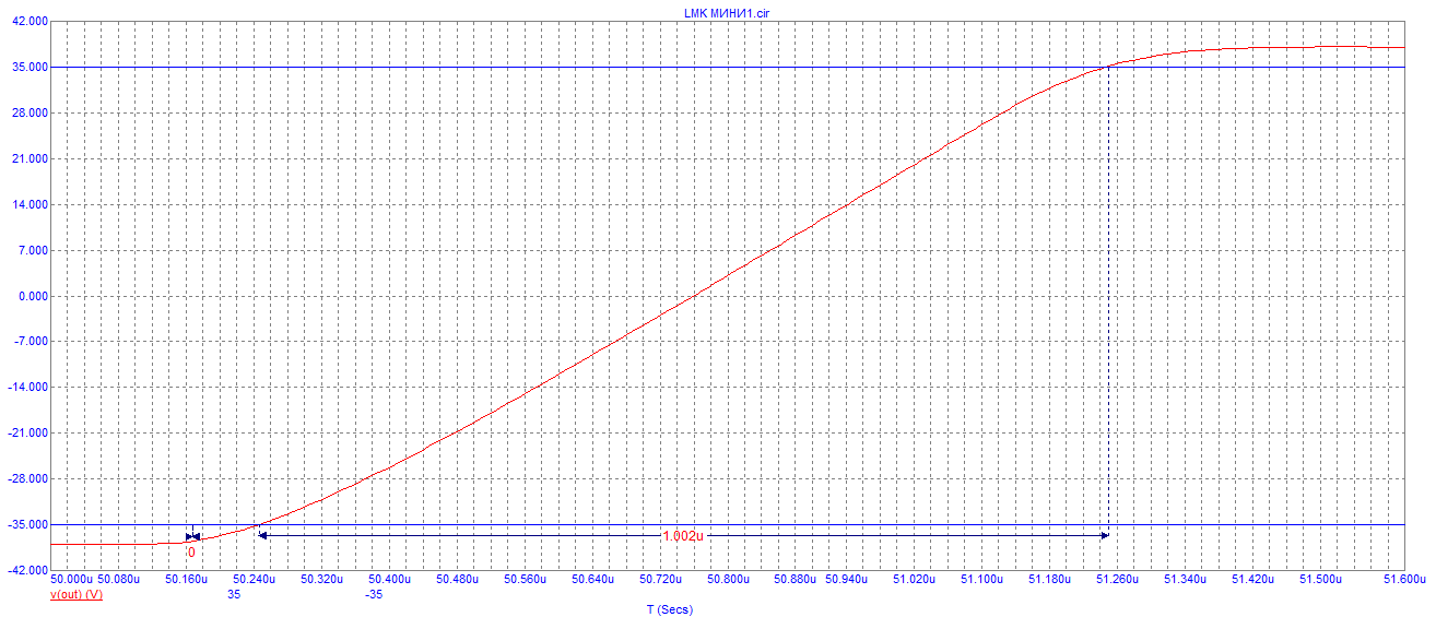

In the model, the distortion is very low.Very small.
That's the lowest Thd, and best frequency spectrum so far.

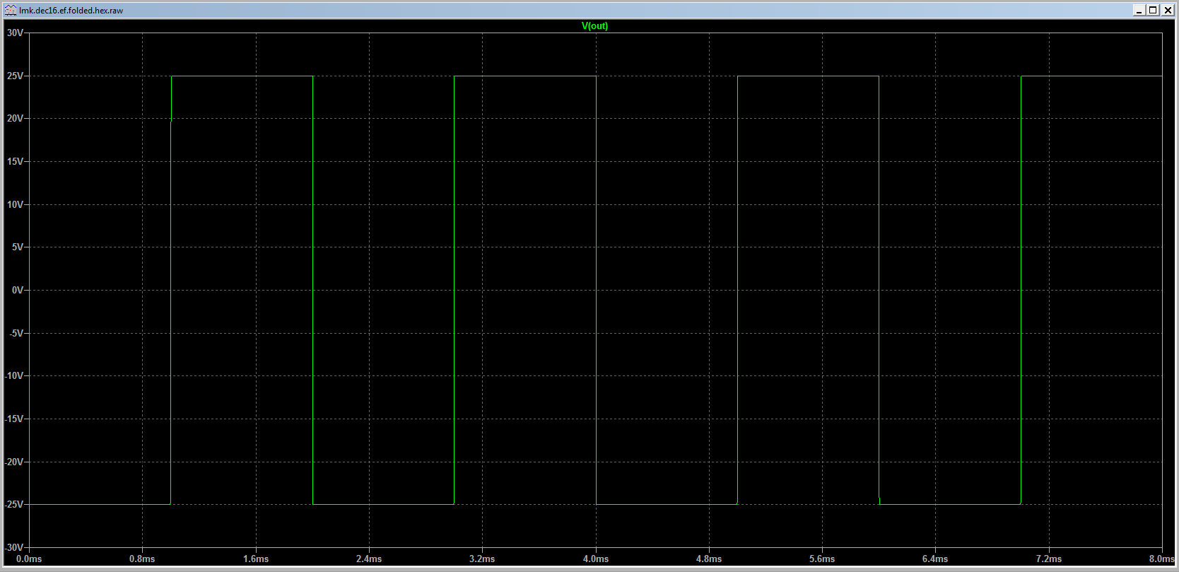

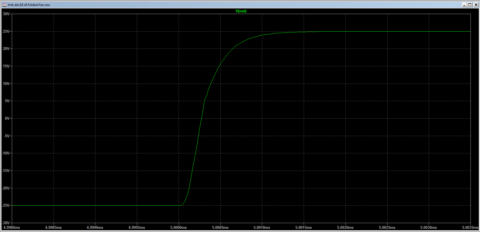

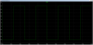

Slew rate: 50V/us - very respectable.
Results here for 1kHz and 10kHz input.
Correction: Zener resistors (R3/R4) should be 3k. Zener current is too high with 1k5 values.

This version, with double folded VAS, lowers the floor of FFT graph by a few decibels, and allows for (small) increase in speed.
Please check; not sure if it's worth it...
