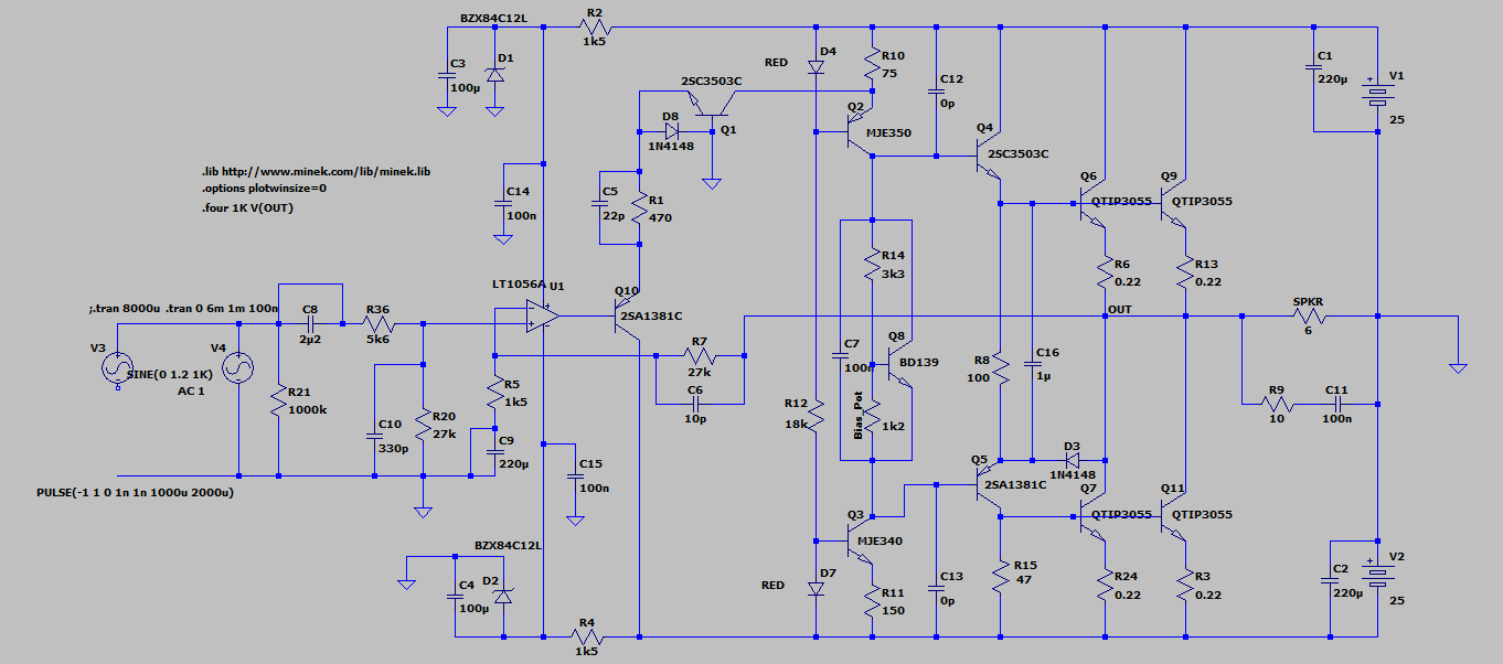

As for a diode at CCS: I've never seen yet a non-electrolytic capacitor to get damaged/shorted. Doesn't happen often I guess?

The 1n4148 diode is a cheap element, and in case of an accident it will save you

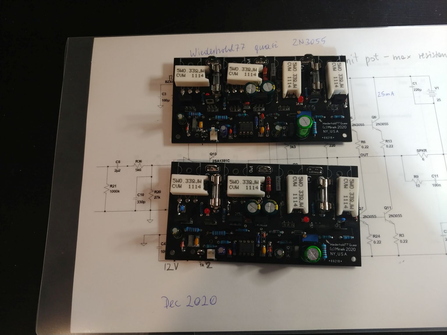

I've never seen this setup in any quasi amp before.
But I'll try it in the next quasi amp I build.
The Baxandal diode provides better symmetry of the quasi-complementary stage.
Simulates a P-N transition.
JLH used an additional 100 ohm shunt resistor and a 10-20nf capacitor.
Shaw used a powerful diode in the collector of the output transistor. Very effective on small signal without GNFB.
Pashinin used a diode-connected transistor.
Look closer. Baxandall diode is still there, but it's now called Steve's diode 🙂
Additional capacitor was making everything worse. Not needed here..
I tried it.
I tried it.
Try to sim this amp with and without Baxandall capacitor...
This was discussed earlier in this thread...

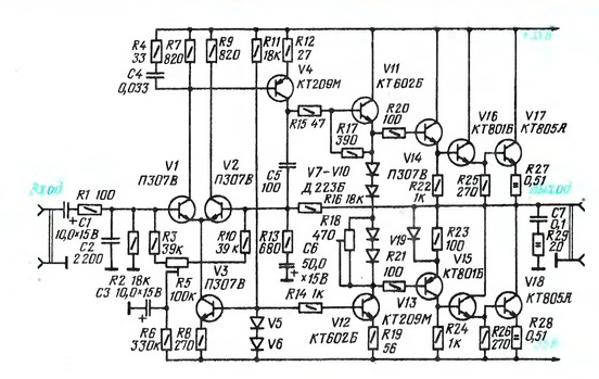

Maybe 'quad' topology?
Too complicated..
Famous GB amp Quad-303 (triplet output Stage)
Brig-001 (former USSR))
- Unusual amp from 1987
