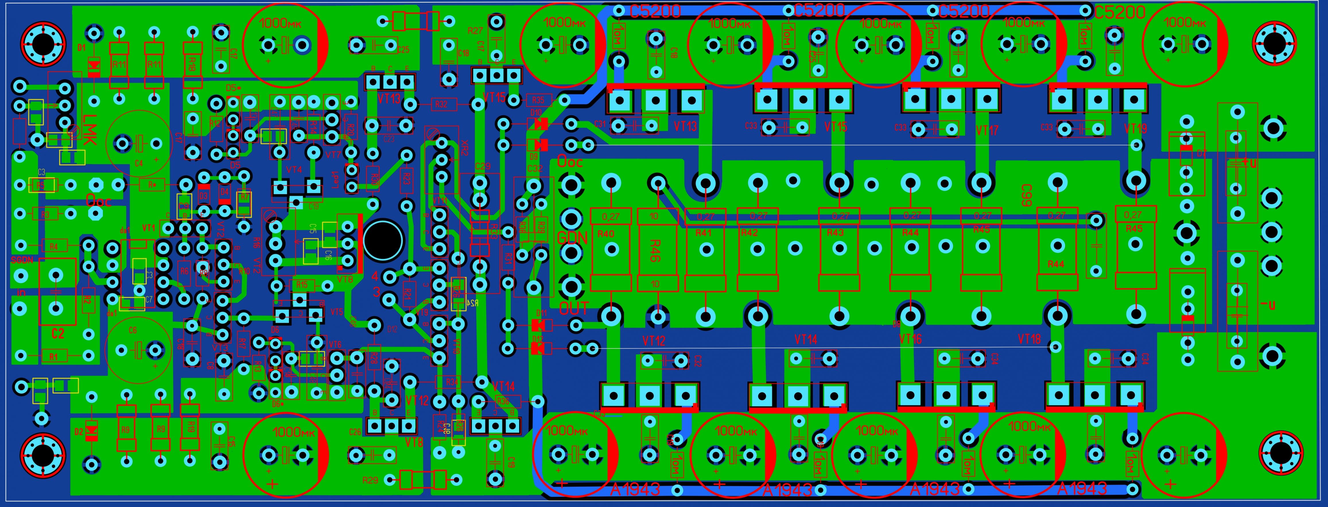

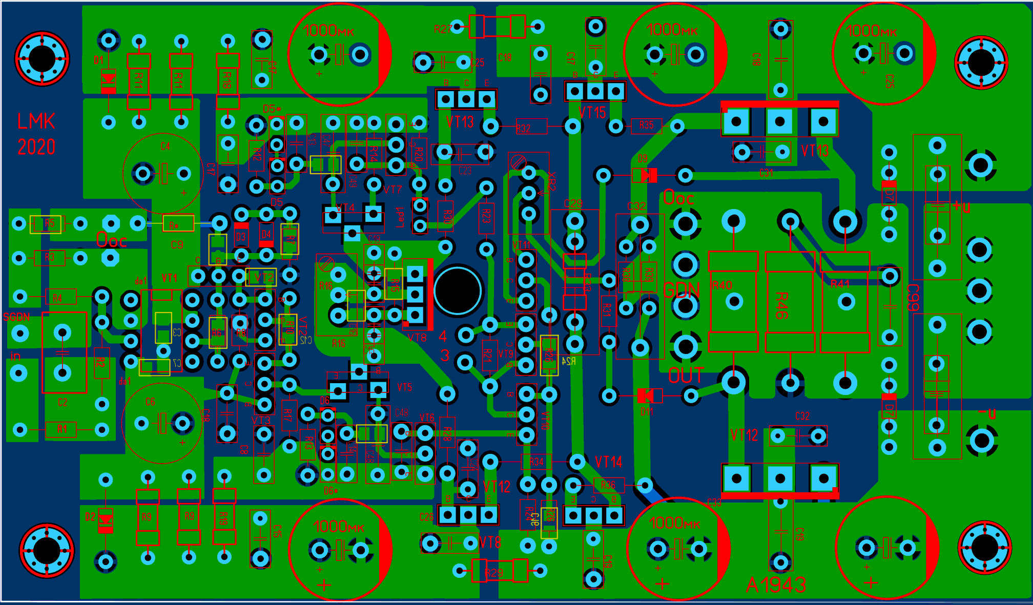

The Board for 4 pairs of bipolar transistors is ready to order .
I'll just make some changes and that's it.
Эскиз . Sketch
Do you need overload protection ? How many pairs of exits ? 2 ? 4 ?
Always ready.
Эскиз . Sketch

Power supply 40volt VC .UN -50volt. For 3 pairs of a1943/C5200 Bipolars, the a1837/C4793 pair was enough . The First Is A1380/C3502.Everything worked perfectly in the monster.
What are the dimensions of your PCB?

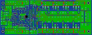

I checked the max size of my aluminum chassis - looks like I will build 2 pairs of outputs (per channel) version. But I need all power transistors to be lined up on one edge of the PCB.
I don't want this whole amp to be bigger/wider than my last 2 builds (Wiederhold Quasi), which comes to 32cm (width) by16cm (depth).
2SC3503 / 2SA1381 will be fine for 2 pairs.
So I guess I'll design my own PCB...

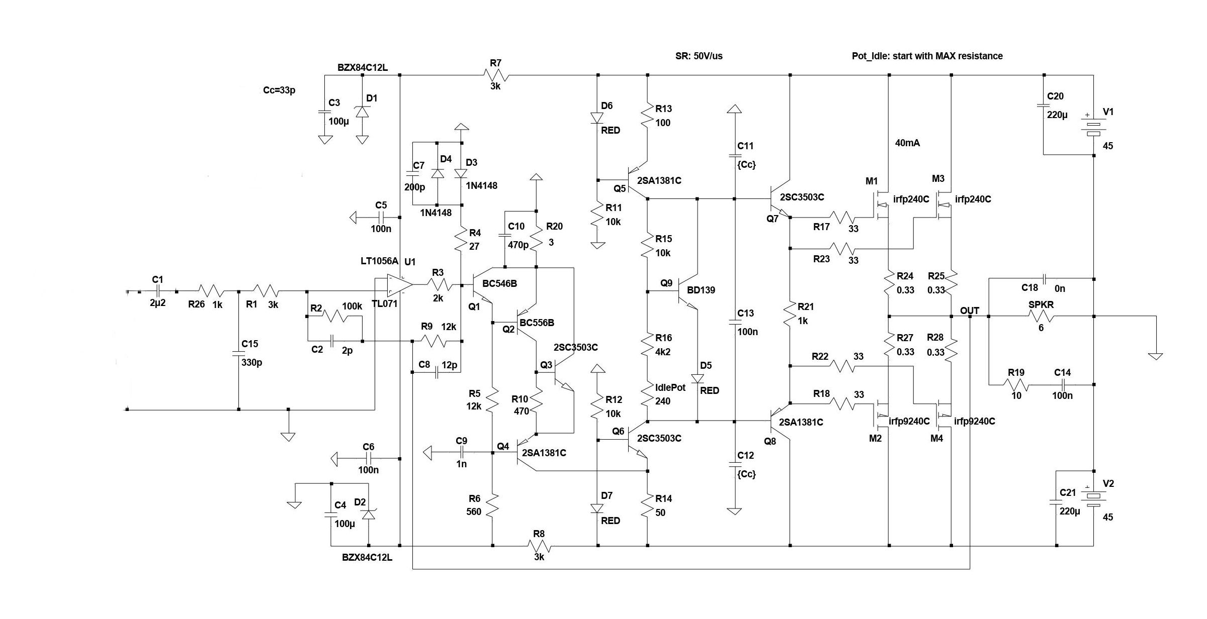

So this is the schematic I'm going to design PCB for.
If I have enough space, will also try to accommodate quasi version on the same PCB.
This should be good for BJTs and HexFets.
Basic differences between Maxim's and mine will be:
a) same rails for all stages (no higher rails for VAS)
b) double output transistors vs triples
c) support for BJT/HexFet complementary/quasi on the same PCB
d) less filtering capacitors (I want to make it small..)
e) output RL no implemented (I have it on the speaker protection board)
Values of some elements may still change...
