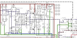

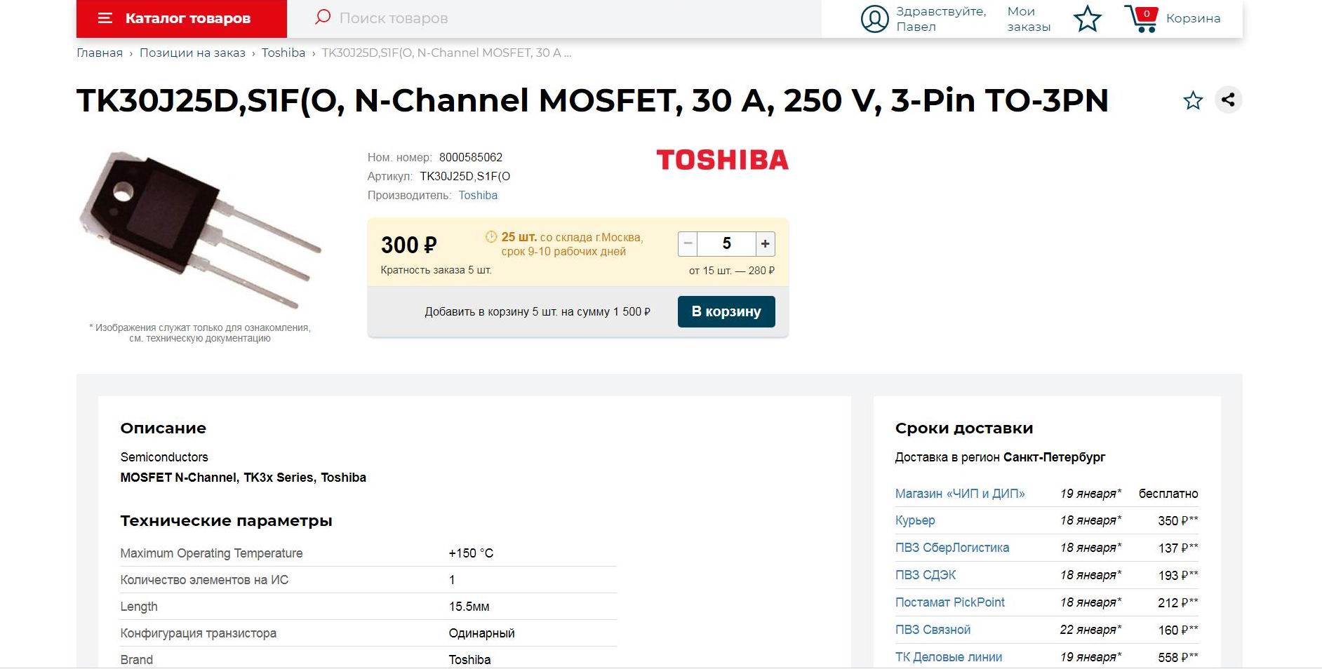

TK30J25D - from that schematic (Denon) looks like they use them just like any other vertical fets.
Should work.
BUT - if you want to experiment - better have spice models for them, and/or good oscilloscope 🙂

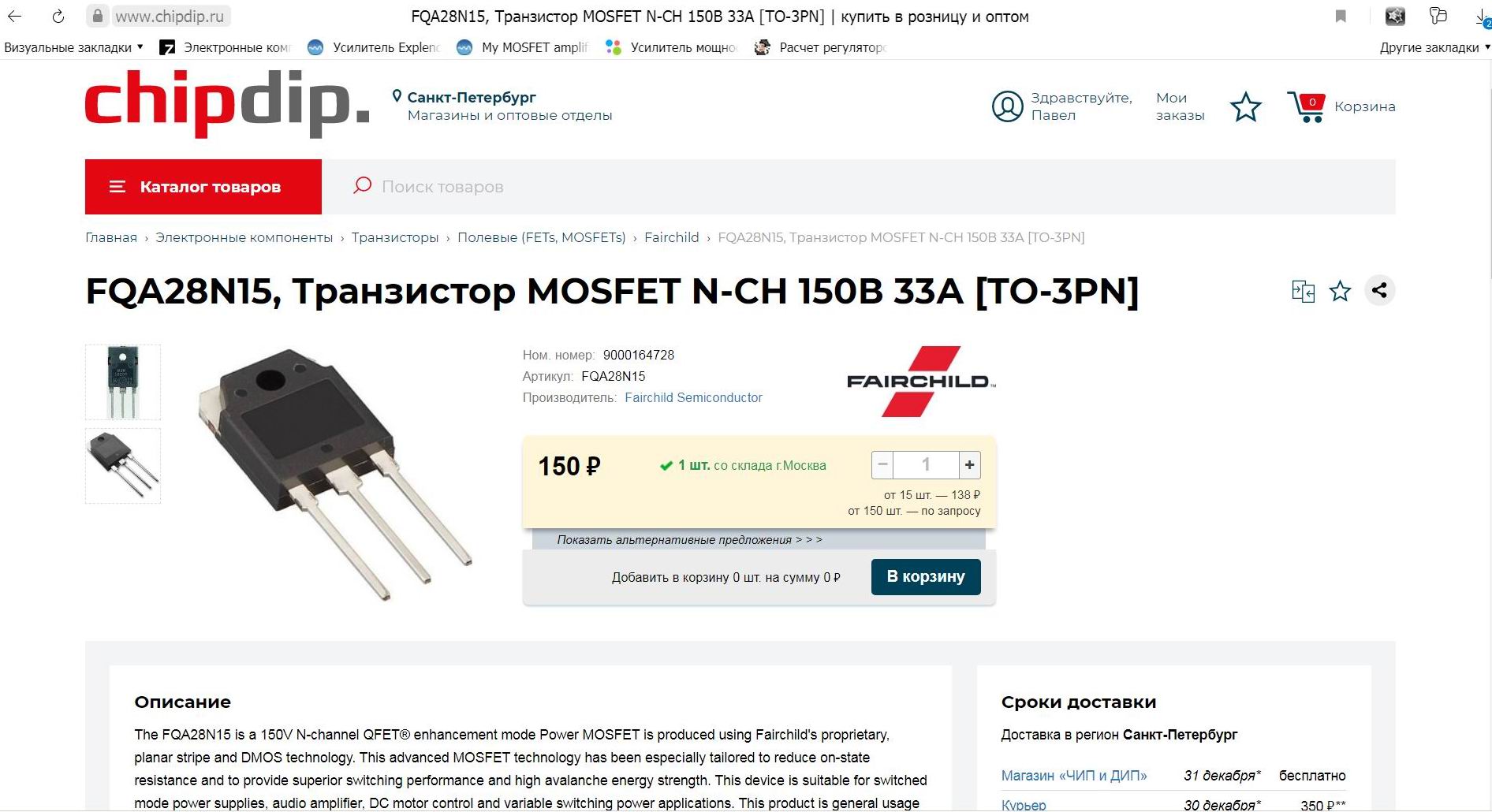

If you are planning to buy them - why not go for OnSemi hexfets?
Should work.

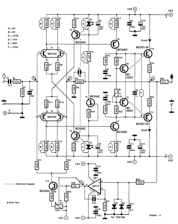

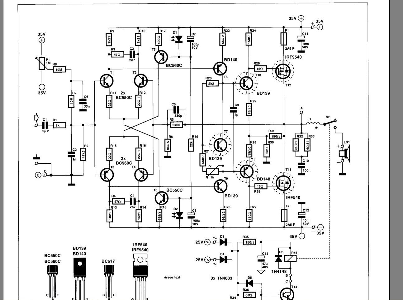

Schematic from #1021:
1) Q3 doesn't need heatsinking.
2) Q4 - it's running at 350mW, so I guess it will survive without heatsinking, but I would recommend placing it on heatsink anyway.
> What are the parameters for selecting LEDs.. Match?
No matching. Just pull them from the bag, and solder to the PCB 🙂
А что мешает использовать диоды КД522/1N4148 ? Здесь не нужны идеинтичные пары источников образцового напряжения в генераторах тока.
And what prevents the use of diodes KD522/1H4148 ? In current generators, there is no need for ideal pairs of reference voltage sources.

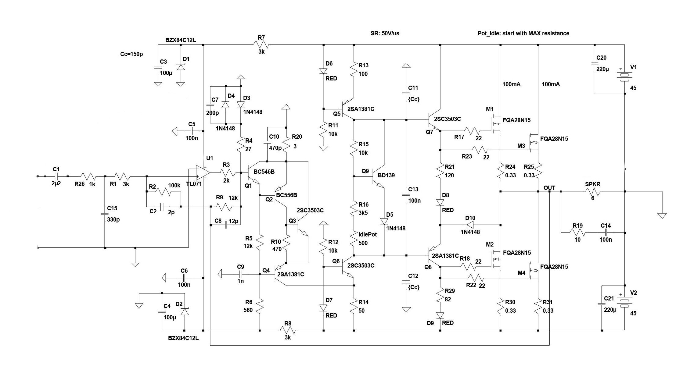

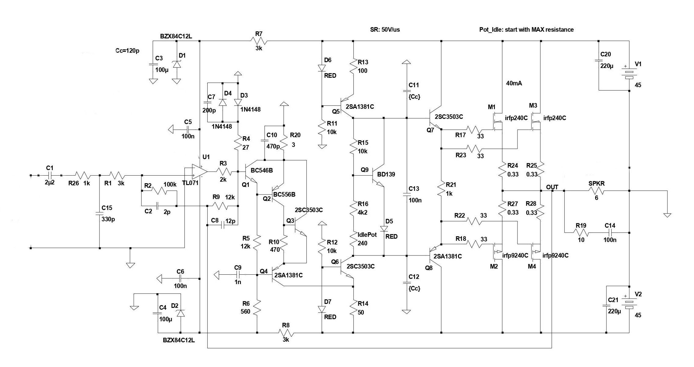

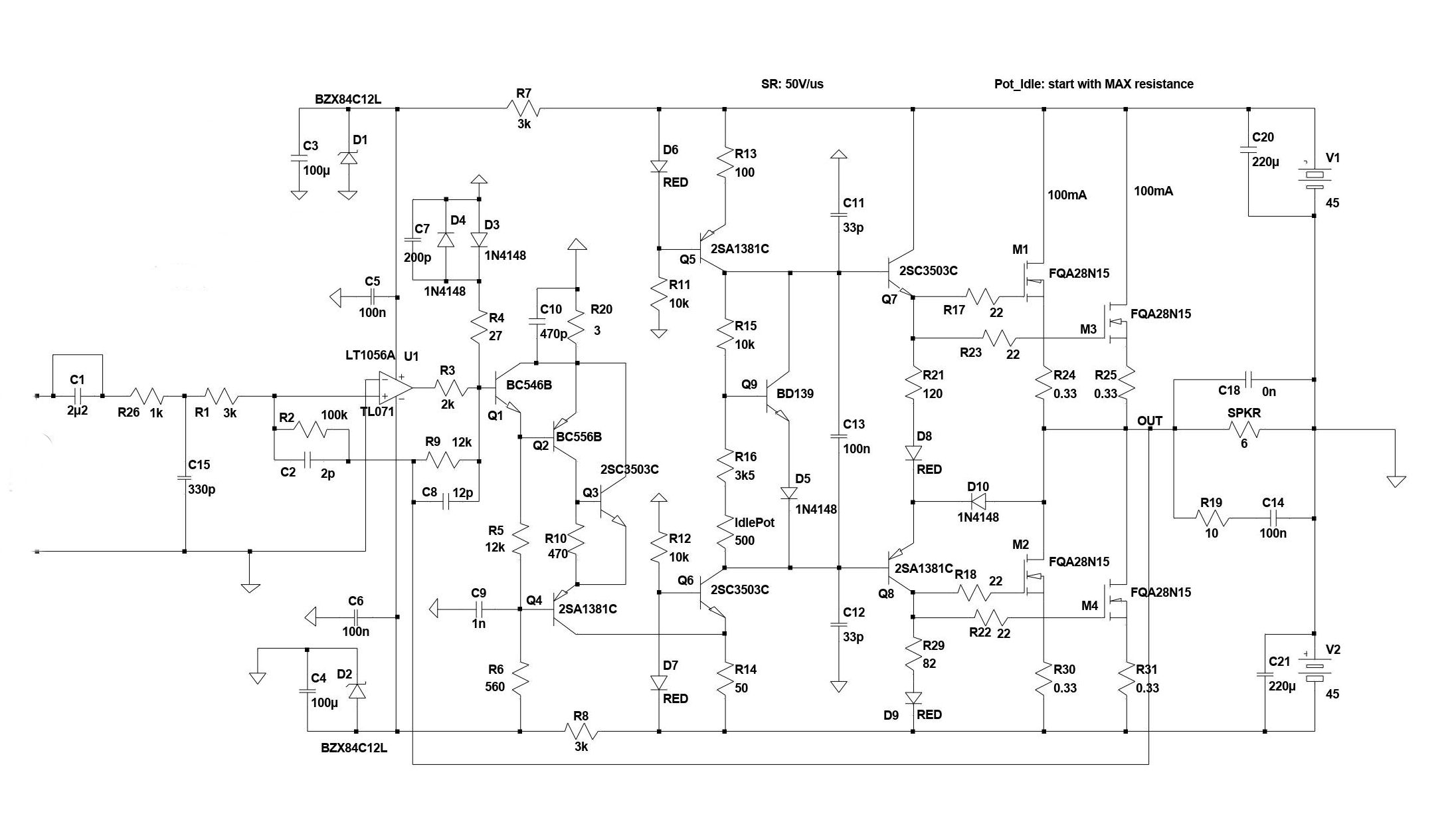

Here are my "final" (?) sims of one complementary HexFet version,
and two versions of Quasi HexFet (with FQA and IRFP260 devices, there are very small differences).
Looks like Maxim's build will be BJT version (triple output), I'm only planning to build HexFet version.
For quasi - not sure yet if I'm gonna use IRFP260 or FQA devices, I guess depends on correct matching.
Have good experience with both of them.
