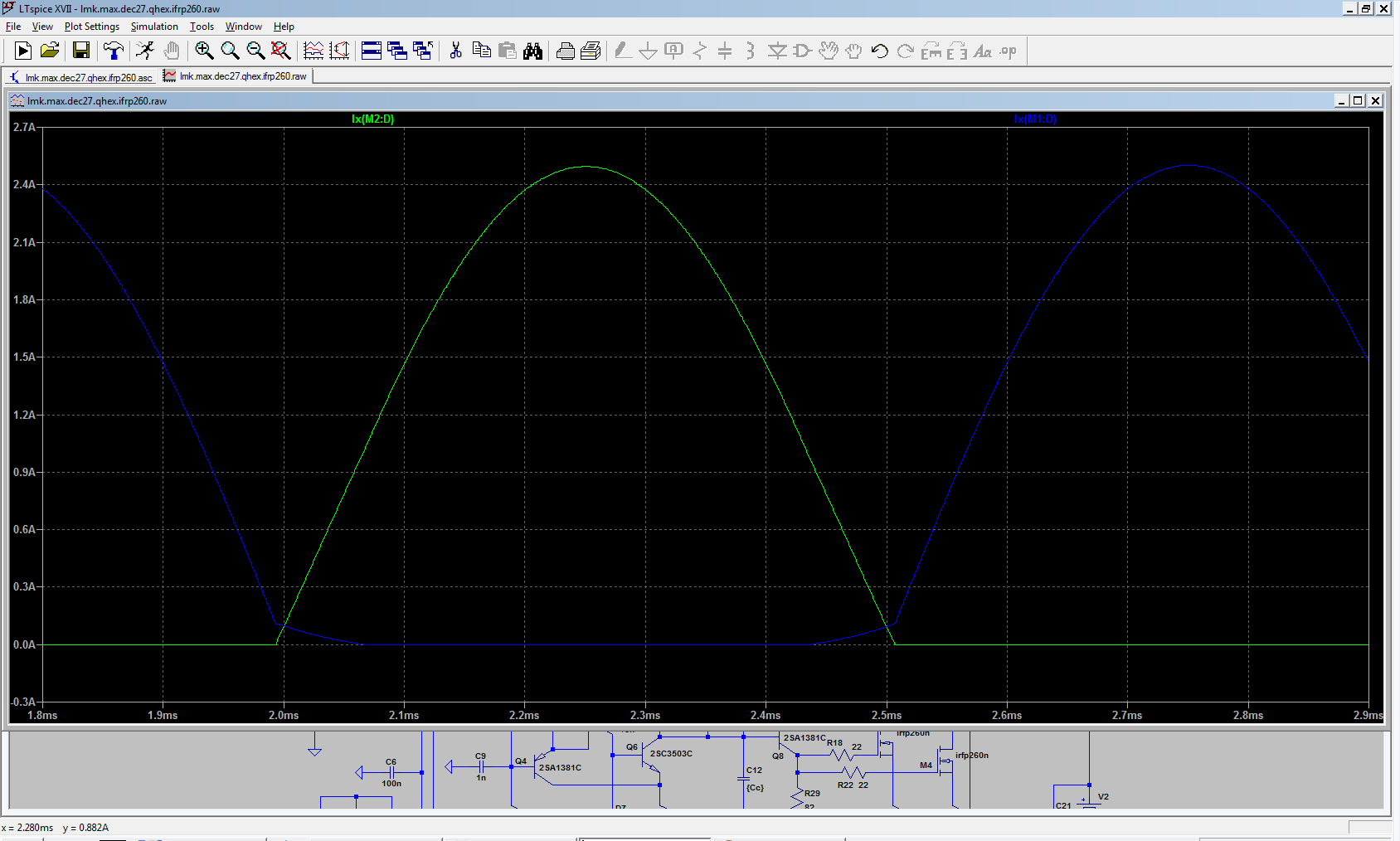

I tried, and on this amp it's impossible to get any kind of non-oscillating square waves without output RL, if even 10n capacitance is added to the speaker.

Please have a look at this plot: this is current flowing through output devices of the quasi hexfet amp.
Upper devices have 'rounded' edges around 0.0V (bottom of the plot), lower devices turn off sharply.
Upper devices are conduction more/longer than lower devices.
Why the difference? Is it good or bad?

>Try placing a capacitor between the emitters of the drivers
It's oscillating with a cap. I tried 1uF and 100nF. Same behavior.
My guess is it's caused by LEDs added by Steve.
It does lower Thd (by half), so perhaps it's OK...
This is kind of experimental-quasi topology 🙂
