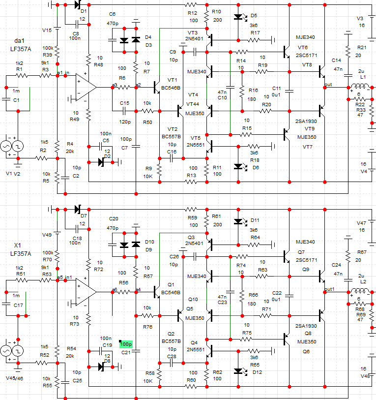

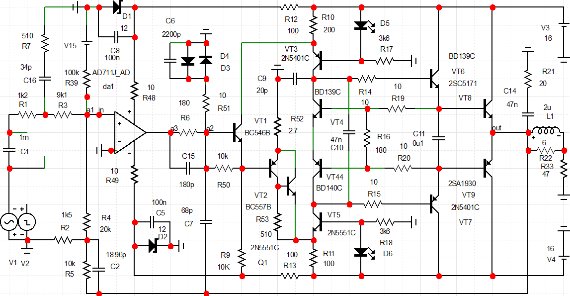

I changed the correction in the LMC . I'll show you the example of a telephone amplifier "Mattur".
Stability has improved significantly.Very decent. C15 parallel to Resistor R6.
