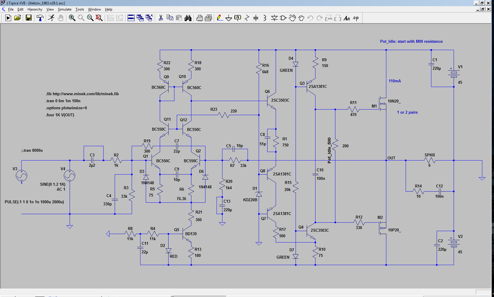

Found service manual for real Revox 285.
Different transistors. Rails 52V
I guess original printout did not show transistor types or values, and someone added it manually.
Luckily, Q109 is not BC327 🙂
add a repeater

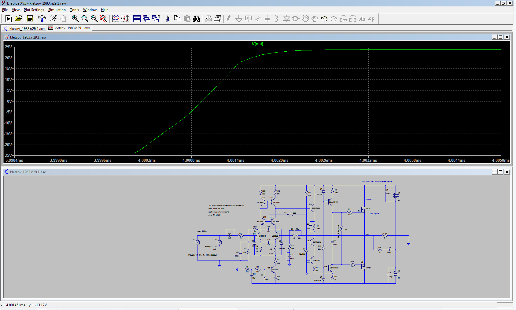

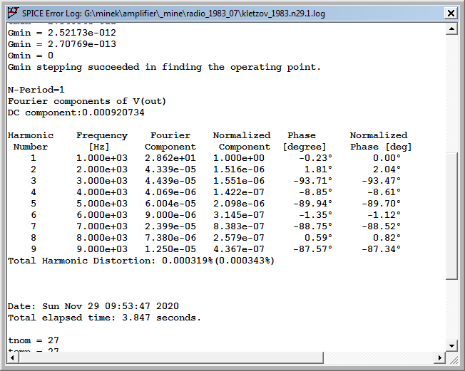

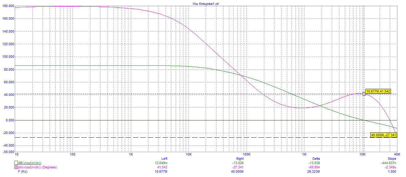

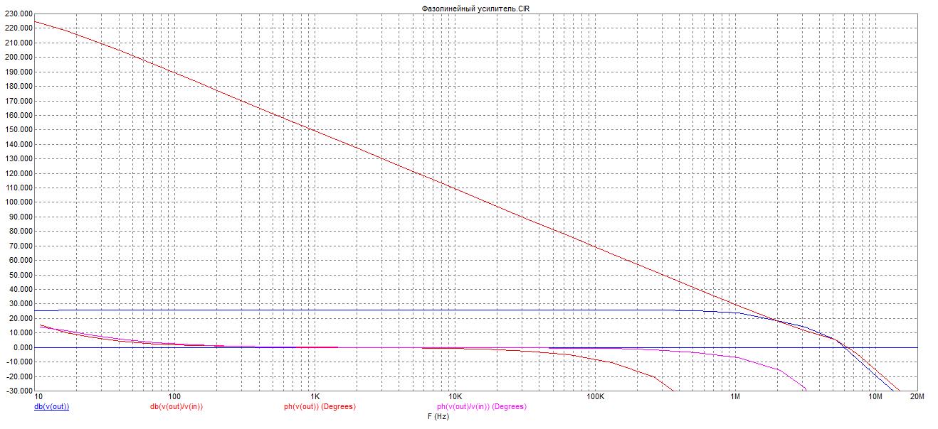

This is my latest results.
I also tried Jfet input - it looks like it's a drop-in replacement.
Sim attached (for both: BJT and JefFet input)
LSK170A/B work just fine, same results overall as with BJTs.
I checked my stash of Jfets - I have LSK170 grade D.
Unfortunately grade C and D does not work in this simulation.
I thought that since we have LTP coscoded here, this is great opportunity to use Jfets..
I also tried Revox voltage shifter with a resistor - bad idea.

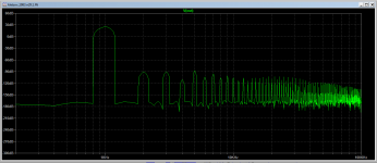

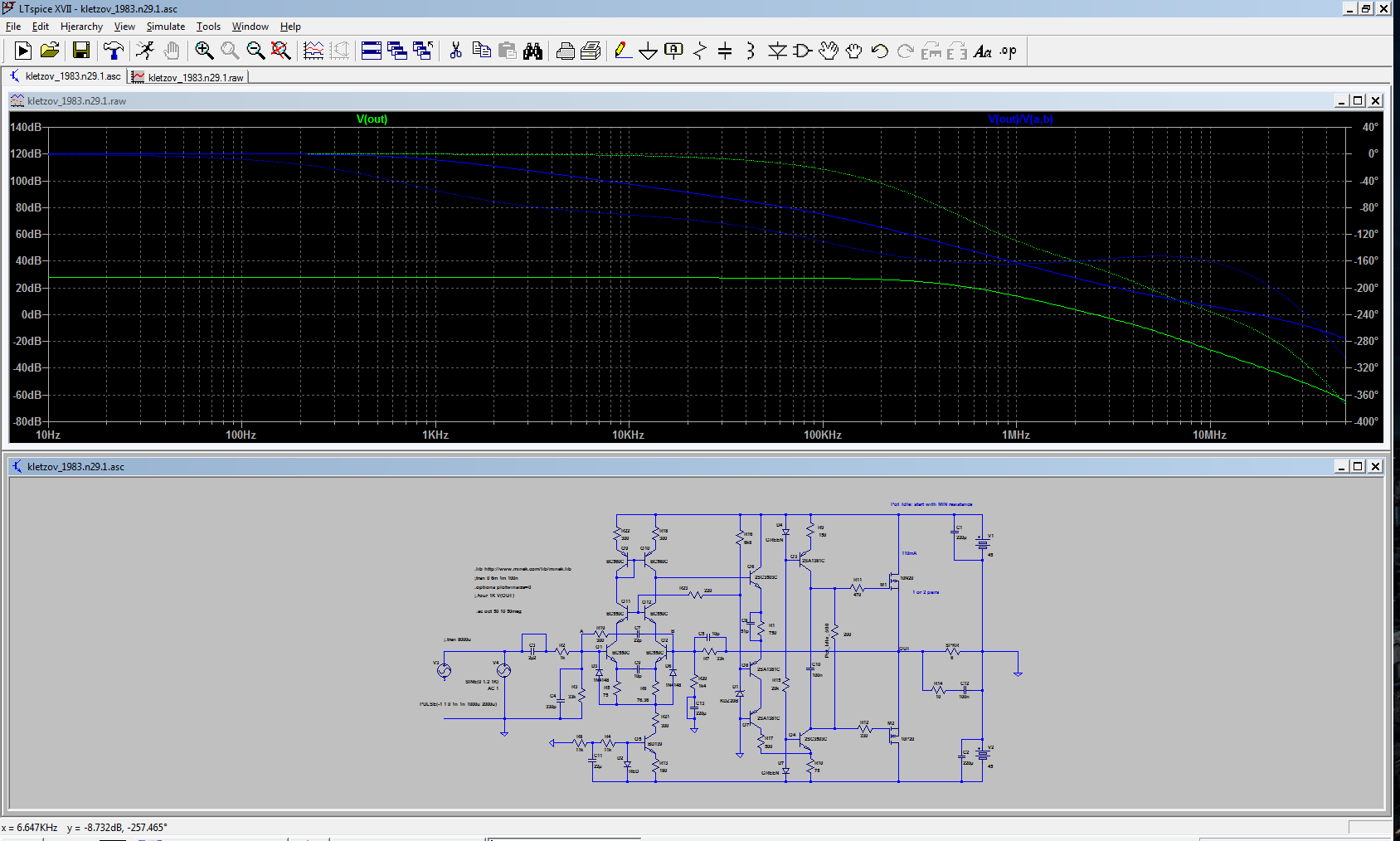

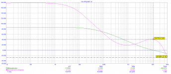

OK. Thanks Maxim!
Otherwise, everything else look OK?
Any idea why LSK170 Jfets grade C/D don't work, but grade A are OK?

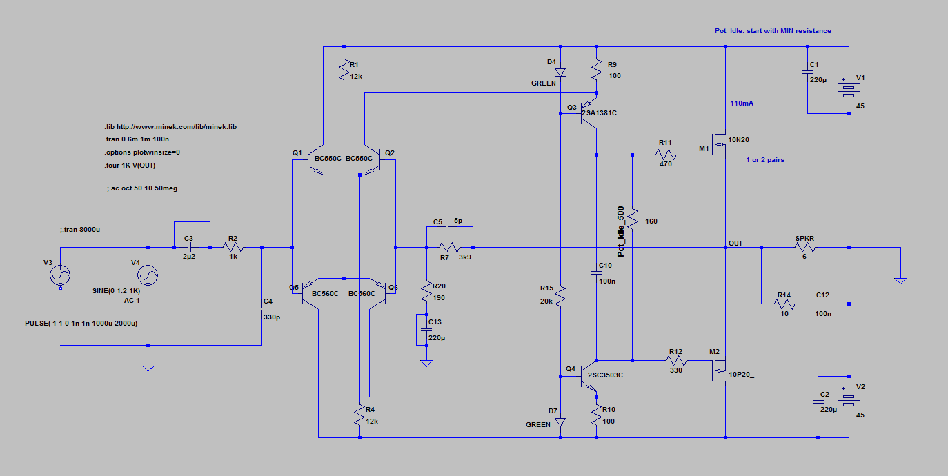

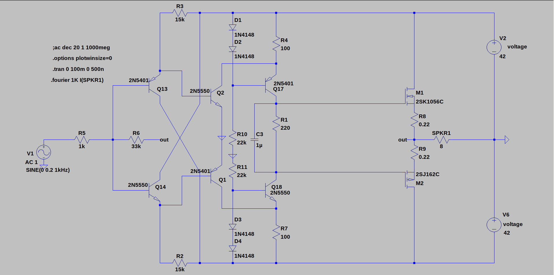

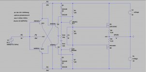

I went back to posts Hayk (kokoriantz) hinted about few days ago.
Eg. post #75
Here is the sim of it. It's simple, symmetrical (that's disputable if this is good or bad 🙂), perhaps something can be made of it?
What you think of it?
2 * CCS can be added on top and bottom of LTP, and maybe 2 buffers
between LTP and VAS?
As is, distortions are little bit too high, I guess, but it's simple.
Eg. post #75

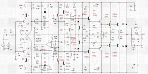

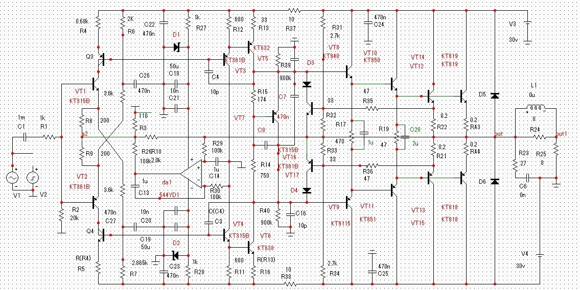

I have a similar circuit, an inverted amp, ~ 0,006 THD, but a little to high DC:
This is CFA ?
I guess not...
>A simple amplifier with a high slew rate voltage
This one is CFA amp!
That's why it needs servo... notorious DC offset issues.
